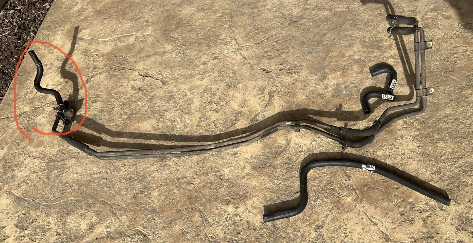

Hey folks. This is my 62 heater line. Gates 18453 will be perfect for the ones going into bottom of rear heater and I found that I can get both intermediate bends out of a single Gates 19038 as they’re both just a little different.
Does anyone know PN or replacement options for the hose circled? It’s the top one up against fire wall. TIA!!
Late to this one, but in case you still haven't sourced anything (and for the sake of anyone stumbling on this thread in the future), a Gates 18428 is listed as an alternative.
