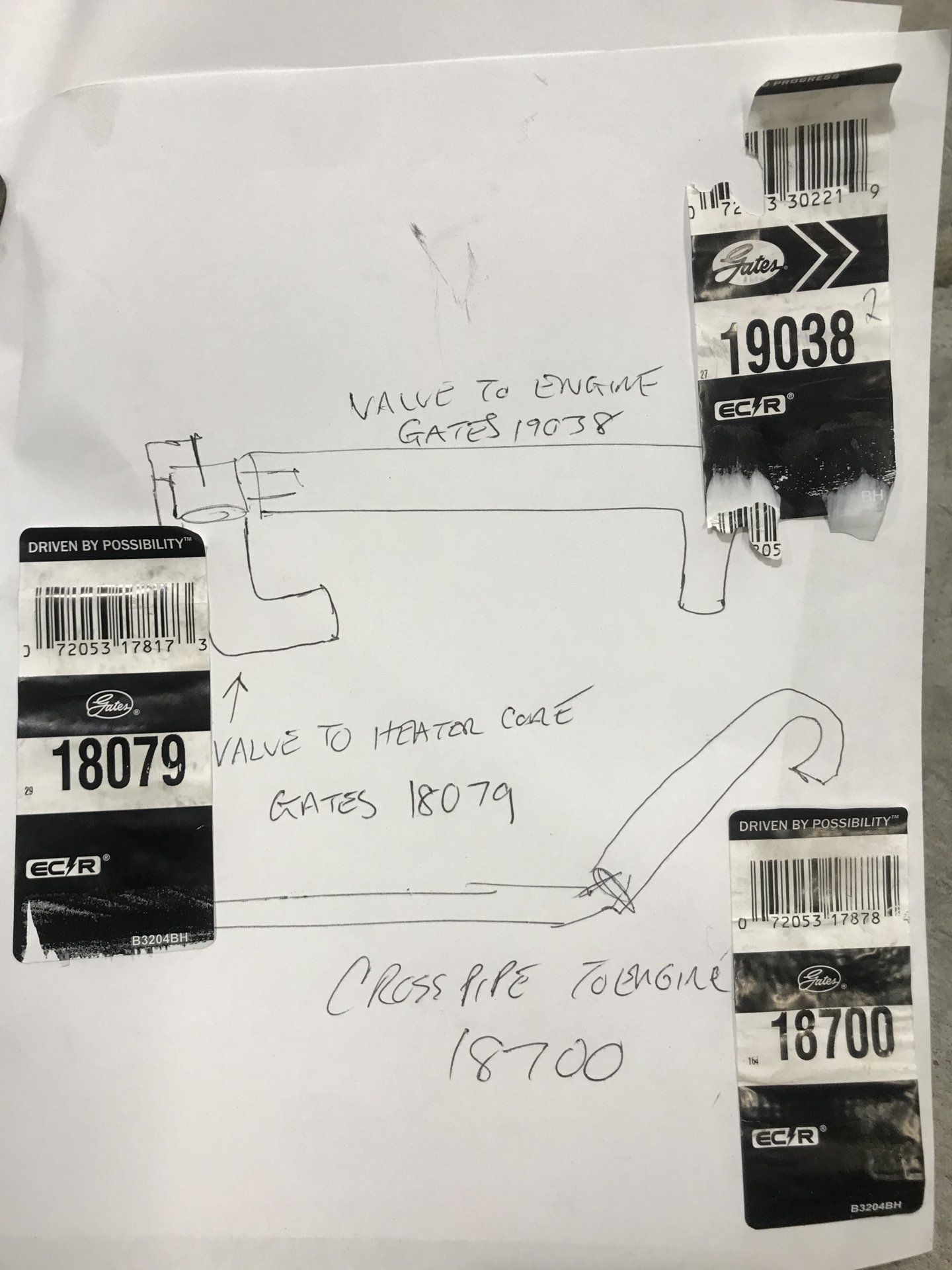

Found a good heater hose replacement for external heater
Jul 15, 2014
12
66
I found a good replacement heater hose for the external heater—the ones under the truck
gates # 18452
Nice work, thanks.
How did you find these?...cross ref. on the web, or digging through an auto parts store inventory?
I took the old ones down to o Reilly and just matched them up on the wall in the back room—-just found ones that were close—hope this will save some guys some time

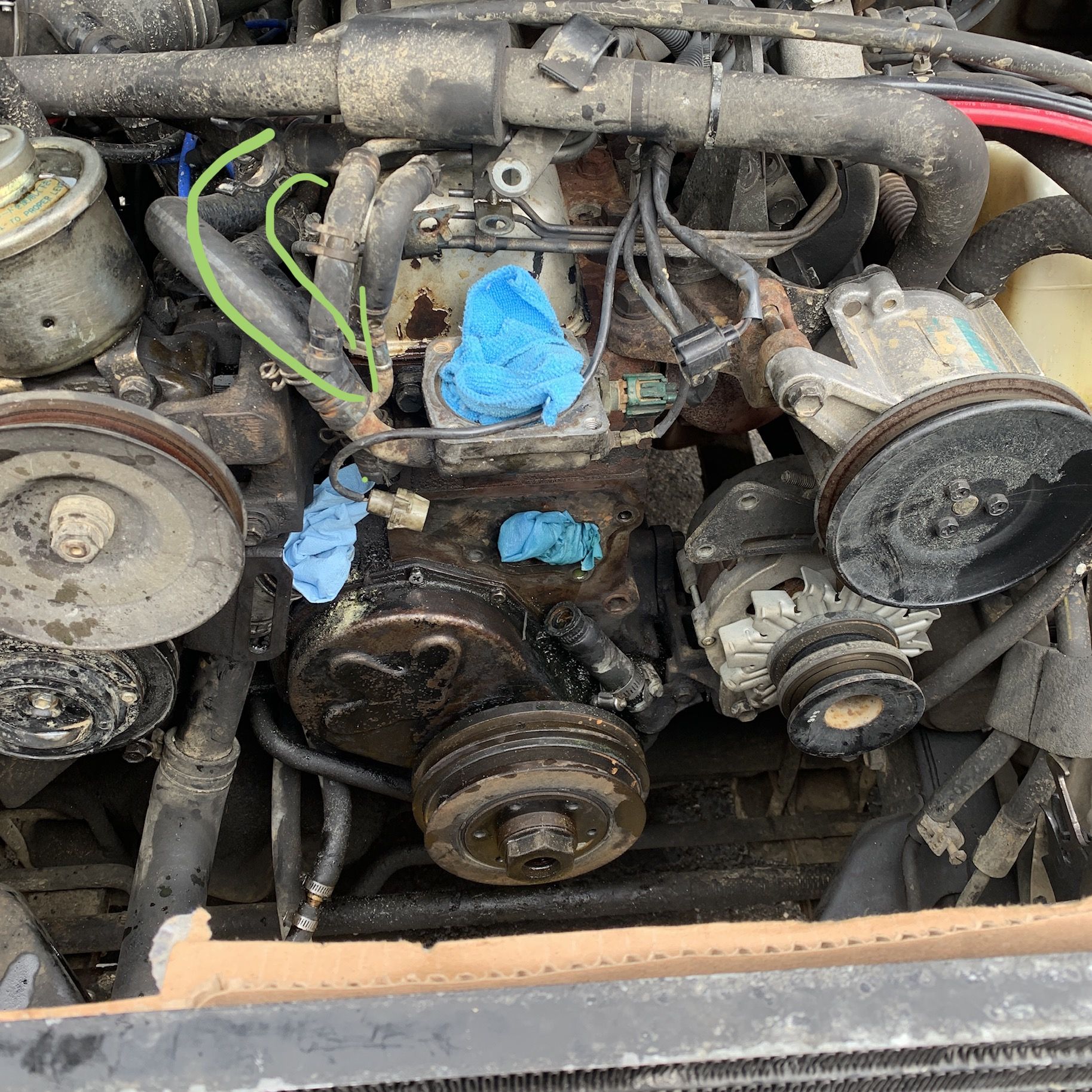

Look for the under car heater hoses and the ones highlighted in green. Firewall hoses would be a nice bonus. Toyota ideally if available.
The ones in green I haven’t found in any part number diagrams...really banging my head against the wall lol.

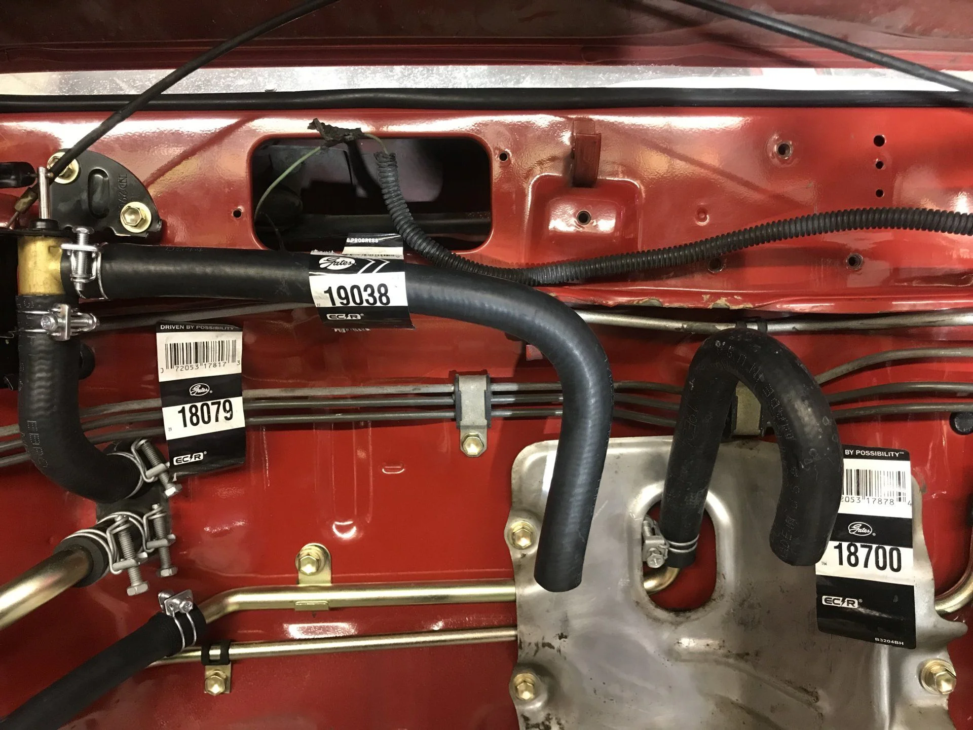

The diagram for a 62 shows more of a U with a flat bottom but looking at the truck gates 18453 should work great.
Hey folks. This is my 62 heater line. Gates 18453 will be perfect for the ones going into bottom of rear heater and I found that I can get both intermediate bends out of a single Gates 19038 as they’re both just a little different.

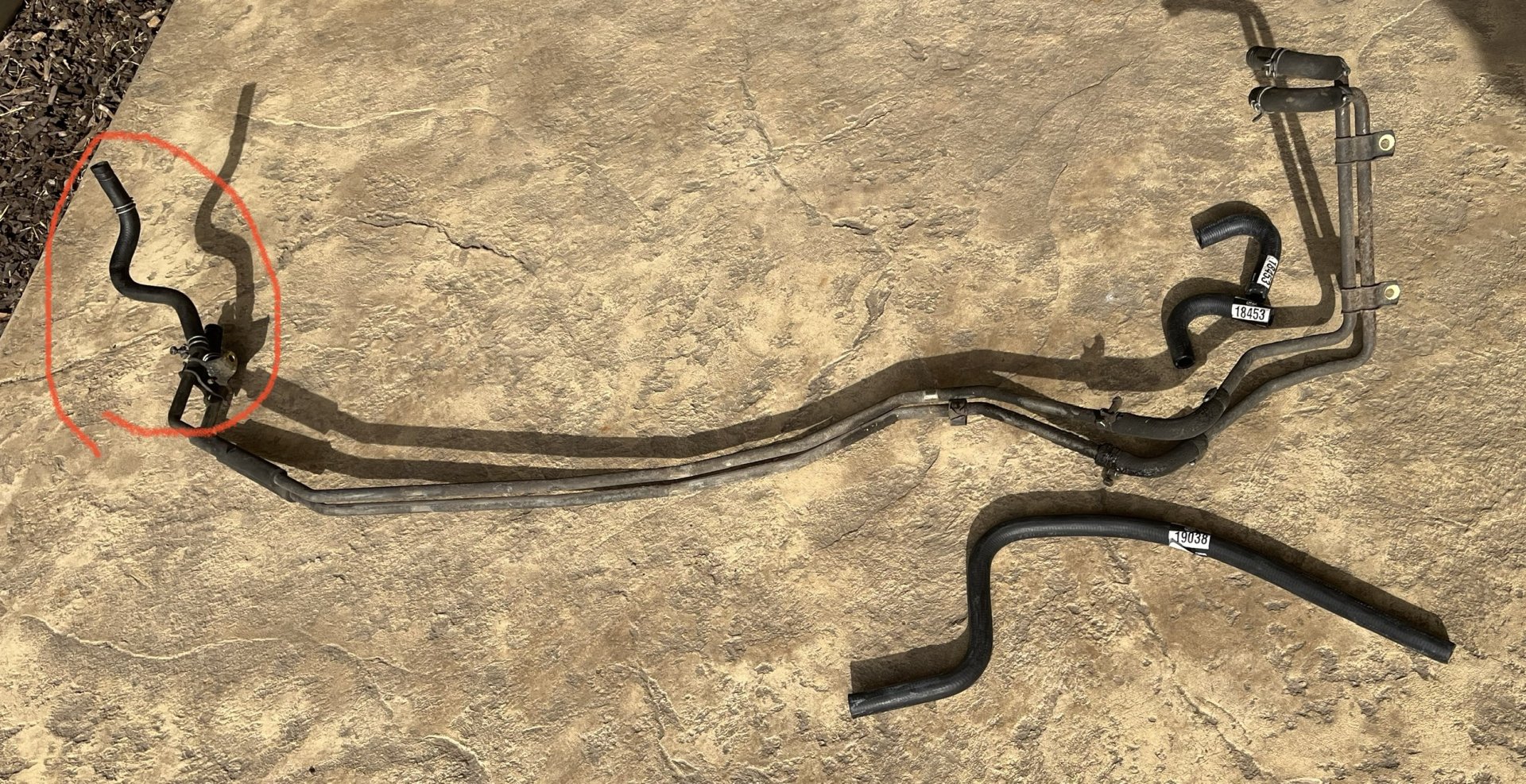

Does anyone know PN or replacement options for the hose circled? It’s the top one up against fire wall. TIA!!
