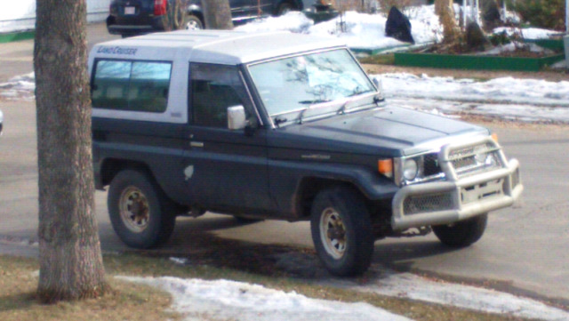

It will be for sale again.... at my estate auction... after my mysterious disappearance and officials have declared me "Deceased"
cough up the pictures!
...as it sits await a clutch and generous donation from my collection of 70Series parts...
