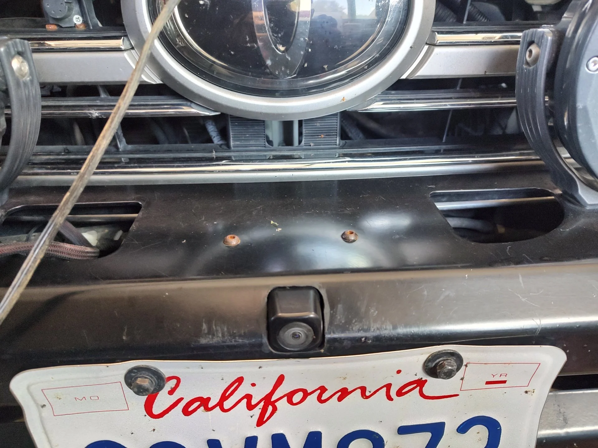

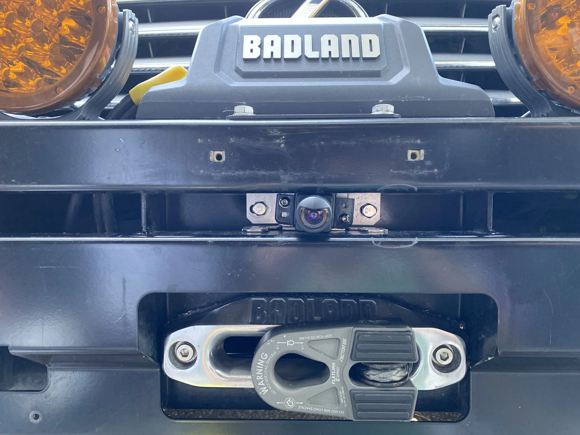

I ended up using the ARB relocation kit and moved my camera to below the license plate. When I install a winch I will probably make a mount to put it where the ARB bumper relocated the camera. I don’t love that spot but haven’t found a better one yet.

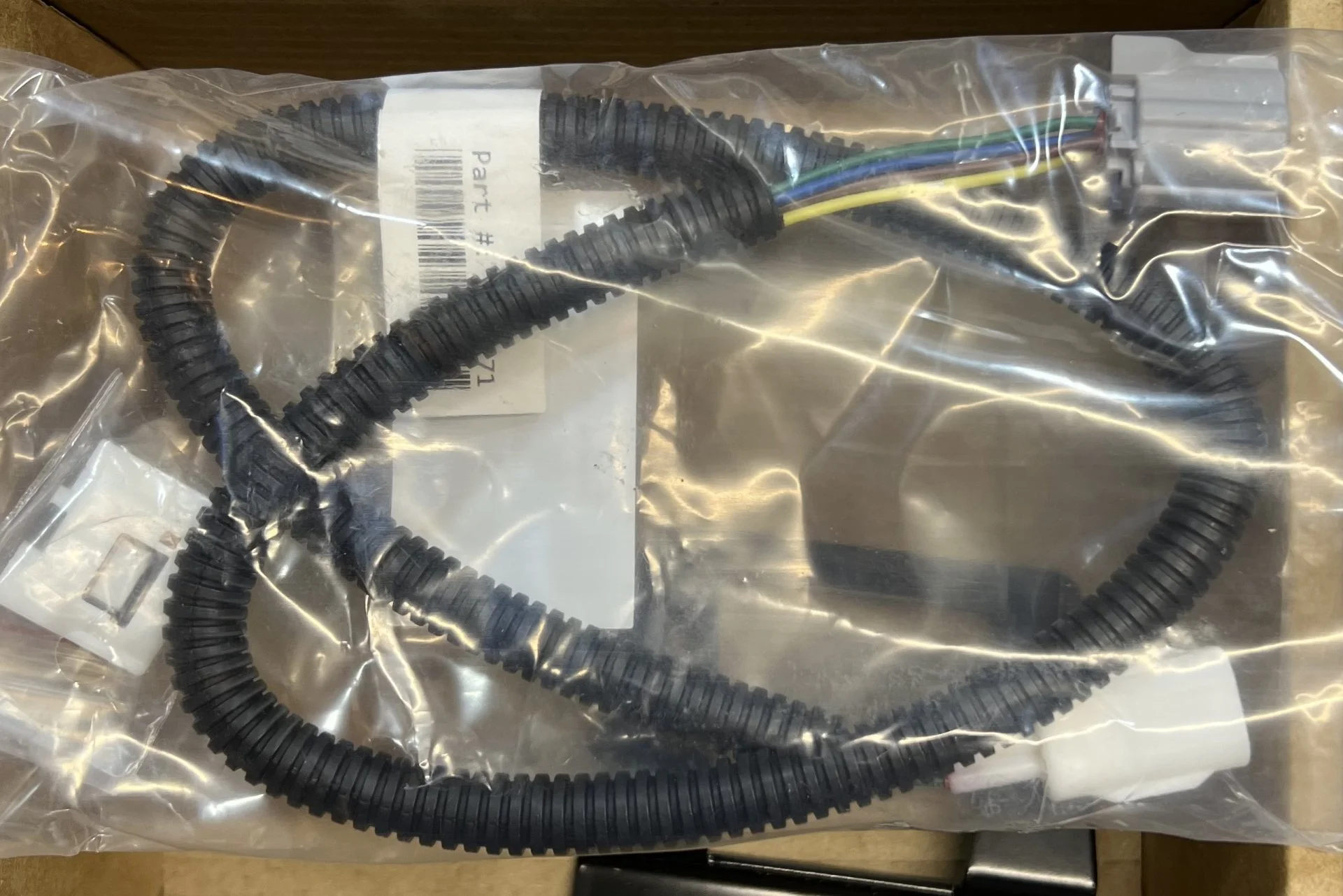

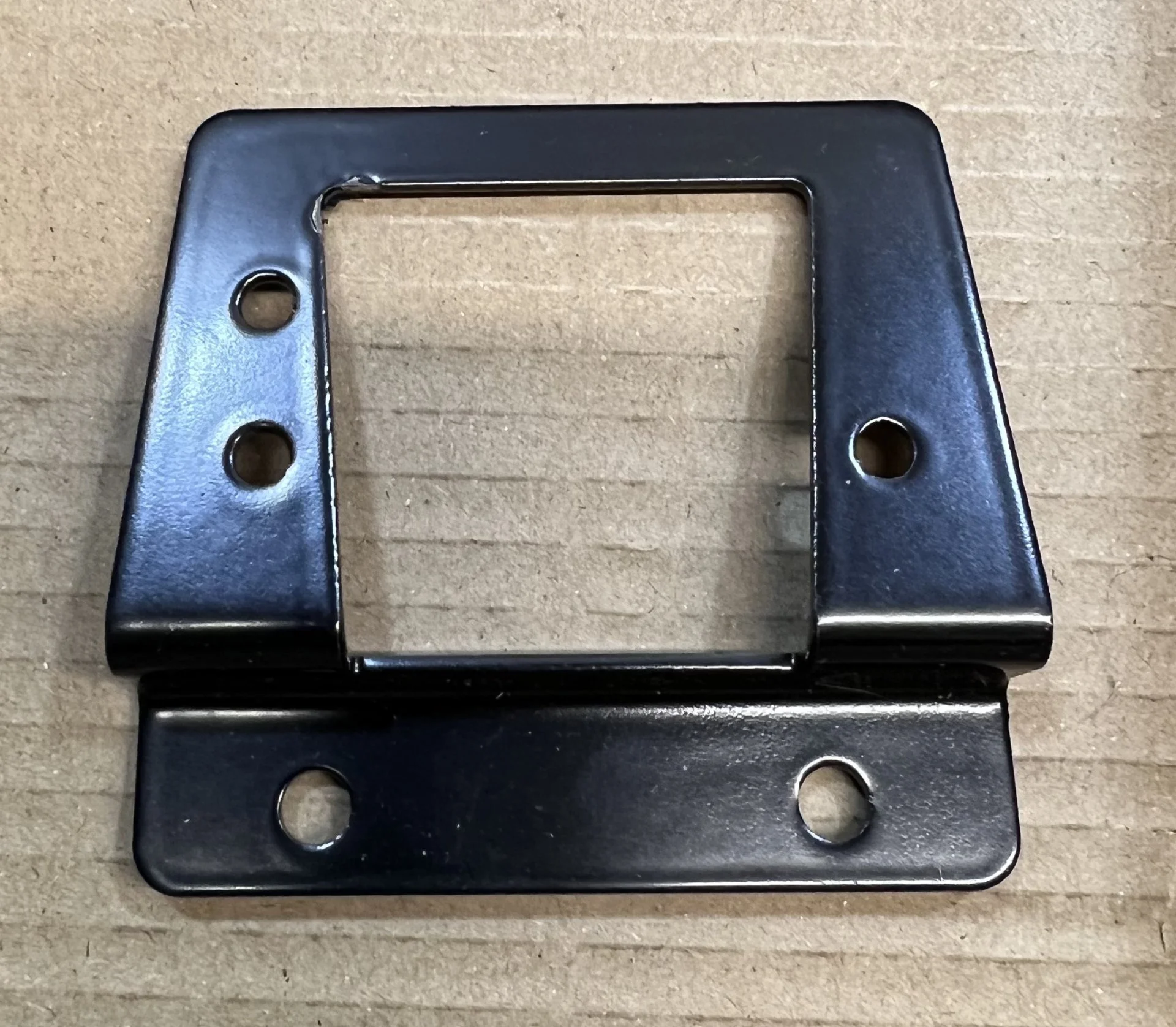

I got mine from Cruiser Outfitters too, but haven't gotten around to installing it so thought I'd post some pictures, in case it is helpful.
Here's what's in the kit:
I cut a hole and made a bracket to hold the camera. Stock cable reached, no extension needed. This is on a 2017View attachment 3002748

Do you have good visibility right in front of the vehicle? I'm interested in using mine offroad to see better right in front of me when in 4lo.
I think this is the route I'm going to go with mine.
The camera has stock vision, I don't notice any difference. It's probably 5-6 inches forward and a couple lower.
