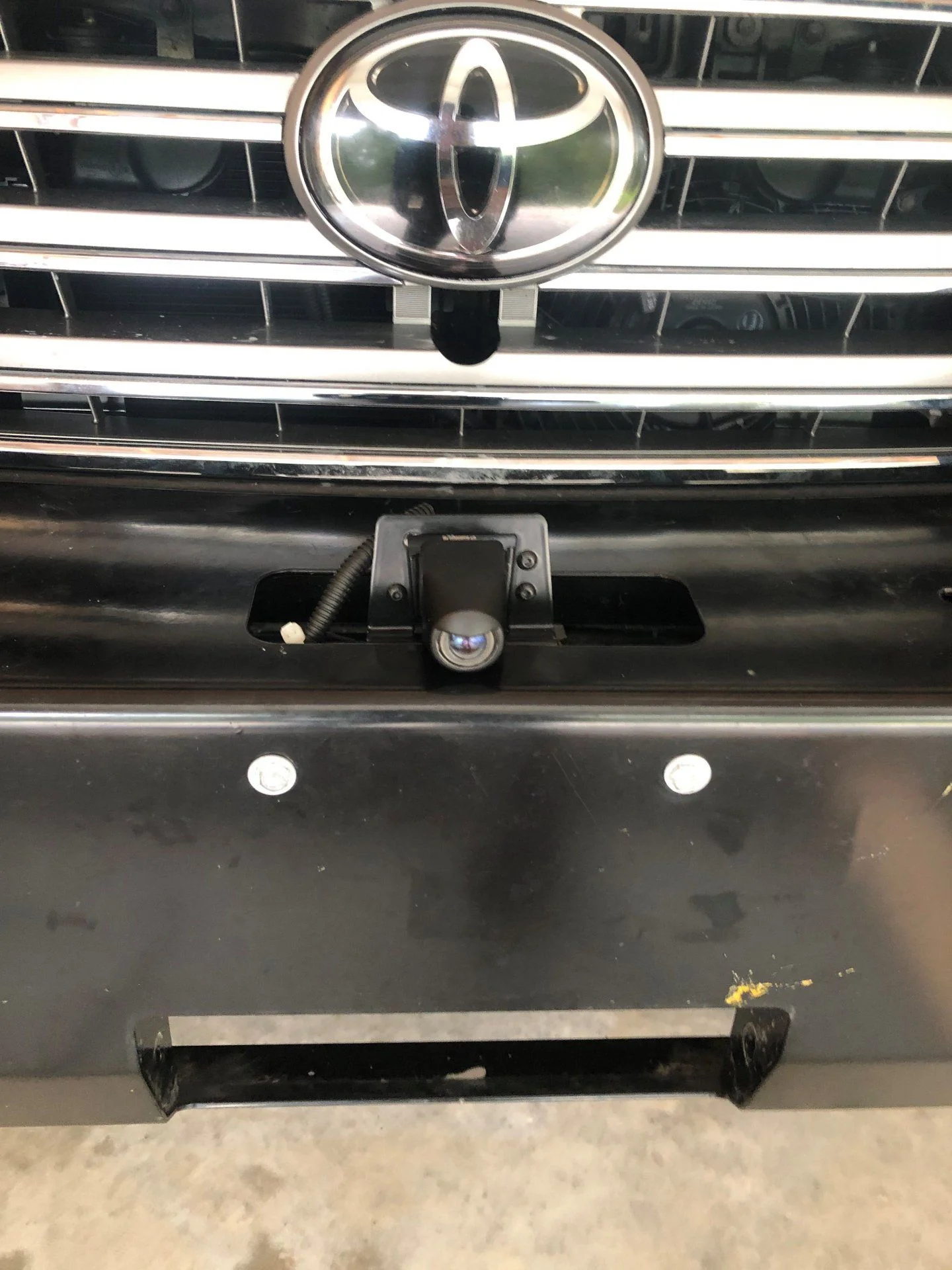

Been working on relocating my front camera. With the T13 and camera in stock location, the frot camera was basically useless unless I wanted to know if anything was just sitting on my bumper.
I played with different locations including a couple under the truck that provided views that showed the front tires that maybe could be useful in allowing the driver to see the front tire placement on a rock or something but probably would not be practical from a mud or potential damage perspective.
I ended up making a bracket out of slotted angle and mounting it in the winch control box hole on top of the bumper. I think I’ll still be able to add a future winch with a remote control box.
I used an ARB front camera relo kit for the wiring extension. That was pretty easy but you still have to pull the four wire pins out of the OEM connector and replace it with the ARB connector. For $60 I was expecting plug and play. Just splicing the wires would certainly be cheaper and not
that much harder.
Next is to design a cover for the camera that can be 3D printed and fab a better mounting bracket.

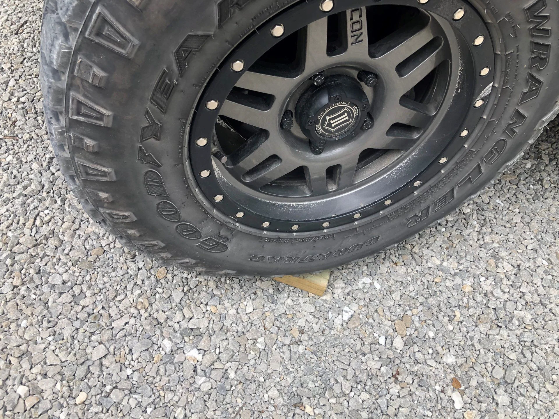

The projected tire path graphics line up pretty well. Here is a video of me using the camera to guide me in placing my drivers side front tire on a piece of 2x6.

Do you already have your bumper on? The 16+ T13 bumper is much shallower than the 08-15 bumper. Really no need for a camera relocate. The bumper only sticks out 4.5” from grill. I’ve had it on a few 200s and can see fine. The ARB sticks out like 10”, so there’s a relocate kit for those.
I have it on but also have 7" ARB lights. It's not bad but thought for $60 and some fabbing I could get it back to clear view. However I'm curious about the compensation in the view from the new location. Sorry for my ignorance...The camera is only for imagining right? It isn't used in helping calculate radar cruiser or lane keep assist, right? How about the satelite view is it affected if the camera is moved? Stoked on the bumper but man they could have at least ID'ed all the hardware.
For <2016 the camera is only for the image. It isn't part of the radar cruise control or collision avoidance system. I think that is the case for >2016 but don't know for sure. Maybe try unplugging the front camera or taping over it and see what happens is someone here can't confirm.
