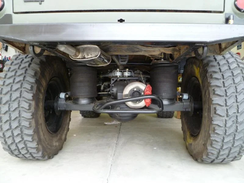

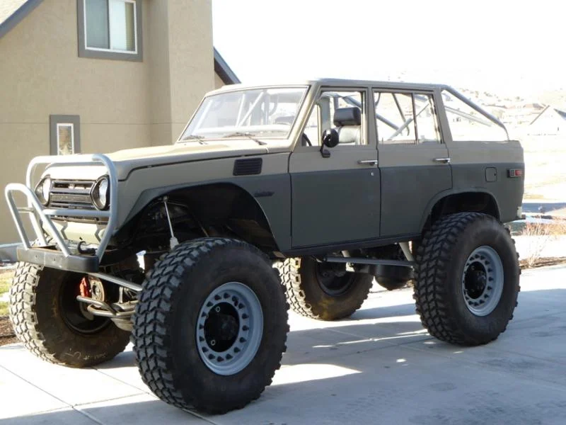

Hey everyone, thanks for all your comments and thoughts. I have been out of town for a few weeks and have been out of touch.
I have attached a few pictures. I still haven't had time to tear into the valves and delivery system yet but hope to soon. I have done a bit of research and I am excited to see where this goes.

WTF size are those tires?
Chop Shop, you are correct sir. Very good!

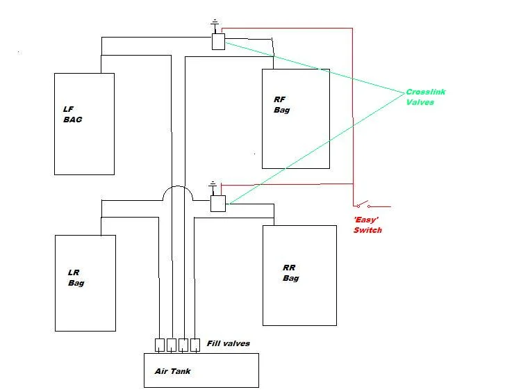

If you don't want to mess with a fancy controler, I still say the linked bag idea would provide easier articulation. This is an overly simple diagram, and doesn't include you're exhaust valves, but they would be no different than now. When the "easy" switch is off, the valves are closed, no connection between the bags. It acts just like it's on coils. Push the 'easy' button and the air will flow from one bag to another without having to compress the bag and will therefore make it articulate easier.
Keep in mind, If you are on a sidehill and you hit the "Easy" button in the above diagram, it will empty the downhill bags and fill the uphill bags..
That is a reasonably simple and clean setup tho :)
Yep, on a steep sidehill the easy button might become an over easy button. One thing that would help limit that (besides not hitting the button when you're on a side hill :) ) - is putting a restriction in the line - perhaps a needle valve. If you had a really big line connecting the two bags w/ a really big valve, it would be real easy to rock the truck side to side cause it'd be real easy for the air to flow from bag to bag. If you put the needle valve (or an orifice, but that wouldn't be adjustable) in the line, you could slow the rate of transfer and slow down the effect.
The other option, would be to link the front left to the right rear in the same manner. I'm not quite sure which would work better in the real world, but would love to try both.
The other other passive option, is link all 4 bags together. I think that could get really uncontrolable though, but again, would love to try.
