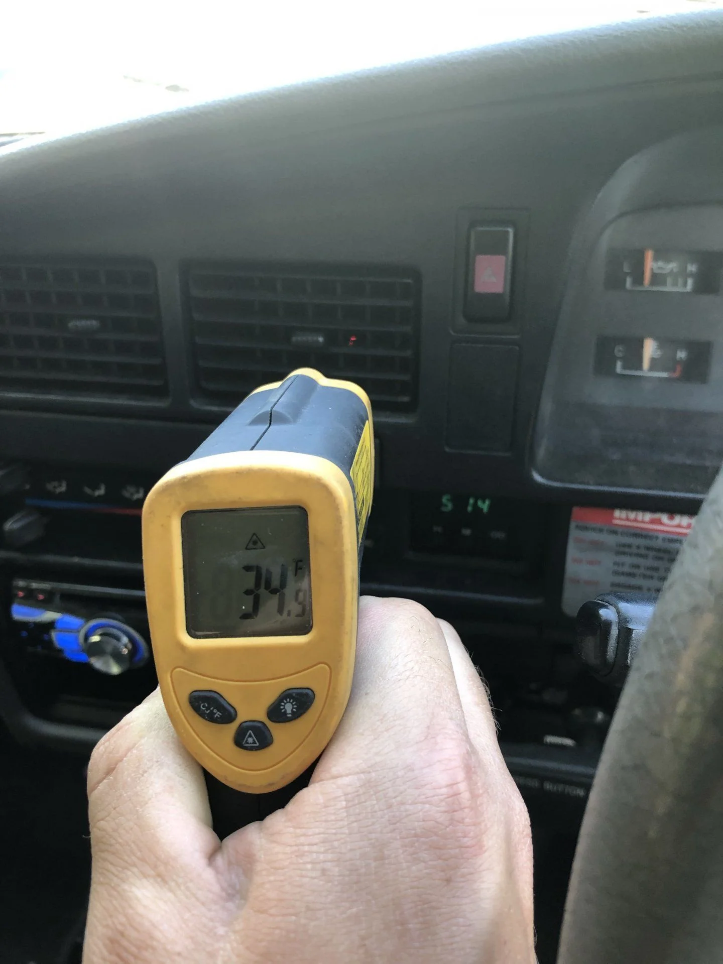

I can somehow get to 34 deg in my (r12 converted to r13a) 1990 with recirc on. Was about 100 out when I checked
FWIW - the instructions with my IR temp gun said to never use it to measure moving air, and thy included a dial-type probe thermometer for checking things like A/C output. Obviously, an IR thermometer call measure the plastic temperature, but my IR temp guns readings are definitely affected by moving air (such as the engine fan).
Thread content: With a proper R12 charge, my '89 FJ62 read 44F on a 90 degree day.
Oh definitely, I just figured the plastic duct can only get as cold as the air passing through it. But maybe take that measurement with a grain of salt given it seems to be an outlier?
