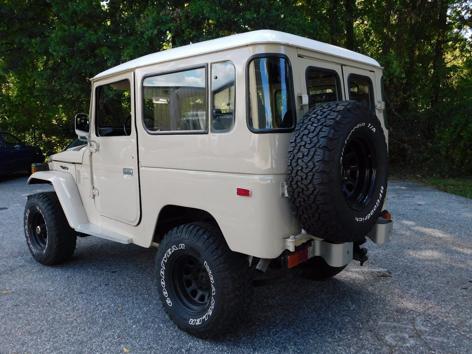

Since this isn't the for-sale forum, I'll venture that you are looking for some feedback...
Looks like a decent truck, but money put into a vehicle does not equal money back out. You probably didn't get the best deal on this thing.

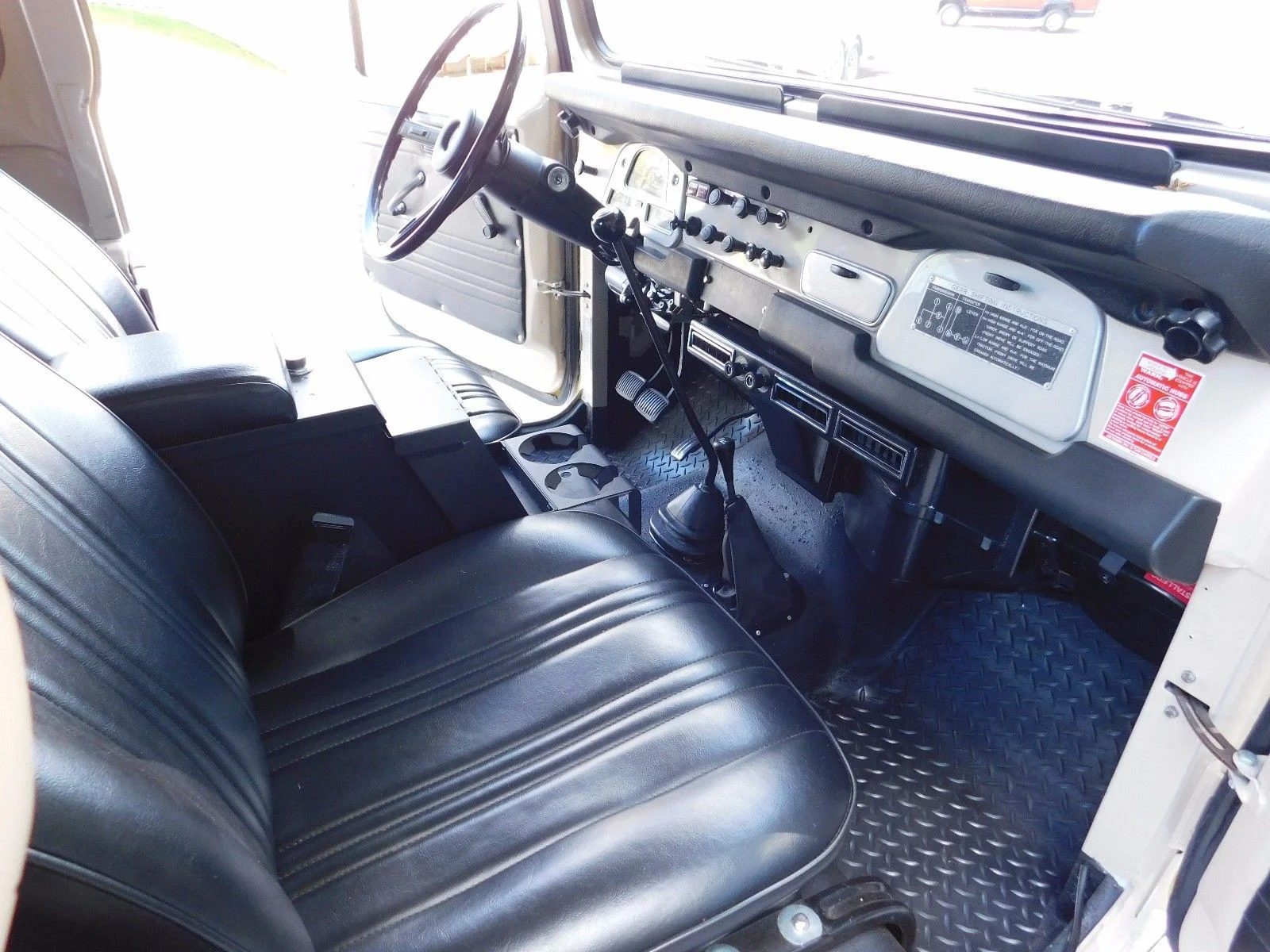

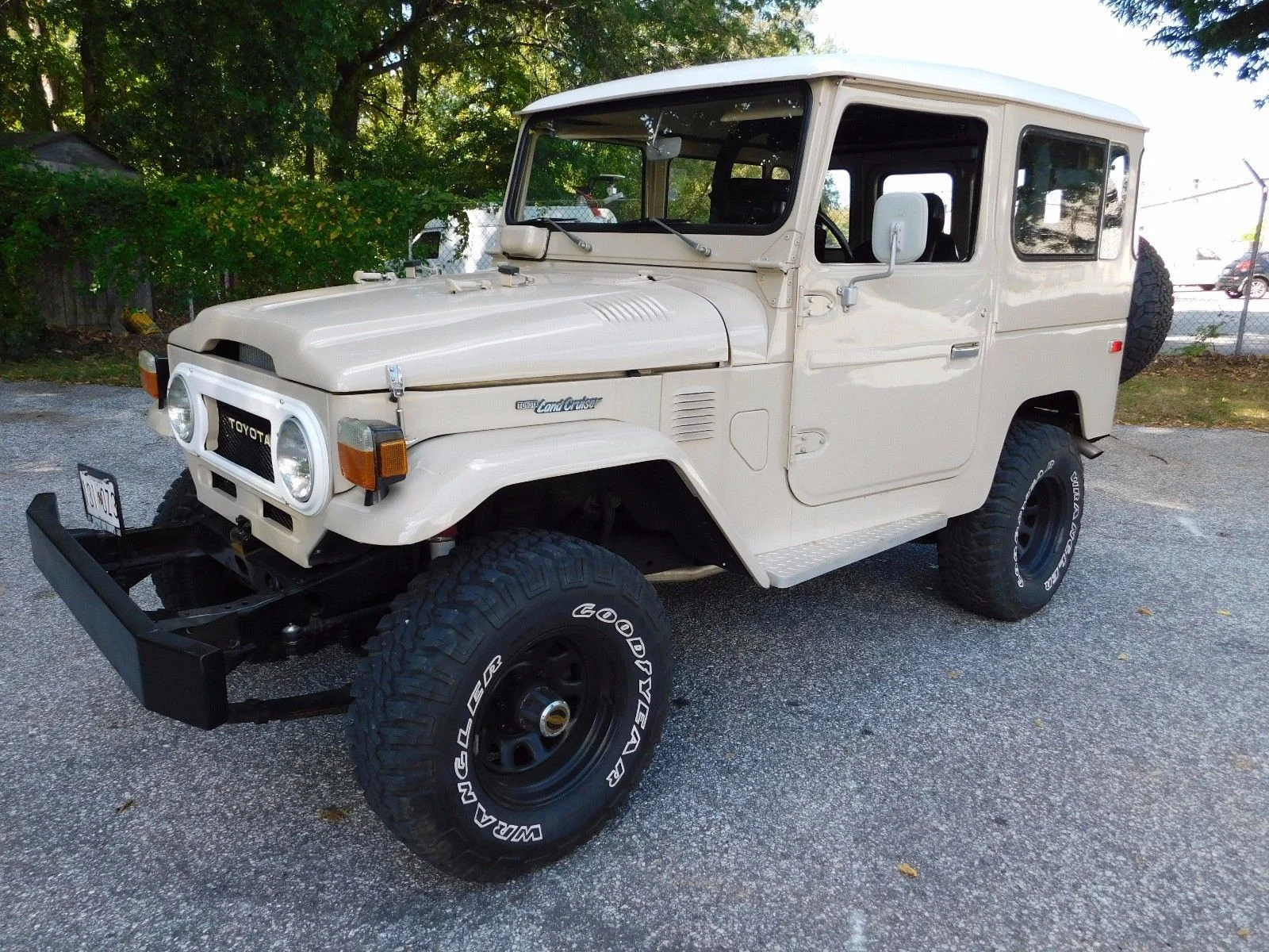

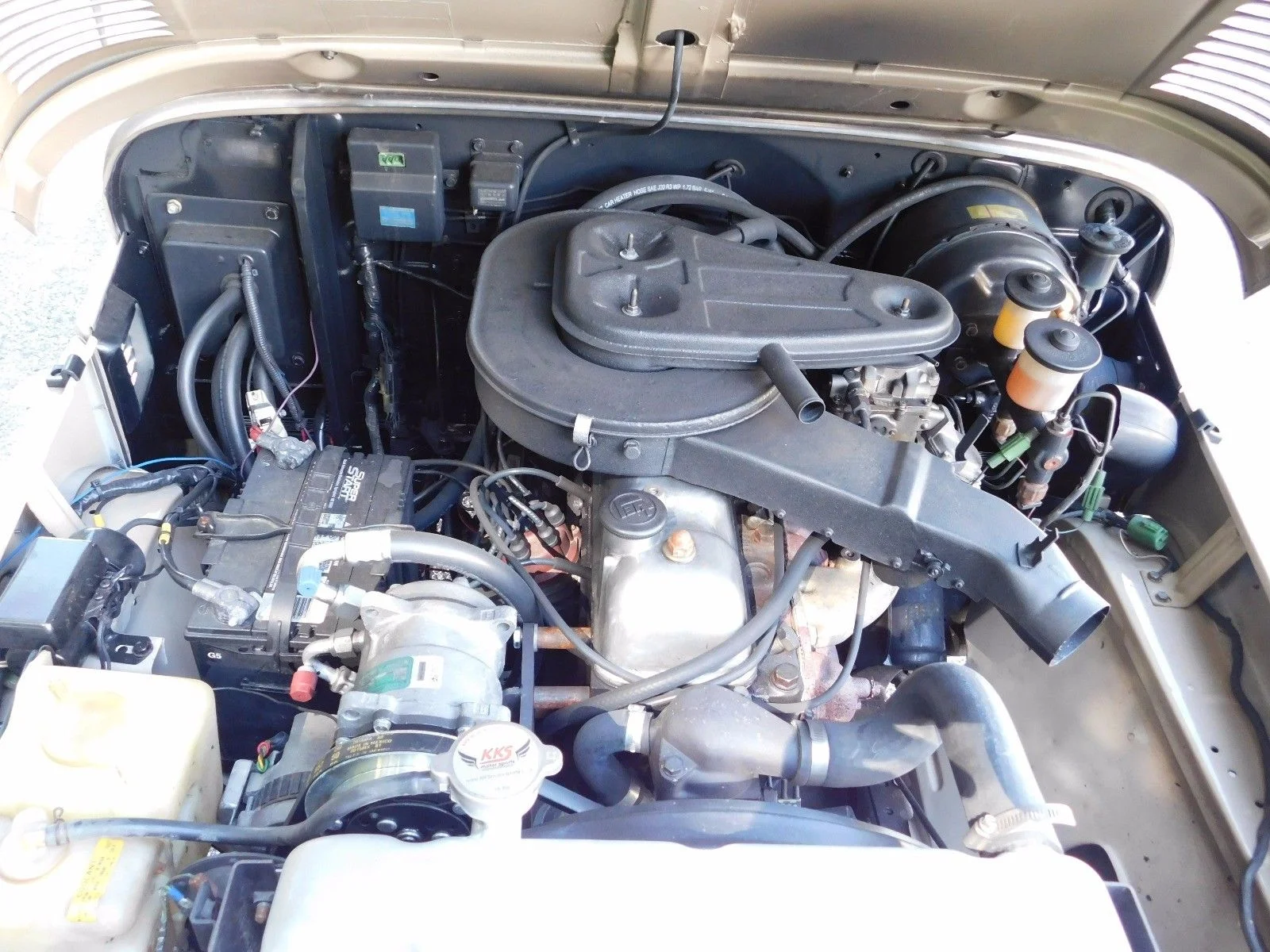

This is not a $35k truck. From the bent/leaning driver's seat to the ugly wheels it screams $15 -20k tops to me. Spend the $5 to buy a cap for the tube coming off of the air cleaner and hit up SOR for the front half of the air cleaner to make it look like you at least tried!
Invest in some factory steel wheels with tall skinny tires and a nice stock bumper and you'll stand a chance of coming closer to that number...
Andy
Thanks Andy. Helpful.
I actually like the way it looks. The truck runs great - and the engine and mechanics are solid. Based on some other feedback, I've already ordered the cap and will be making some of those improvements.

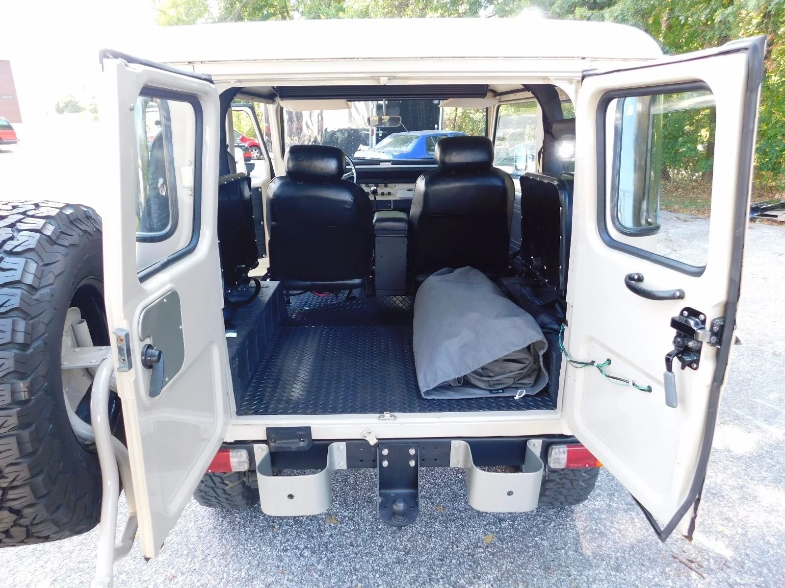

rear door fitment seems too low.
weather strip coming off PS rear door.
interior paint not matching body color.
firewall paint not matching body color.
the crappy dime a dozen hose clamps, the wrong sized one on the upper rad hose
lack of caps on spare tire carrier tubes.
windshield hood rest pad brackets installed backwards
windshield hood hold down latches installed backwards, with none oem pockets for hook end on hood.
windshield wiper motor cover installed upside down.
incorrect rear jump seats for year..should have the fold down leg, not the rubber bumper.
hard top not disassembled for painting, drip edge on cap is body color, not white.
gasket between hardtop sides and cap appears to have been not replaced and is falling apart.
not seeing a "full restoration". seeing a truck that was in decent shape getting an exterior only paint job.

  • Details on the desmog - what was done to it (carb, distributor, vacuum routing, etc)
