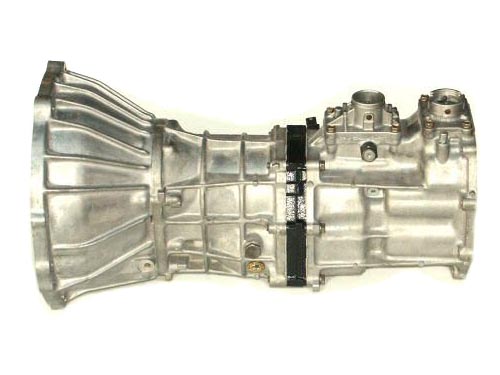

I have an 84 4 runner with the old 5 speed
I have been through 25 seals including the ones from toyota............none fit
I need it for the rear output of the tranny where the transfer mounts to the tranny(currently where the marlin box bolts up).
I have a set of numbers off the OE seal(koyo)
just as it is on the seal all the way around
koyo-cr MHSA32 52 8-1 SPACE SPACE 14
What part number are you getting from Toyota? I find 90311-32009 when I look it up in my EPC, which happens to be the same as the W56.
