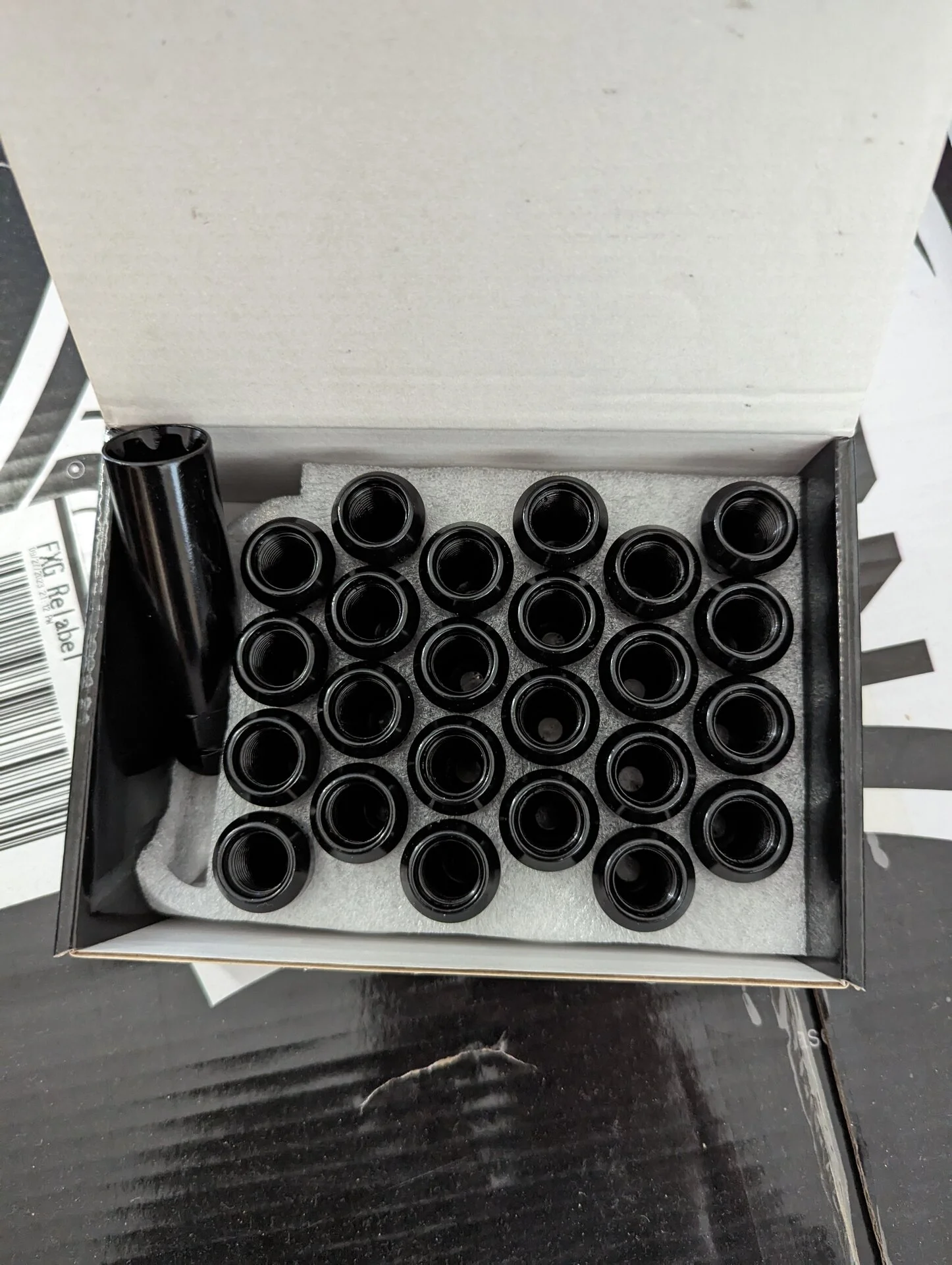

What lug nuts do these wheels take? I only have the photos to go off of, and doesn’t look like these are flanged lug nut wheels, looks like they’ll require the acorn style ones. Just curious if anyone running these wheels has any intel on the lug nuts they’ve got.
Their website says 60° taper acorn style, and the cruiser is M14x1.5 thread.
I ordered these lug nuts for my Icons but haven't installed them yet.
