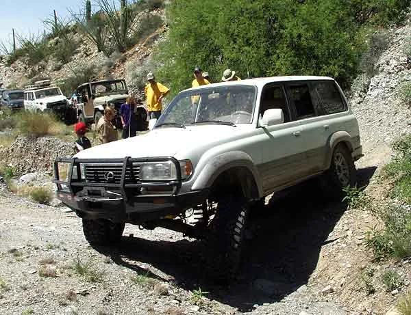

I've had the opportunity to follow Frankie out of a trail system when I met him. I have never seen an 80 behave as his did, it flexed when needed and stayed perfectly stable (level), something my J's do not do. I sway like the dickens, and Avocado has Slee 6" heavy's (extremely heavies IIRC) and his did not flex nearly as much as I would have thought. i drove and watched his last weekend. Dan had an extreme amount of weight in the back of his rig too... couple hundred pounds I'd say easily.... 5 bags of 50lb fertilizer to boot on top of all other gear.

Due to the front arms my junk flexes pretty well, it hits the trail as often as possible and most trails around here deal with rock, so it's fully flexed often. The lift still measures the same as it did just after settling. Other than the arms, brother Rob's rig mirrors mine and his hasn't sagged at all ether, both sets of springs installed on the same day.
