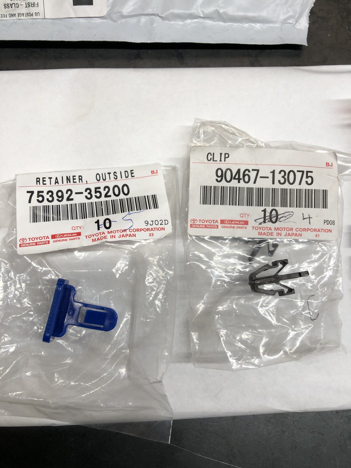

Hey Ken,
Will need to know exactly which clips. There are a zillion... Old thread and I can’t remember. It’s amazing how many funky clips there are all over the truck.
The ones on the plastic cover that go over the radiator
The 90467-07217 are what held the plastic cover over the radiator. The other larger black ones are inside the grille and hold the bumper skin down (incidentally, I think this is the same fastener that holds the tow hitch cover on from below and holds the rear bumper skin inside the sides of the rear hatch).
So the cover at the top that are front and upward facing when you open the engine bay?
If that’s what you mean...I’ll look.
How many do you need?
Thats it. Charlie posted the part number above and I already ordered them. Thanks for the response
