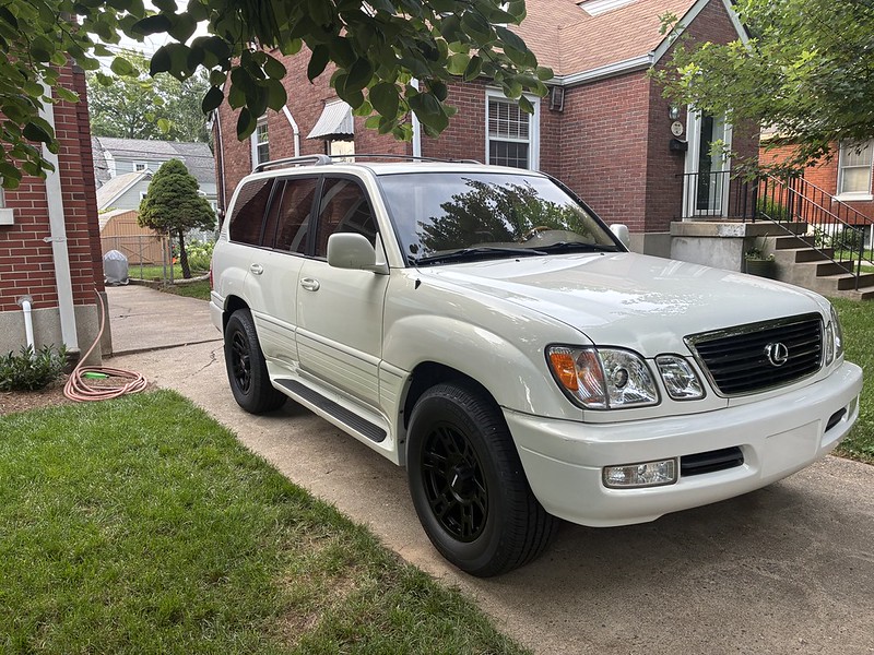

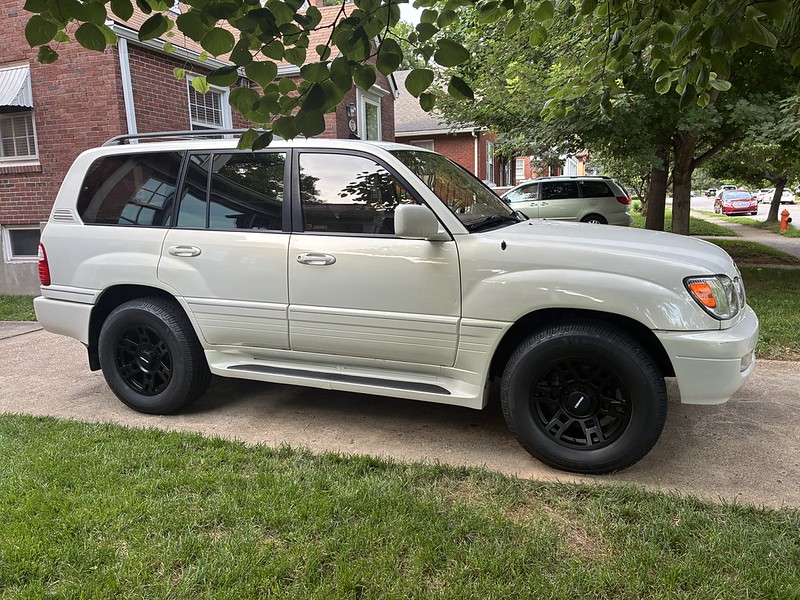

Thanks for the help today. A little dremel took the 20 years of grime off and they fit. Very snug.
Here’s the new look. I’m super stoked!

You're very welcome. I was happy to help, and I'm glad to hear that you're stoked with the wheels!
Your Land Cruiser looks fantastic, and it's a great example of how well the matte gunmetal Five Star flow formed wheels pair with the grey trim. Thank you for posting, and thank you again for your order. I truly appreciate your business.
