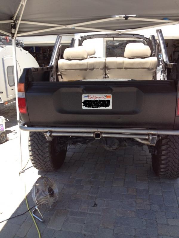

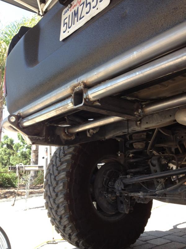

Got a chance to work at my buddies shop again yesterday. We tackled a new rear bumber first and then started bending tube for the cage. Here's a few pics of the bumper.
More pics:
After welding everything up, I noticed there was a little too much heat. It caused the tube to sag a little. This will get fixed later when I tie in the rear quarter protection. I want to get the cage done next so I can get out and wheel again.
Nice bumper, that's similar to how I want to build mine (very minimalist). Is that 1.5" tubing? do you think it will be able to take the full weight of the truck without deflecting into the body?

The main tube is 2" x .120 DOM and the hitch receiver support tube is the 1.5". I too, wanted the minimalistic bumper, high clearance and light weight, but strong enough to pull my offroad tear drop trailer.
once you are all welded up on that rear bumper I bet you can get those corners to straighten out a bit using some ratchet straps hooked to the cage or a high lift?
