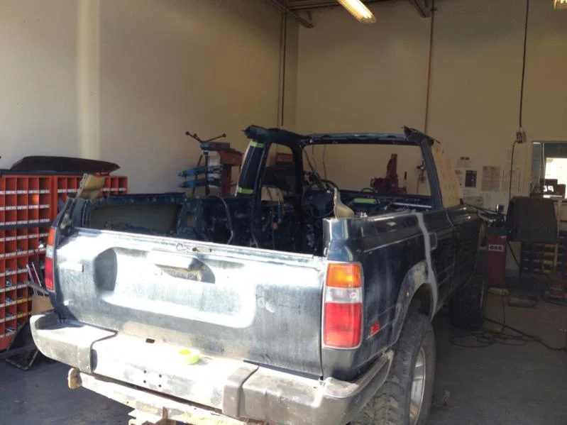

Did you weld the fender lip after folding?
No welding. I trimmed back the inner fender well about 3/4" and hammered up each tab. I then drilled and riveted each tab to the inner fender well. While I was doing the bondo work on the DS fender, I mixed extra to fill in the notches and sharp edges on these tabs. When I spray the liner on the doors and fenders, I will hit the fender wells as well.

Thanks Roger! I don't have any pics yet. I trimmed the outer edge of the inner fender where the outer fender lip bolted to it with the 10mm bolts. I trimmed it back with a cutting wheel about 3/4". The outer fender tabs that were created when I notched it 1" O.C., were folded in (hammered in :hillbilly:). These tabs overlapped the inner fender well so I drilled and riveted. I did this to retain as much strength as possible on the outer fender edge. I have seen many people trim their fender wells and remove the inner fender all together, but this sheet metal is so thin that it even dents when you look at it.

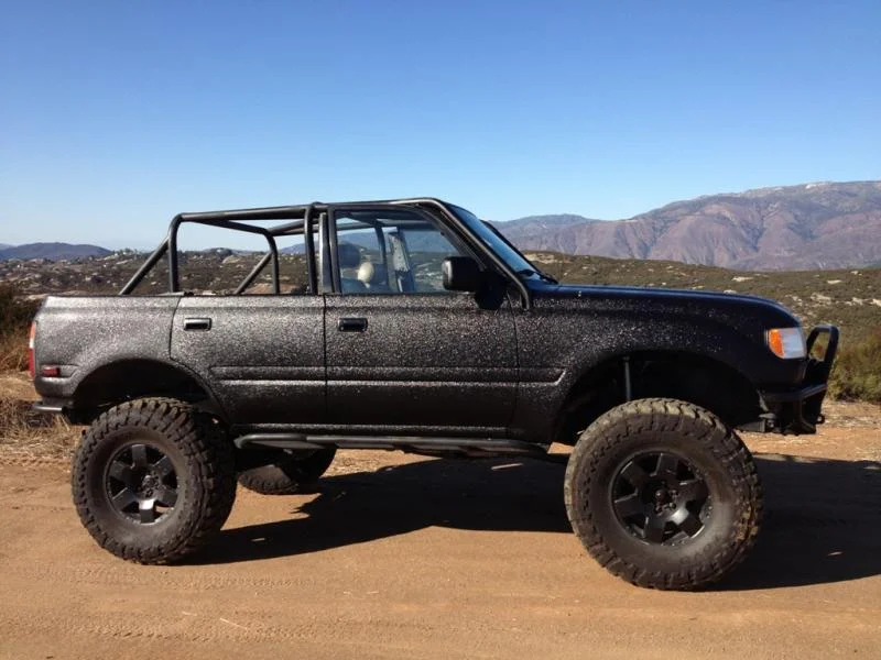

After taking a few weeks off. I got back into the swing of things. I fninshed the DS fender trimming and took some better pictures of the steps I took. These show how I riveted the tabs to the inner fender well.
....and More Al's Liner
I also had time this weekend to put the second row doors back on and finish spraying the Al's Liner on the rig.
A few more...
More pics. And now I can get back to more tube work.

And like that, I now have a new favorite rig. Bravo.
Yeah, lots of rivets, but it's that attention to detail that makes your rig stand out. Bravo ! What is your plan for a spare tire location, and are you making a soft top for it ? Very cool !:cool:
Looking good!! I like the look of the whole thing! Doing a damn good job!!
