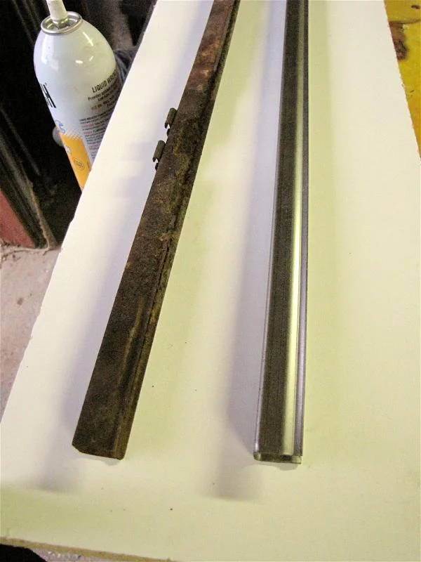

Thanks Bob, I just got my rocker panels, scuff plates, and tailgate window channel. You can't completely appreciate those rockers from looking at the photos, you have to hold one in your hands, and I mean both hands. They are heavy! Unbelievably stout! All I need now is an instructional video on how to properly install them.
Mudders, check out Bob's fabricated window channel for the rear tailgate glass. Perfect! I can't be the only one who's channel is completely rusted.
Thanks again Bob, Mark

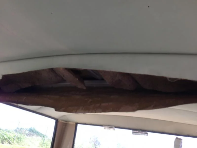

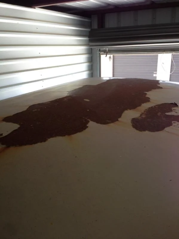

A question for the metal maestros (oddly, my income derives from steel, yet I can't determine)
The roof skin on mine has buckled, for lack of a better term, due to the interior supports failing, I'm assuming due to an impact, proposals from tree it lived under.
Water has ponded there and left rusted mess.
Interior below (yet I can't see any holes that'd leaked to cause)
Question is, would sectioning in a patch be possible, should a new portion of the skin, from gutter to gutter be the process, of if the roof skin feels solid just replace the lower support channels?
Bob,
If you need an example roof support, I have mine sitting in the shop. I cut them out and they're not going back. Let me know, I will ship them to you.
