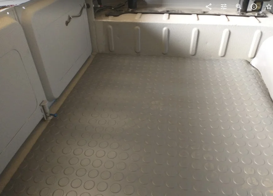

I bought some of this: https://www.amazon.com/gp/product/B07GJQRNXT?tag=ihco-20 and even tho states 1/4" it measures thicker at 3/8" and is heavy AF. I cut it to size in my rear bed.
Damn, it seems it's out of stock, but I would say it's been super durable at $65 a few years ago. Maybe search up the manufacturer 'casa pura'

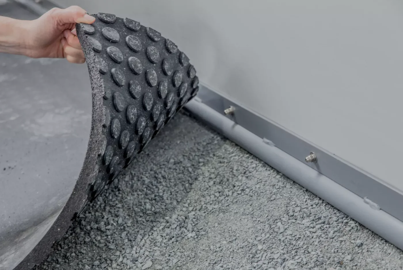

I used the thick rubber stall mat from Tractor supply. It has the round bosses on the bottom to keep it from trapping water. It was a 4'x6' mat that I was able to cut for the bed of my 40 and use the scraps to make floor mats for the driver and passenger sides. The only note I would make is that it is recycled rubber and can have steel in it which can make rust marks on your paint. Also, cut it with a utility knife. I tried a skill saw and it just burned and smoked me out of my shop.

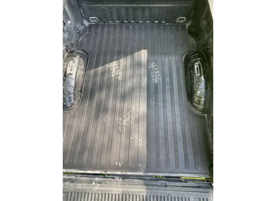

I have the tractor supply mat in my 40 right now too. When I install my Aqualu tub I planned to get a Westin style bed mat with the embossed ribs (just for the look) and cutting that to size.

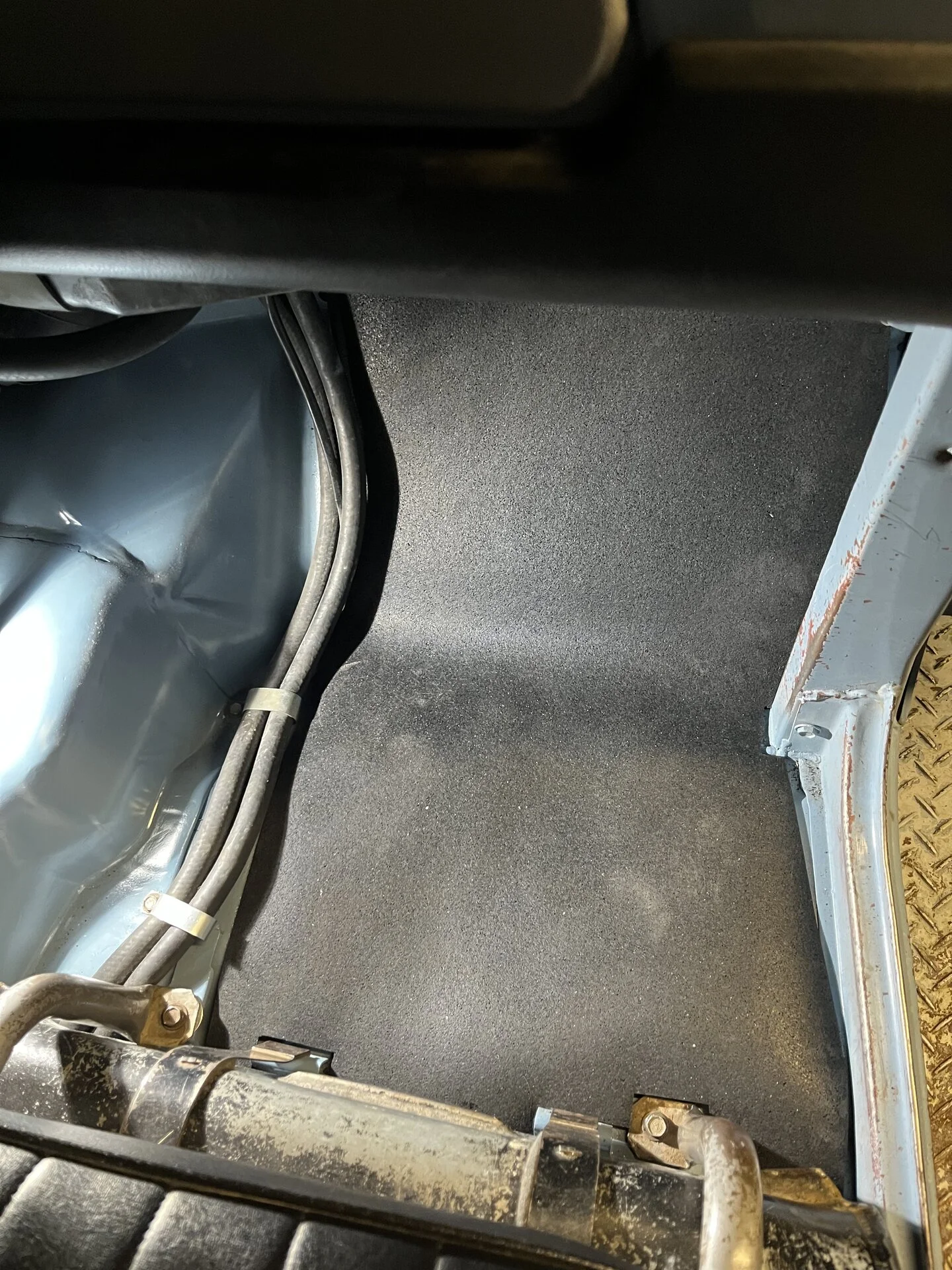

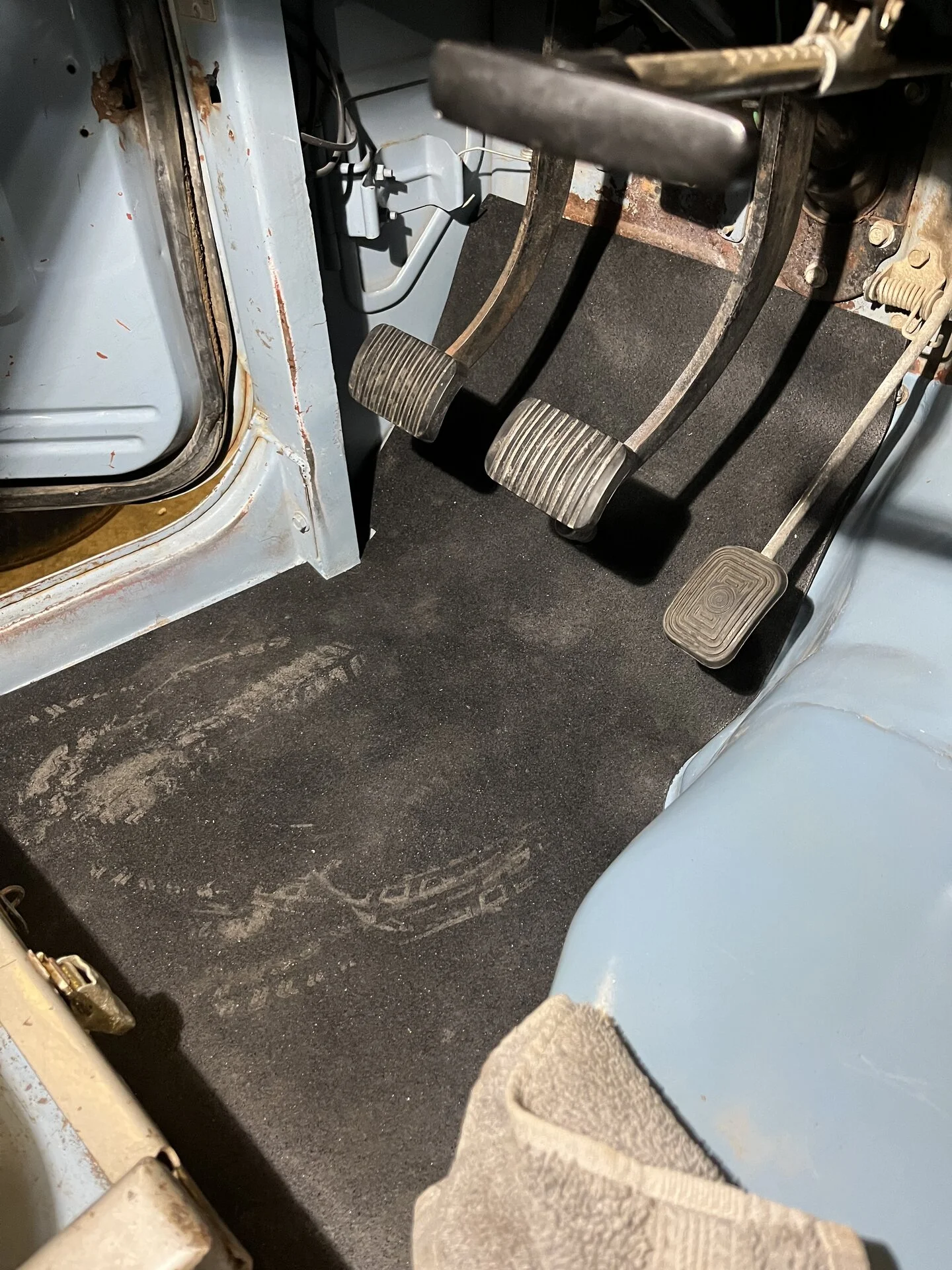

I used this. It’s like stall mat material but more flexible because it’s thinner. Cut easily and can take it out and hose off mat and vacuum tub. Came with enough to make a rear cargo mat and front floormats.
Rubber King Fitness Mat - 4' x 6' x 3mm - A Premium Durable Low Odor Exercise Mat Indoor/Outdoor - Black https://www.amazon.com/dp/B0964CGLBP?tag=ihco-20
