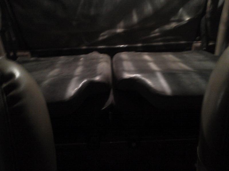

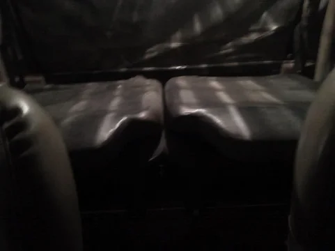

Seats sit on box which is bolted on top of fenders though the roll cage. Folded flat they sit up about 8 inches. Can fold one forward with out effecting the other which is ideal for a carseat so it isn't in the way if you want some tools

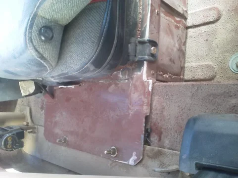

i used 1994 honda odyssey van 2st row seat bracket . the hinge and latch brackets bolt to the floor. so it folds up and pulls right out of the truck i do have a corbeau back seat.
Could you post some pics of the box and mounting? I found a rear bench out of a 92 Geo Tracker that should work. They are pulling it out today.
Gotrocks's seat looks to be mounted directly to the floor, with a fuel cell under the seat that sticks up through the floor.
