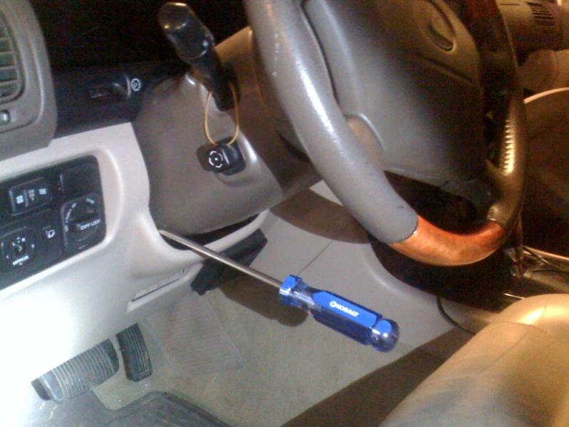

The flasher relay comes out easy. My trick was to take a long 1/4" extension, feed it through, put on a 10mm swivel socket on, and take out the 10mm screw from the bracket. That was much easier than taking apart the dash. If you chose to take apart the dash, it's still awkward to get to because of a white piece of plastic that is screwed in from the back if I recall.

Well I just wasted well over an hour of my life trying to remove the bracket that holds the flasher relay before I realized you can just pry/slide the relay off of the bracket. Ended up with a handful of long screwdrivers that I will never use again and one extremely stripped screw. I just could not get the bit to fit straight into the screw by feeding it through by the steering column. Ended up pulling off the relay and zip tying the new one right back onto that still-in-place stubborn bracket. Had I been smarter it would have been a 5-10 minute job.
Good solution.

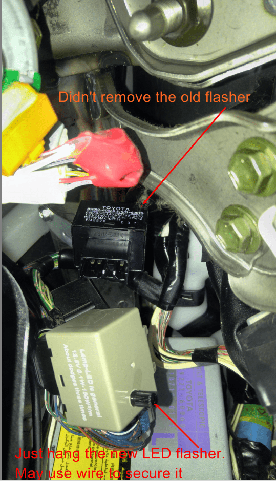

FYI, purchased and installed this relay today in a 03 LX. Finding the relay was easy but didn't bother to remove the old one. Simply plugged in the new one and zipped tied. Can't see why you would spend all the time to remove the bracket unless you just want to do it for the sake of doing it. Took about 15 min.

I actually took the housing apart and turns out the new LED relay flasher fits perfectly into the OEM housing, that way I could bolt it back onto place and it looks stock as anything.
Getting to it was interesting...
It's hidden up in there pretty good. I had the lower dash apart and the HVAC duct out for some other wiring project.
