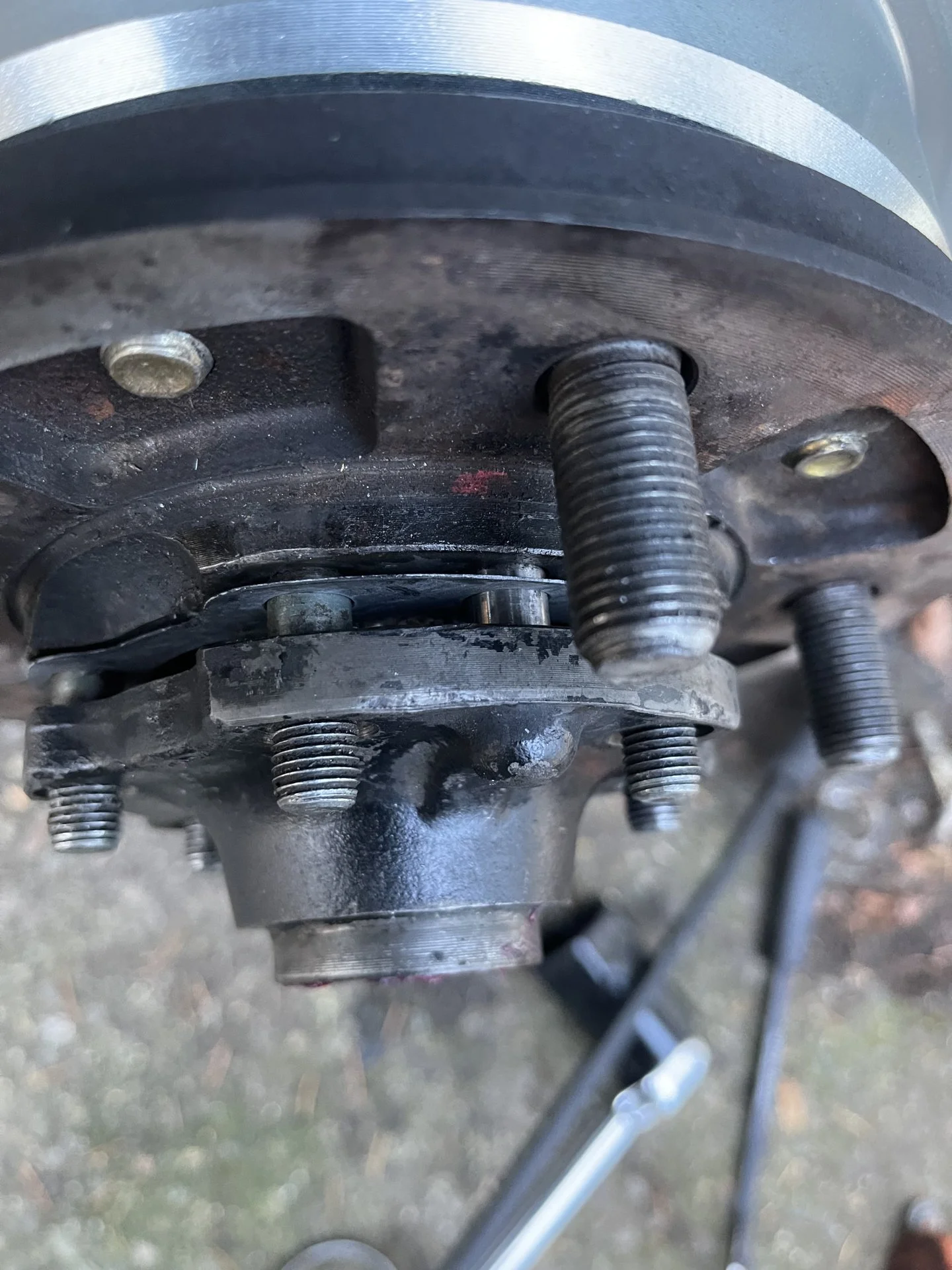

I was working on installing new CVs and while installing the flange, it was not going on smoothly, so against my better judgement I decided to tap it on with a rubber mallet to get it to sink the rest of the way, it started to go then stopped part way and began pushing the CV out, I gripped the back side to hold it in place and continued to mallet away until it was not going any further, realizing I may have an issue with the flange (or CV) I went to extract the flange unsuccessfully with pry bars and now it appears to be permanently stuck on the cv in this one spot.
Any suggestions before I destroy the flange and CV and start over? /s

you did remove the snap ring?

The CV came without a snap ring, I'm having to reuse the OE one.
Buy the kit of new ones from Cruiser Outfitters. You need to use the correct thickness to avoid problems, plus reusing old circlips has resulted in failure and subsequent damage. The CO kit is like $6.
There are snap rings that come in different sizes to hold the axle in the hub/flange and are not supplied with the axle. The D ring, which probably also goes by other names, holds the axle in the differential/axle housing, and is normally included/installed on the axle. I'm thinking there may be some confusion happening here.

If you're talking about the outboard C-clip do not reuse that under any circumstance unless you can verify it is exactly the same size as original. Those have been known to fail (somewhat often) when re-used and can cause catastrophic damage if/when the axle pulls out of the hub.. Toyota marks them one time use for a reason - it's tough to remove them without deforming them and it's difficult to tell it's deformed.
