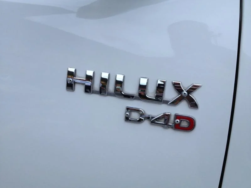

We're driving a 2012 Hilux Turbo Diesel D-4D while we're in Honduras on business and it's a smooth ride. I'm going to test it out in the mountains soon to see how it handles there.
This is a very cool option you guys are offering in the market.
