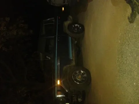

Some poser shots

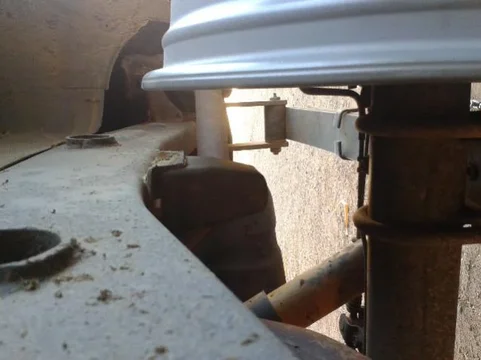

The front seems okay but the rear looks like it might need some spacing.The rim is about 40 mm from the frame on the rear axle.

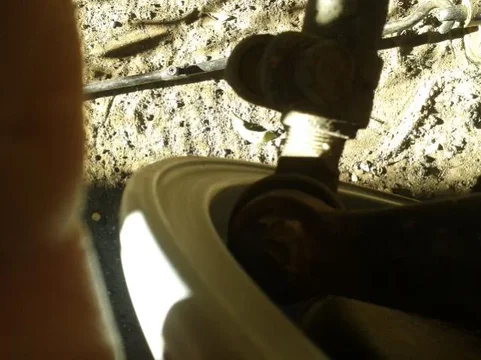

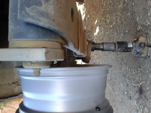

IME the issue was the rebuildable Toyota drag link end contacting the inside of the rim when turning.

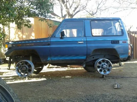

Finally got them fitted.
And the drag link is most definitely a problem. I can't turn left more than a couple of degrees. I'm going to try spacers and take it from there.
