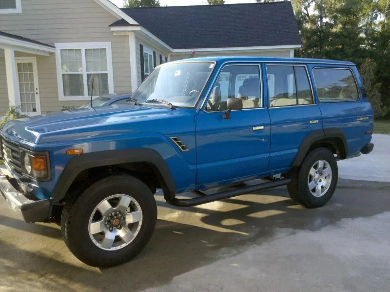

My 60's rims are mag style with the shouldered lug nuts. No spacer, but it is essentially the same..
On my 55, I used the Spidertrax in the back and Trail Gear spacers in the front. The FJC rim just cleared the front hubs so that is what centered them. The Spidertrax have an inset or chamfer cut on the back side that let them fit over the rear hub and then they have the lip for hub centric rims. Worked well. I don't believe the Spidertrax will work on the front due to this feature.

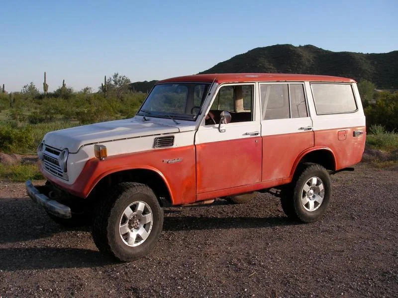

nice looking rims on the 55. glad to hear you guys have run this setup without problems. i'm probably over thinking it, but since i use the 60 for family trips, i want to make sure everything is kosher. i'll try the wheels this weekend and post some pics.

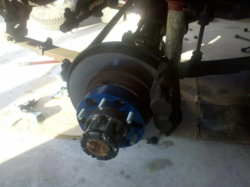

The spacers fit up really well. Here are the fronts:

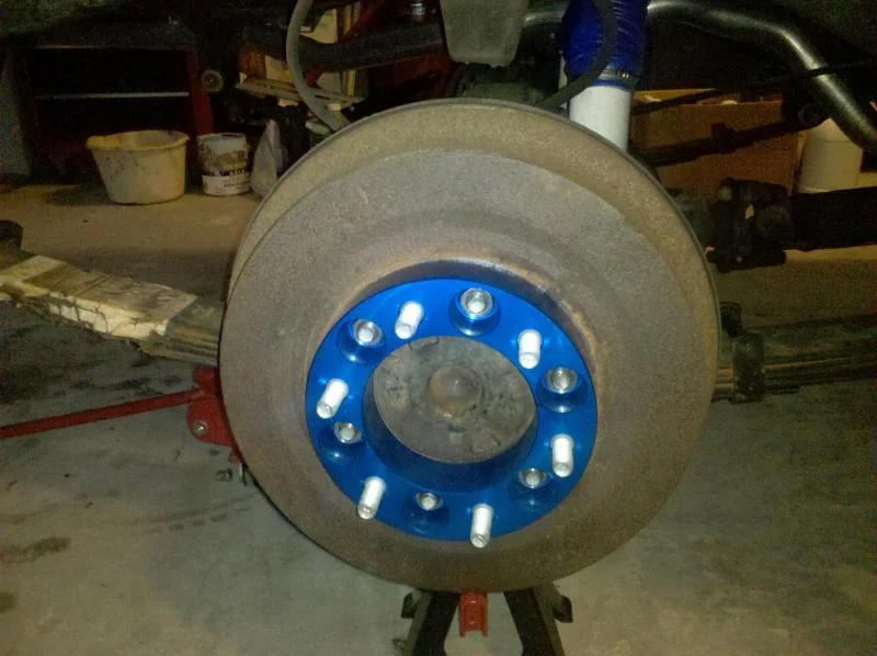

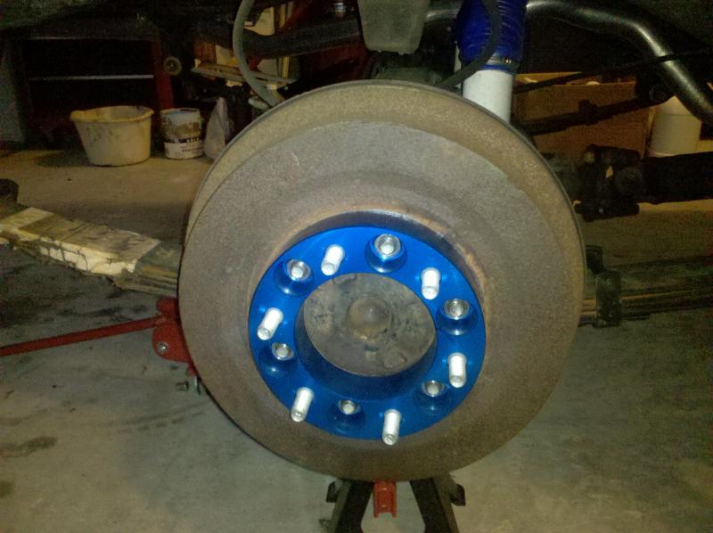

...and the rears:
I used three cone style lug nuts to get the wheel centered, put three of the mag style nuts on, took the cone nuts off and put the rest of the mag style lug nuts on and tightened them all to 75 ft-lbs. The shake down test went well- no perceptible vibrations all the way up to 70mph. And, to top it off, I think they look great!

Just to clarafiy...you used the hub centric spacer on the rear axle for the fjcruiser wheels? I've got some black steel 17 inch FJ cruiser wheels and on the front they work fine. On the rear they don't mate up correctly with the spacers I had with the rock crawler wheels which I assume are "lug centric" the lip of the wheel on the fj cruiser wheel dose not seem to mate correctly with the lug centric type spacer (is this the magic question?...and the solution is to run hub centric spacer on the rear axle?)
