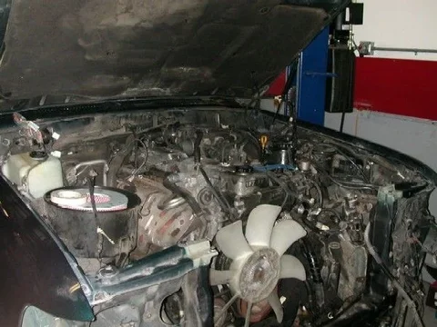

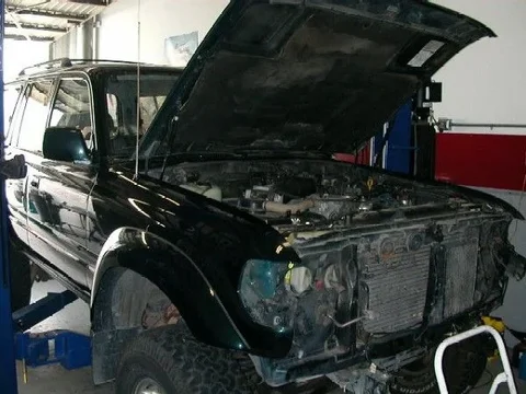

Old motor gets pulled out. Front bumper, grill, hood, radiator all get removed.

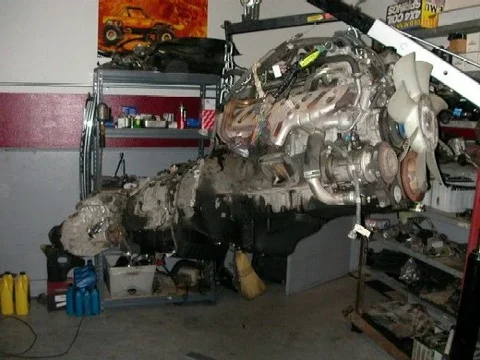

Hello. It looks like you are having alot of fun there! Is the 1HDT a Turbo model and will the stock tranny bolt right up? What are you going to do for the exhaust? Having had two Power Stroked Fords, I love diesel power. Thanks.
Yes the stock tranny will bolt right up. I am going to use the one that came with the diesel one.
It is a Turbo model:)
I will have a custom exhaust made with aluminized tubing and a flex pipe. Big exhaust.

Just called the Oregon DMV and they say as long as everything from front to rear (engine to gas cap) is converted, all you need to do is fill out a little paperwork and change the title from gas to diesel. Legal for on-road use!:D
