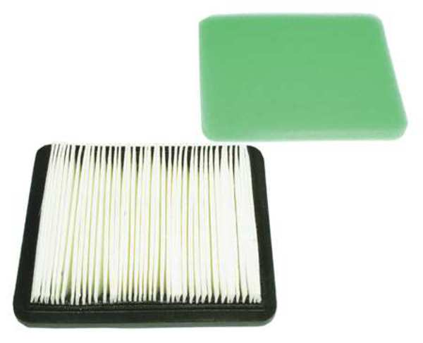

That is awesome, great job. If you get some measurements, I wonder if a simple filter like this can drop in, lawnmower type.

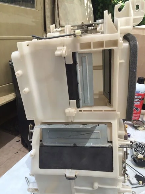

Also happy with my renewed ac , blower and heater.
Can't wait to turn it on. Just in time for cool fresh air for summer.
Cleaned and replaced all foam pads and insulation.
So stopped for today. Hopefully will start again tomorrow.

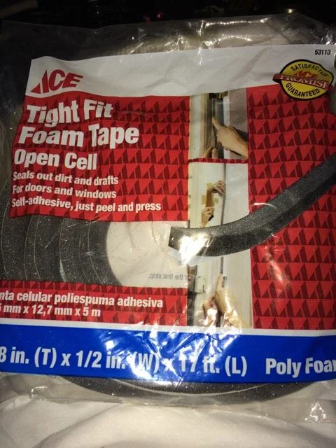

Where did you get that rubbery foam for the hole you cut on the outside? I've been looking for that material.
Got it at our local hardware store.
It's an Ace product. This is of another type they have.
Happy hunting.

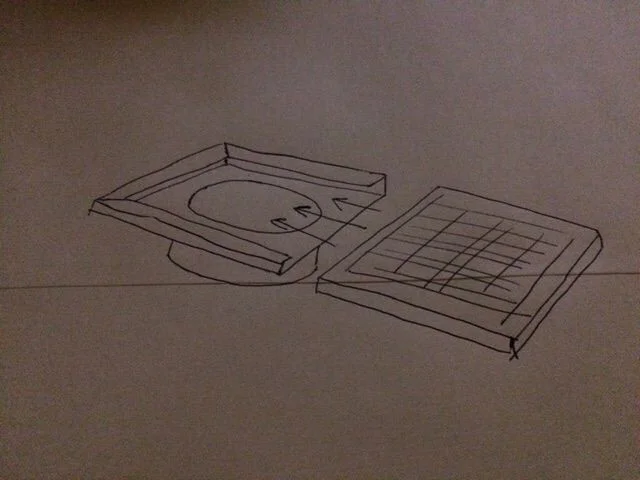

No. I've just decided to create a tray with a retaining edge that will fit onto the blower scoop probability permanently with silicone.
Then all Ill have to do is slide a small common filter into it and slide it out when I'm done.
Will leave all current vents as is. Want as much air going in as possible. That scoop needs help. Plus would want water to go through for drainage and keeping that area clean.
Will first source a filter that will fit then a sheet of tin to make the tray from one piece paint it and glue it in place.
Stay tuned.

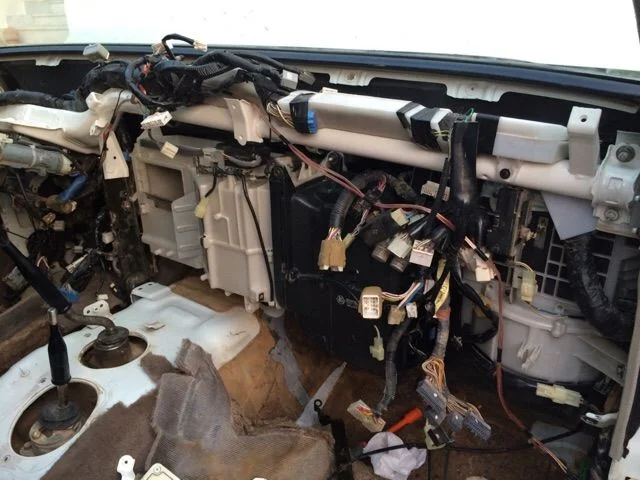

If you refer to this picture of the firewall
Would be tricky to move the wiper motor. Not much room above or below. It's sitting smack in the sweet spot.
But I commend you for the best idea that can't be done : p
Thanks I'll look around those makers of filters.

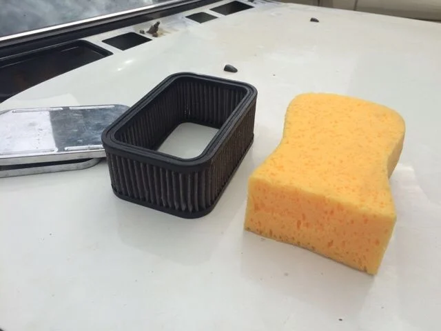

On the way to drop off my kid to school this morning i remembered I have a small filter in storage that sits on top of the weber carb. So rushed home to see if it would fit.
Very close.
The only problem is the filter is very thick and impossible to manoeuvre in. Went and got a sponge to see and yes it's very close to the scoop size.
There is a small gap on each side of the sponge. I guess because the sponge is cut like that for ergonomics.
Will go get a bigger sponge for the temporary fix till I get the filter system done propa.
Could the filter be cut in half ? Let's see
