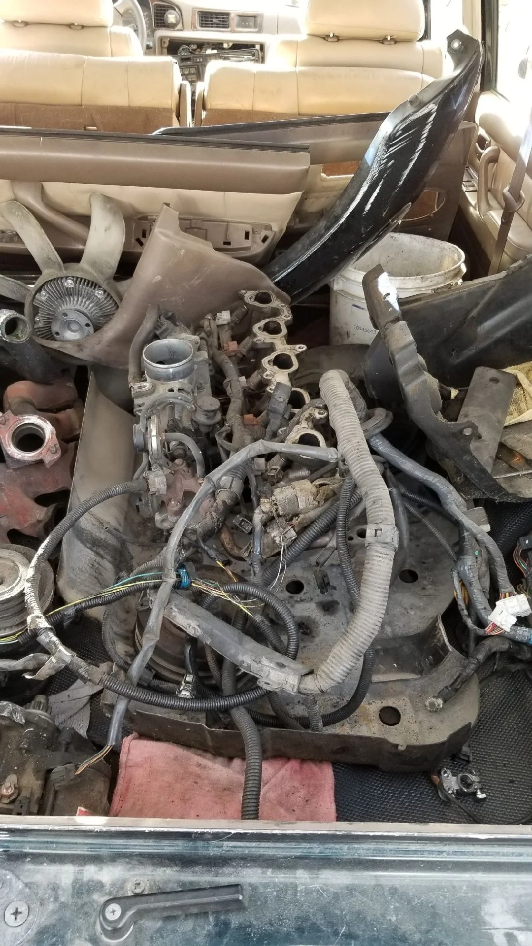

i'm assuming your doing what I've done, Mechanical Diesel with A343F and 80 series transfer case? I bought an extra harness to do my stand alone. So I have my original with most of the engine side removed when I used the OEM computer to control it. let me know if your interested pulled from my 1996

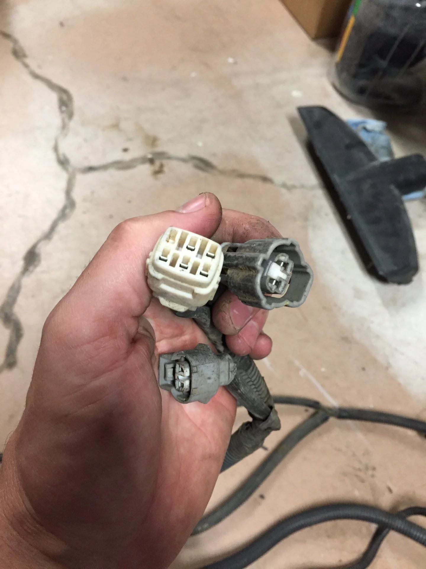

this Picture is the trans temp sensor and the shift position indicator or right side of trans not through the 2 bellhousing conections .

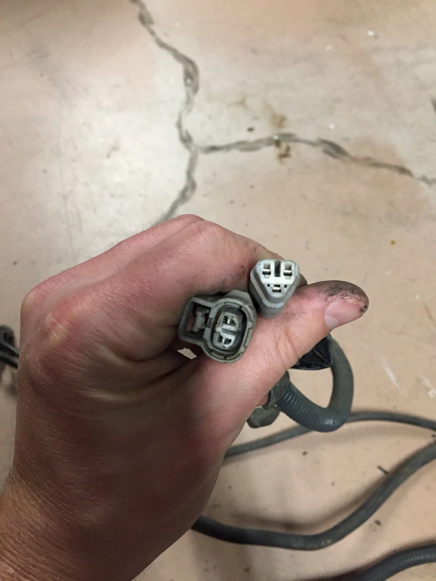

This picture is the trans connection near bell housing going back to the back side of trans and the transfer case

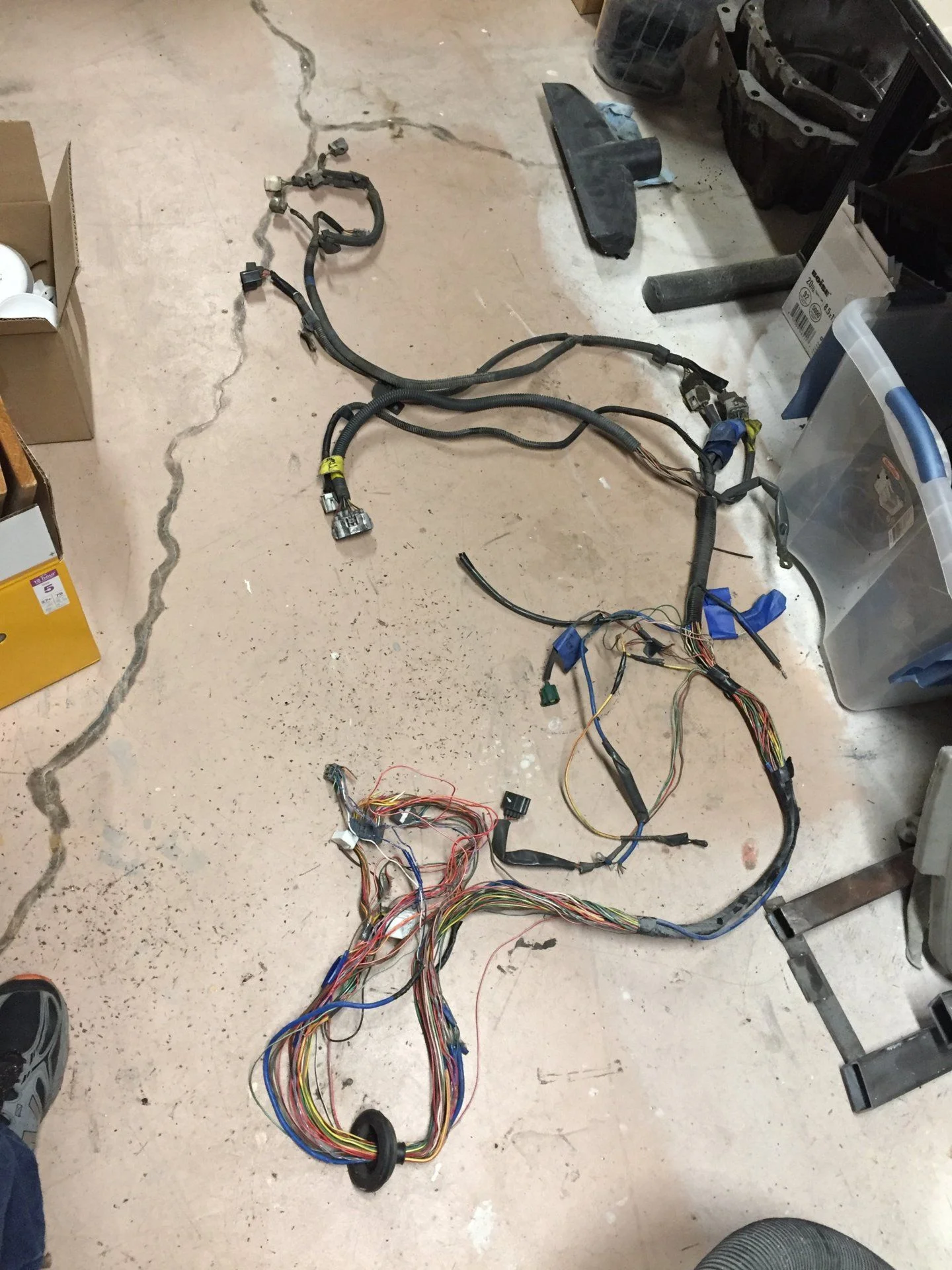

Picture of the whole harness
These atach on the left side of the rear side of the trans

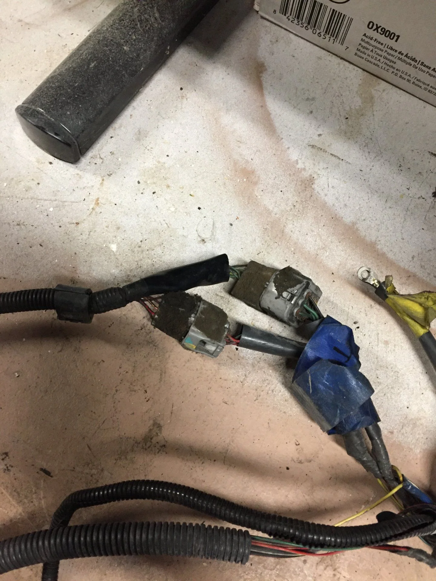

These are the speed sensors on the rear of transfercase
These are the transfer case locker and position sensors
As I mentioned in pm there are different styles of the a343f not sure why version you have so look at connectors close the newer uses a 4th solenoid for line pressure and the 80series us s a mechanical cable to throttle position for line pressure control. I’m assuming wiring harnesses are different.
