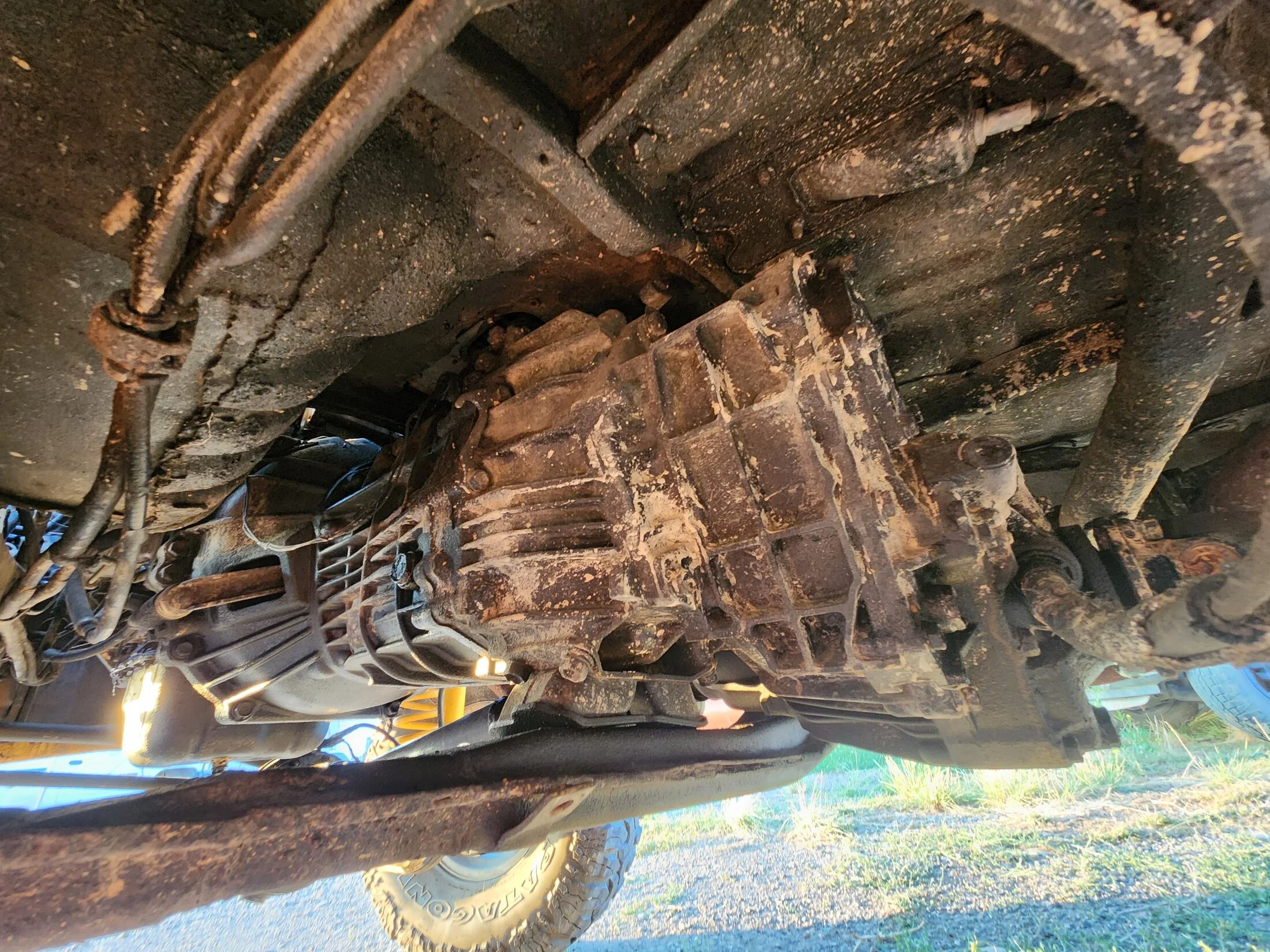

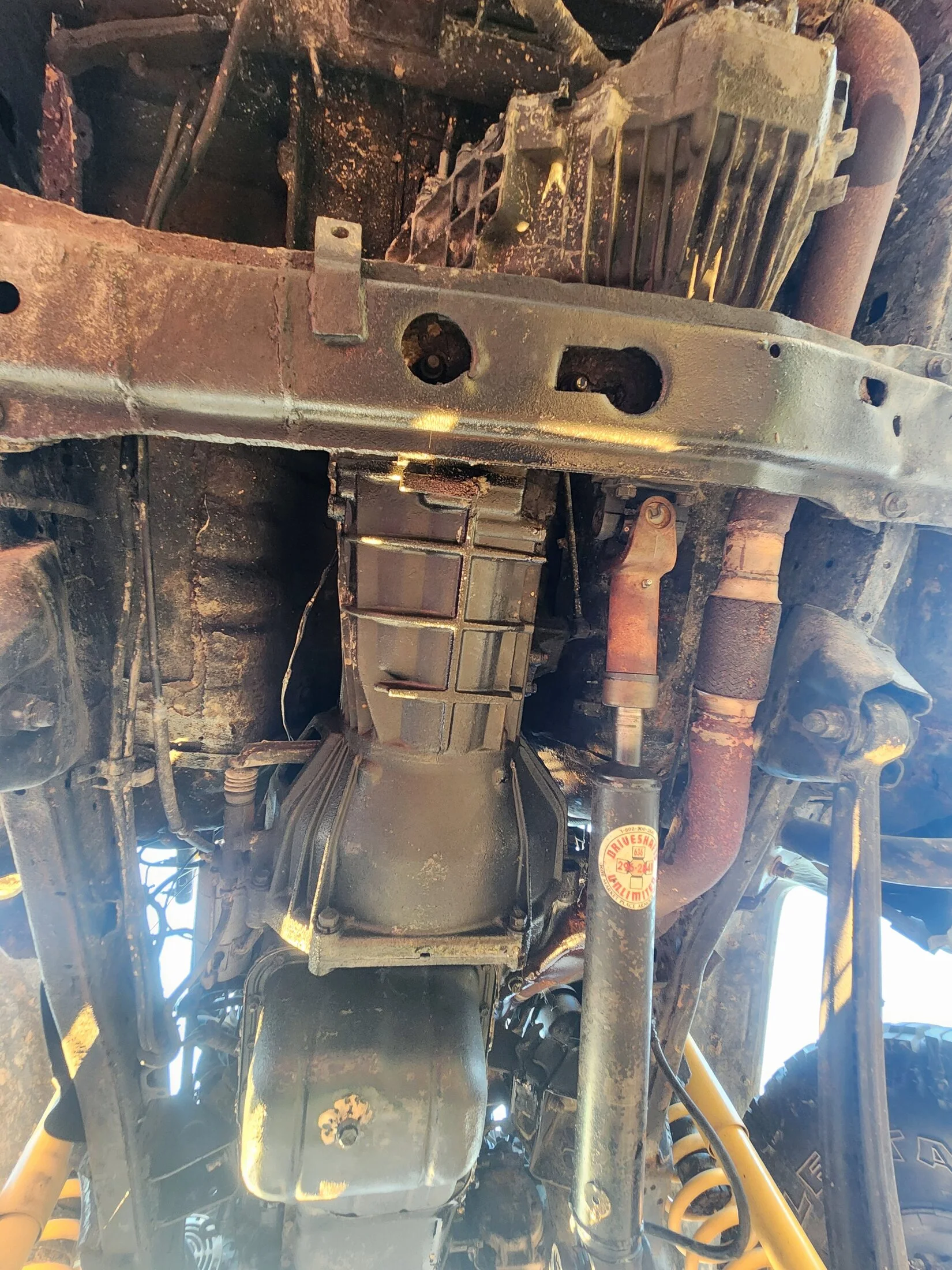

Identify my tranny and transfer case? H155F?

Gearbox looks like H150 or H151, carbed 70 series is usually, H150. Bigger 1st and 2nd.

Depending on month/year of manufacture you will have an H150/H151 5-speed manual transmission and an HF1A part time transfer case.
Check the data tag on the firewall to see what transmission it was originally equipped with (whether it is still there is less sure). The hose looks like AC condenser drain maybe?
it LOOKS like an H150/HF1A, but based on the pics i'm looking at we're dealing with a whole drivetrain swap, even the coil front end looks to be a swap, lots and lots of hints in the pics.
so really the i.d. tags on the trans and case will need to be looked at, if still present.
would be interesting if this was a 22R rig, but this was probly a 3F/H55 truck with a leaf sprung front, i'd like to see the firewall data plate assuming it wasnt also swapped.
