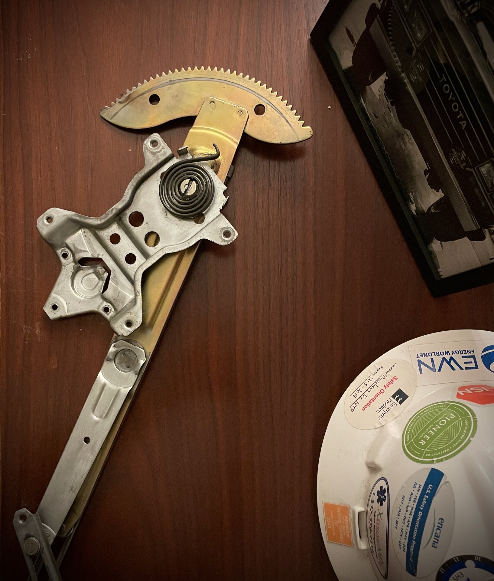

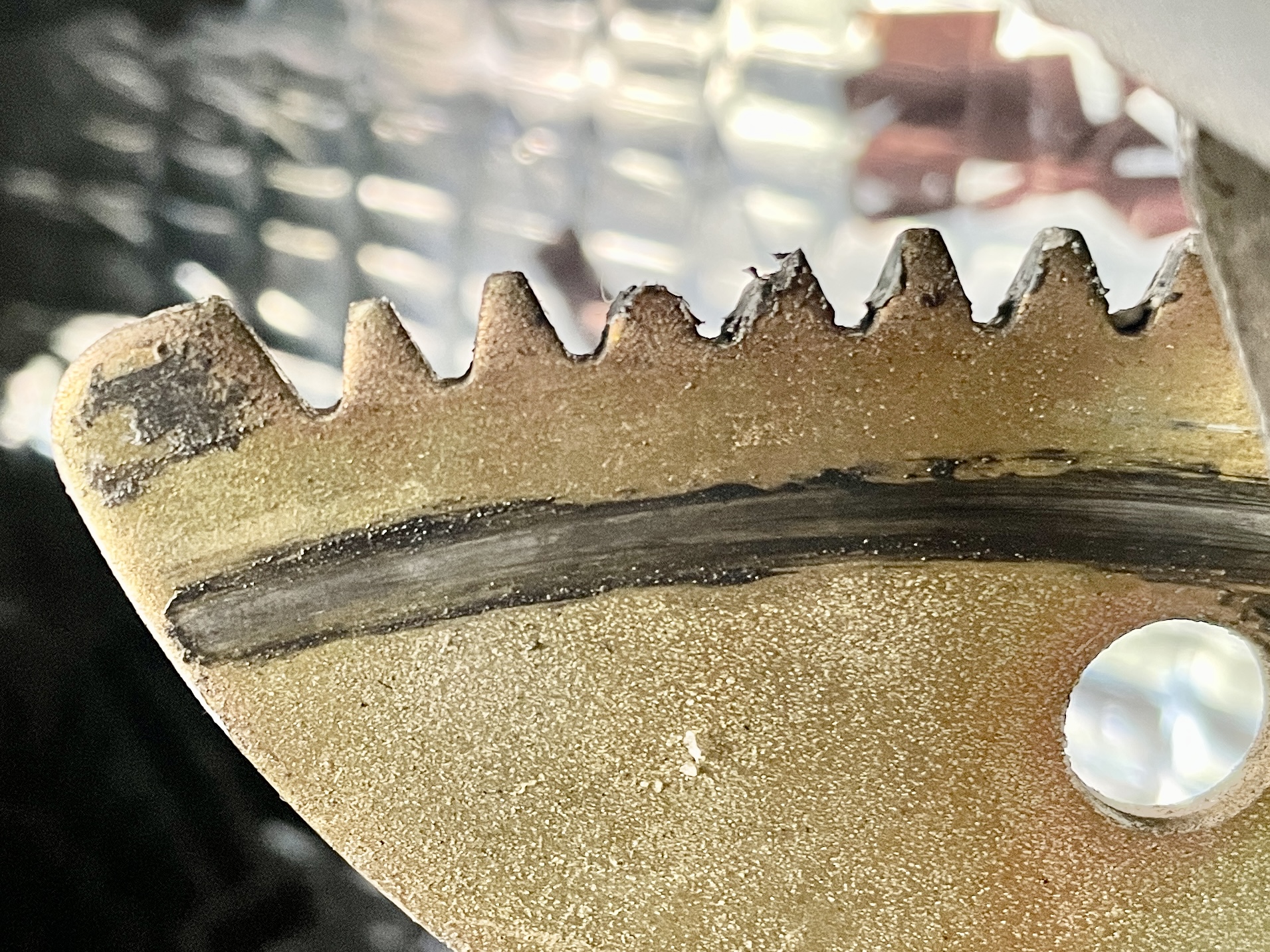

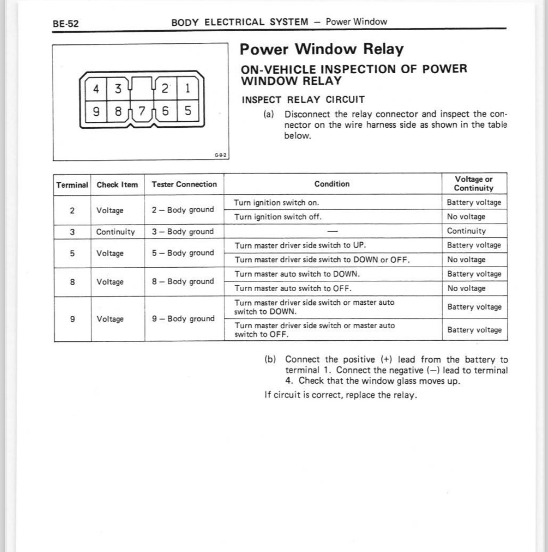

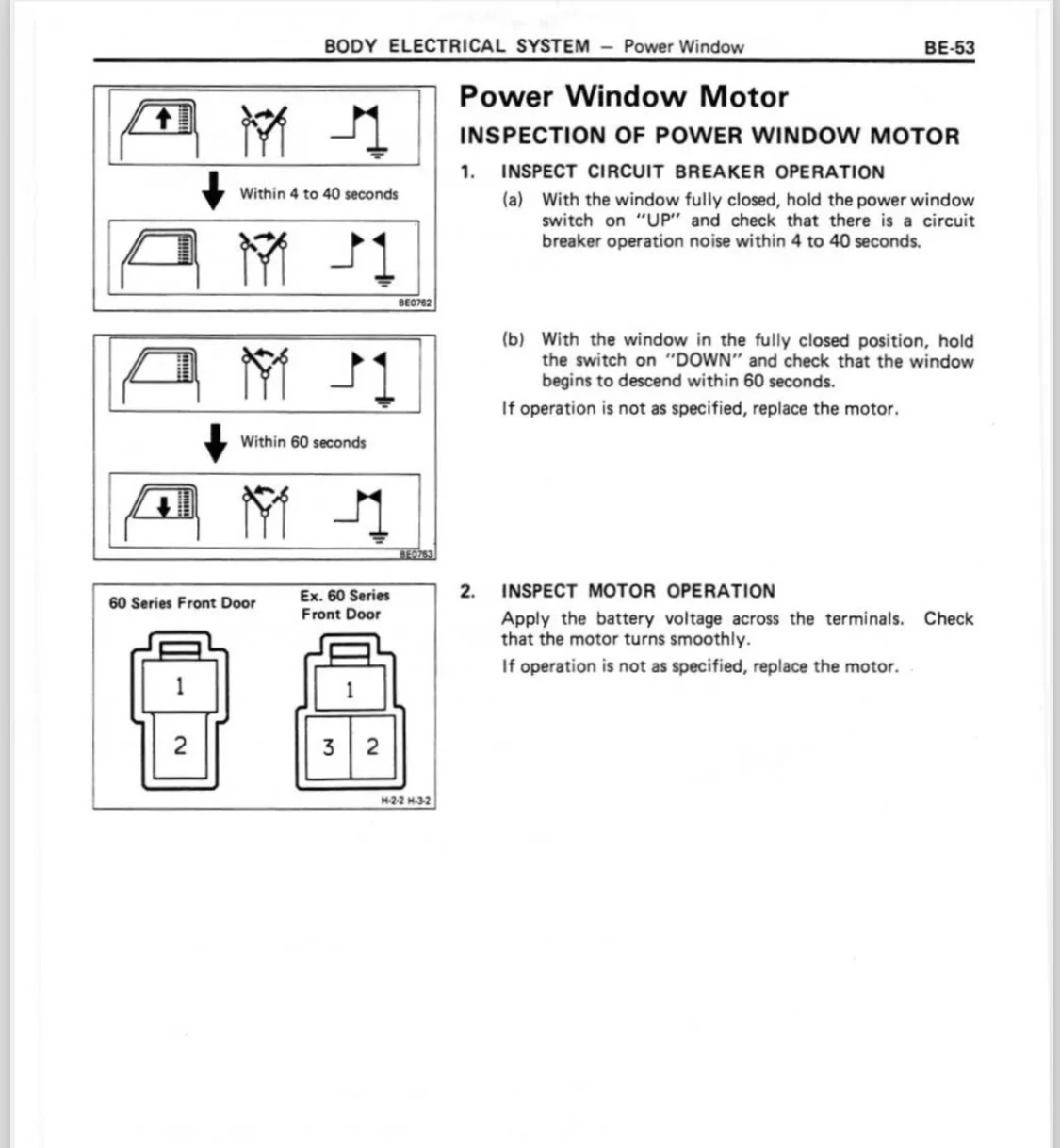

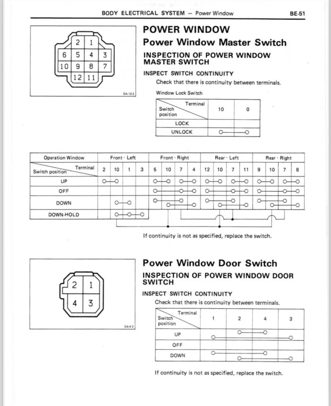

Hey Jax, any luck with continuity check? I came back to this was curious. I pulled the procedure for continuity, relay and motor. Pull your door card and peek up at your regulator crank teeth, those take a beating on either end of their travel. For some context this is before and after on the sprocket, smooth wear just enough to stall it. Welder tacked a bead on that tooth and filed it back to spec

Hey Texas, thanks for checking in. I have not been able to check continuity yet. I can say I do not have an issue with the teeth however. I tested it with 12v and swapped the leads and I could get it to run both directions. I’m thinking it’s got to do with the master switch and the down button for that passenger window. Just have not tested it yet. I’ll definitely reply here once I do and hopefully get to root cause.
The issue with mine, on the same passenger front window, was carbon build up in the Master panel switch. None of the sprays could get behind the copper bands/rivets that make up the circuit.
