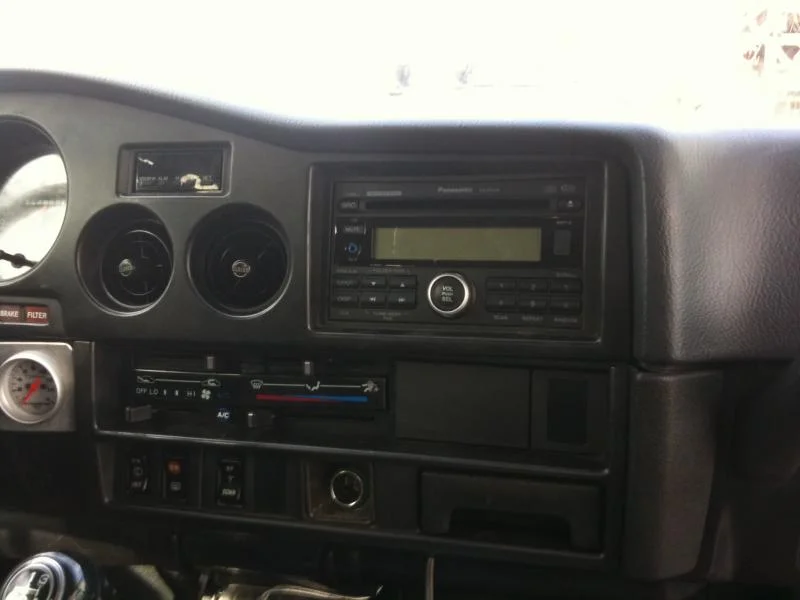

As you can see from the pics below, this stereo in particular is a PERFECT match for the OEM unit. It is the exact same size, shares all mounting points and even matches the green interior lighting for the rest of the dash. I didn't have to trim anything even a little bit - literally slid right in...

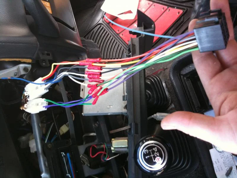

0) Put your wiring harness together - this is just connecting the little Scosche wiring kit with the harness that comes with the radio. It is so simple as to be ridiculous... you are just matching wire colors up according to the little chart provided on the bag. If you can crimp and can tell wire colors apart then this is a cake-walk. If you are color-blind, have a friend help :cheers:

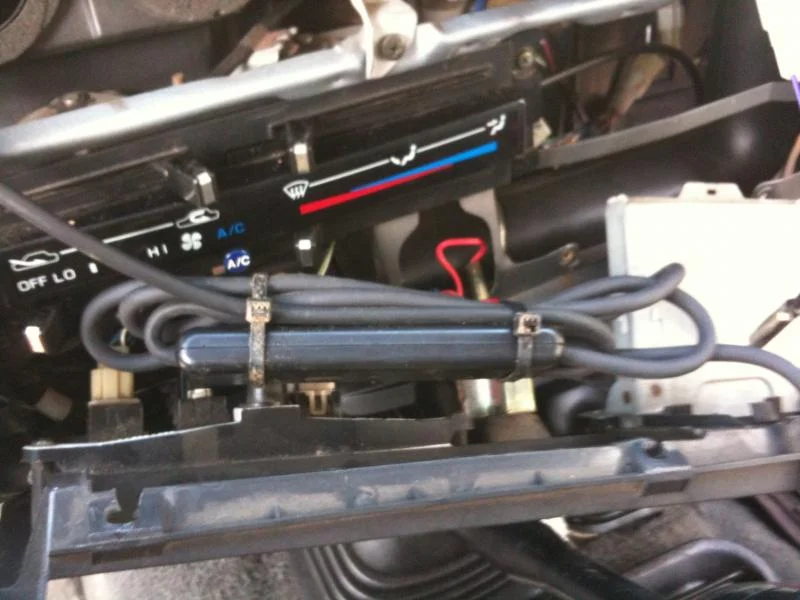

1) Remove the upper and lower dash faces/guage cluster from under the dash. This is a piece of cake: Just unscrew 7-12 screws (depending on who your vehicle's previous owners were :doh: ), slide the pinch-knobs off of the climate control sliders and pull the two pieces. They should come relatively easily, so if they don't = look for a hidden screw.
2) disconnect the guages: these are all fusable links that only work with a specific match so I found this impossible so screw up.

4) Grab your premade wiring harness from Step 0 and plug it into the harness you just unplugged from your stock radio.

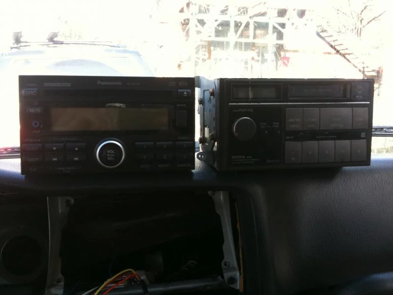

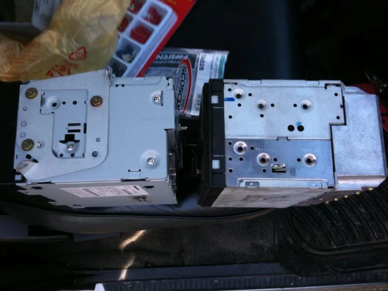

On the pics below, the first two pics show the OEM unit and the Panasonic side-by-side for comparison of size. OEM is on the left, new unit is on the right. As you can see they are a dead-ringer for each other in terms of dimensions. Pic three shows the new harness all hooked up.

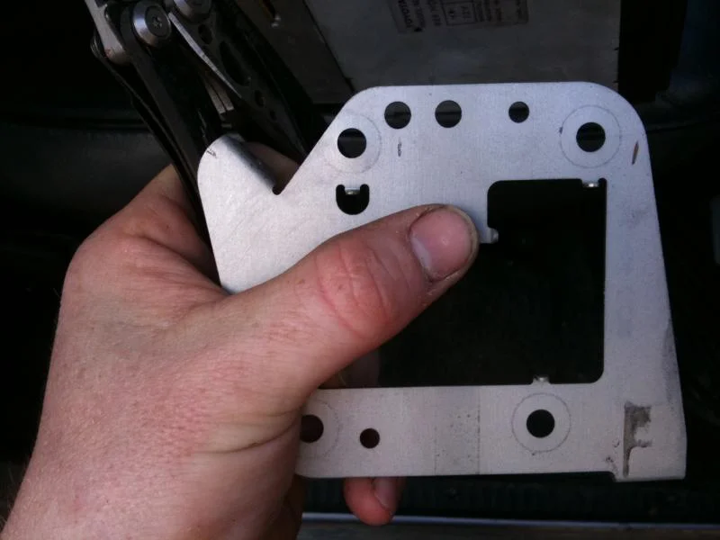

5) Remove the mounting plates off of both sides of the OEM stereo. Do this one side at a time so that you can have something to compare what holes they mount to and their orientation. Basically, the mounting plates should screw right into the sides of the new stereo.
On mine, I had to bend one tab on each side (noted below) to make it fit, but that was a piece of cake (just did it needle nose pliers). They just screw right in.

Final impressions of the stereo:
It is a great unit that does everything I want plus more. Having the weather radio is killer as is having the ability to plug everything from an ipod to a usb drive to a cd into this unit gives me tons of versatility.
I also like that it doesn't look out of place in my rig, nor is it something that I think would tempt someone to break in for it.
The sound quality is rock-solid, I also put in new speakers all the way around as well which helps. Getting the front to fit was a hassle as the windows couldn't roll down but I fixed that by buying a set of rear cargo mounts like the 62's all have and mounting those in my front door panels instead of the stock speaker grills. This was killer. It gave me way to get modern speakers in the front but pull their mounting surface out the 3/4" needed to give the windows clearance, that also looks stock.
100% happy with the results on this one.
