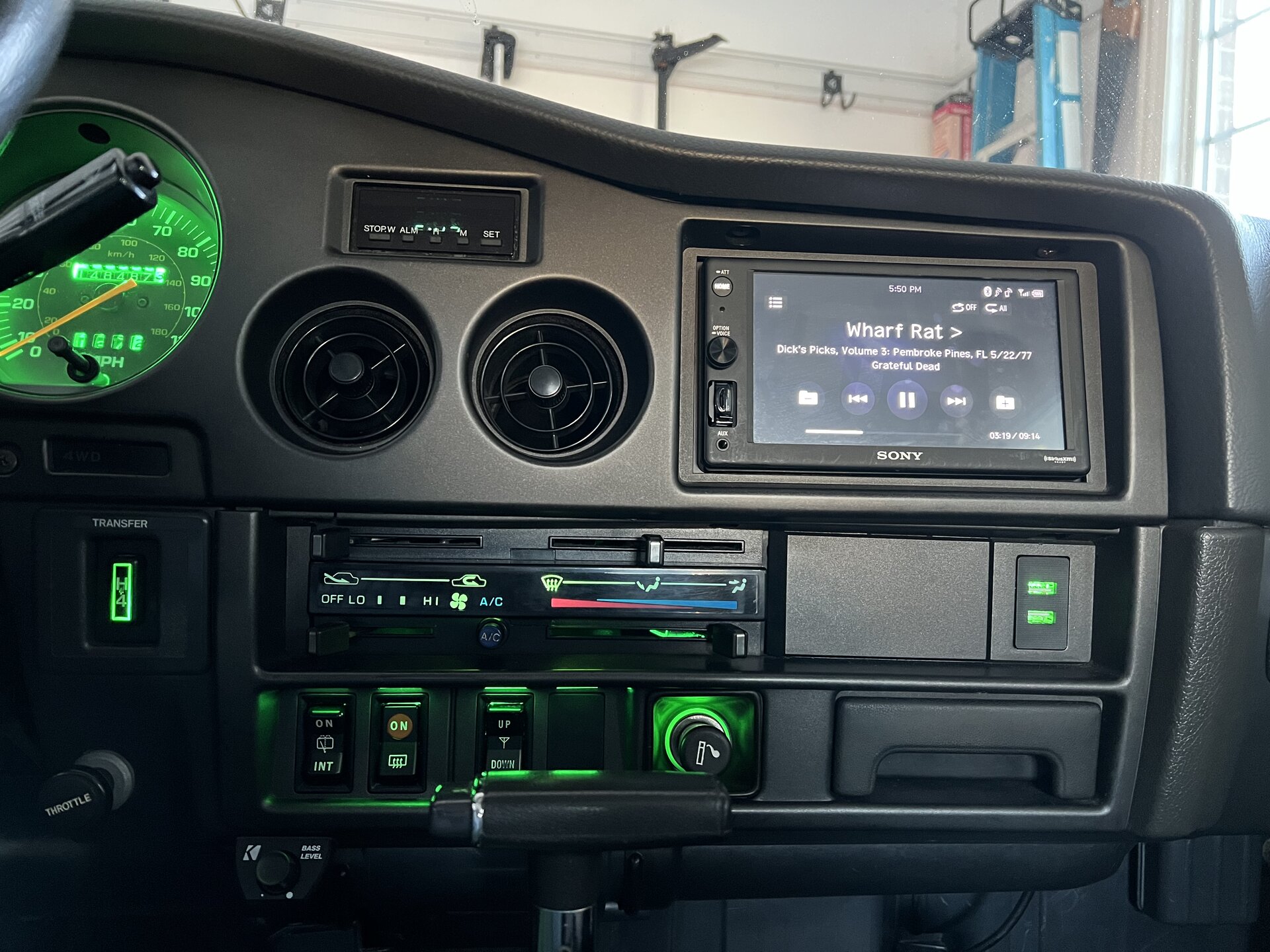

I like this Sony (Model:XAVAX1000 I think) and the grey background blends in well. Has backup camera attached as well. I use BT and plug small USB drive into front full of FLAC for music.
I have this radio in another car I installed with backup camera and it works well. Apple play etc. I have a pioneer unit in my FJ62 and I would not recommend it. The usb plugin is intermittent. Bluetooth works fine though.
