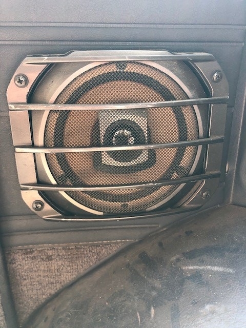

Pull the factory speaker cover and grill by removing the 4 screws and then prying the grill off with a trim tool:
Remove the three screws to remove the factory speaker:

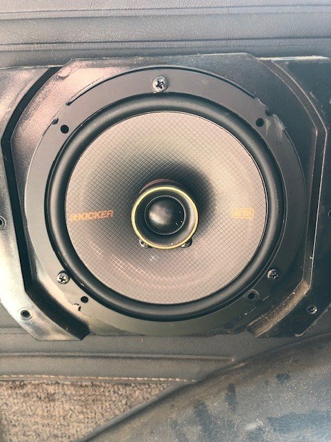

Trim the 4 tabs off of the 6-1/2" speaker so the speaker grill will cover the speaker:
Connect the factory wiring on to the new speaker, and install using the top screw hole into the factory hole in the location. Use included screws to attach the speaker through the plastic panel and replace the speaker grill and speaker cover:

Did the rears this weekend and they fit perfectly after the dremel. Immediate sound boost, hope to do fronts shortly. Looks like previous owner who did fronts didn't even secure them to the door frame so could get weird.

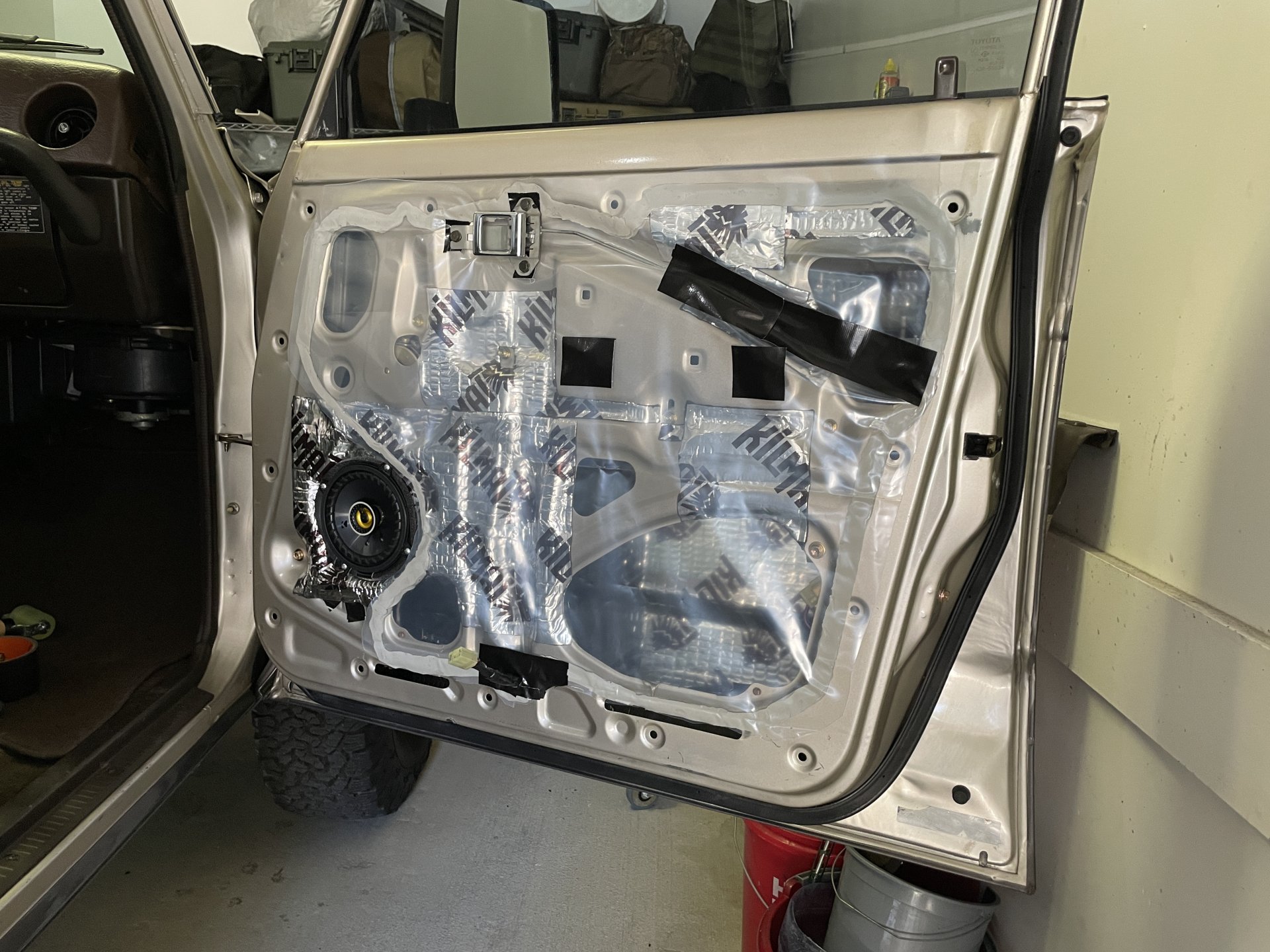

just did this to mine with same kickers. fortunately, previous own butchered the screw hole and punched 4 holes. they have the new hs10 kicker micro sub that slips right under the seat. added the kta450/ilx650 piggyback amp for door. deadened as much as I could in doors. the best surprise was wrapping the rear speakers bracket with density butyl. just ran strips of it on all 3 vertical supports that panels attach to, see marked pic. that killed every single speaker vibration I had. I got temporary solution to the front speakers with the foam cups and back cut out. I’m still tuning but having trouble getting away from sounding like I’m in a school bus with canny sound, I’ve got felt liner and cloth seats but think all that glass will be hard to ever stop it completely. he’s right on depth but measure it out and will not find a shallower speak than 1.75, but only need .25 spacer of any kind and its perfect. I included the clearance to glass with this arrangement.

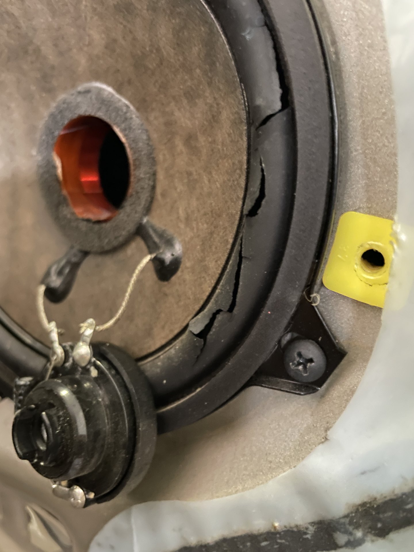

I just put these in last night
Windows roll down fine now, no magnet hitting the back. The polk speakers that were in were old and the drivers side had cuts/cracks in the foam of the diaphragm. So instead of spending 30 on a 3d printed spacer (which I have my own 3d printer, too), or just putting some nylon spacers behind for cheap - I just changed out the speakers. Easy stuff and sounds better

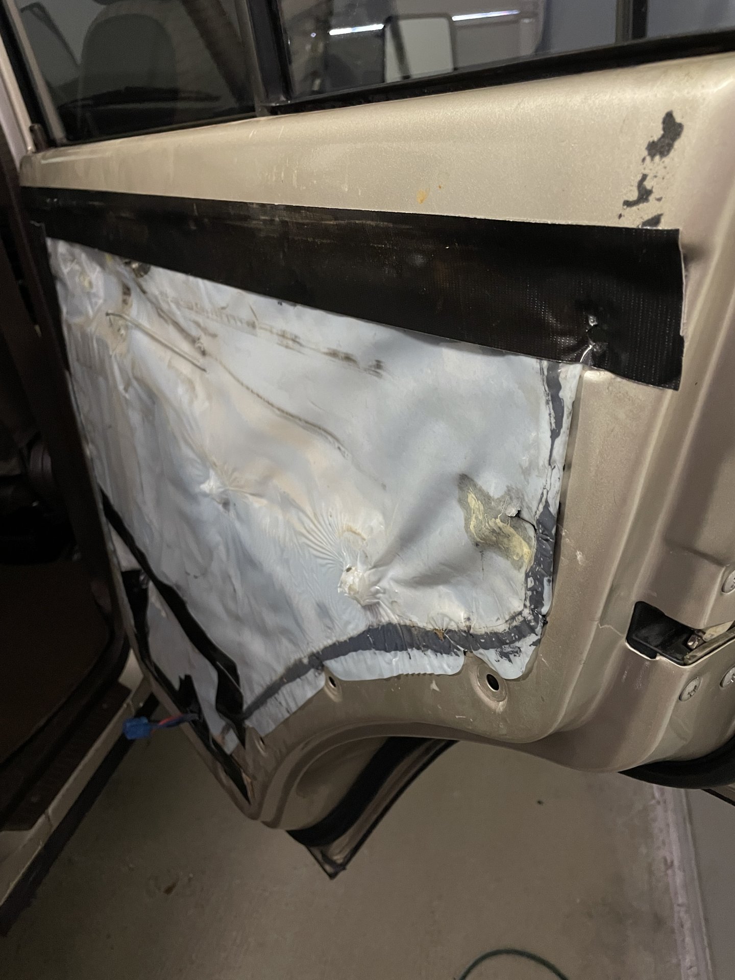

Oh and I probably did this wrong but I spent 3 days getting old Butyl sealant off the damn door. That stuff is my Kryptonite. Went back in with new but a neutral color, used a heavy mil clear shower curtain to replace the seal. Here’s before and after
A good alternative to the black sticky butyl (hated that stuff) on the inner door vapor barriers is 3M heavy duty double sided mounting tape. I switched my doors to this years ago, it's still a breeze to open the vapor barrier to service the door and restick it. No muss no fuss.
