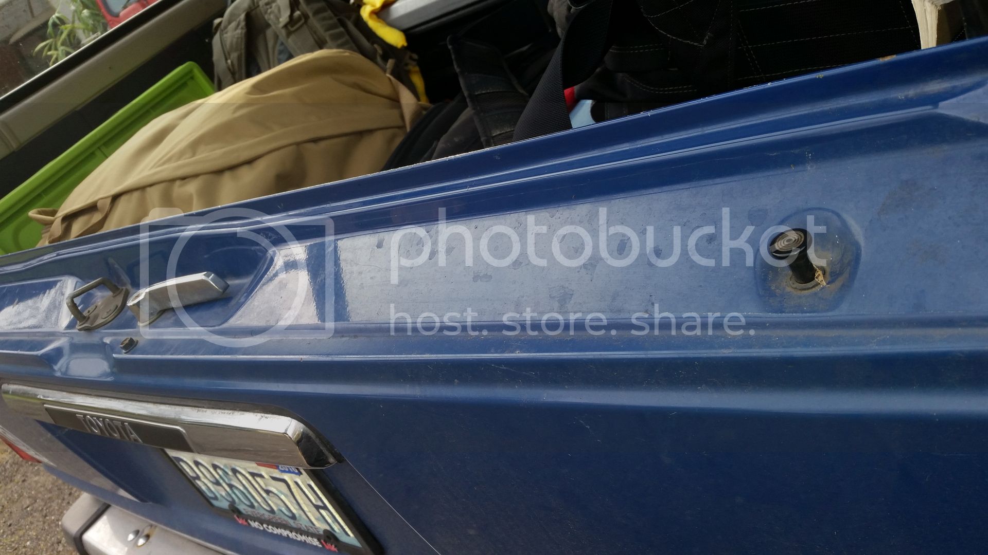

first, thank you for teaching me how to open the gate! I took a little WD40 to all of the locks, everything is moving smoother. I also opened the access panel...you were right. the linkage seems to be missing. i opened all 3 access panels and couldn't find the missing piece. I've attached a picture just in case you guys see something I don't. What are my options, preferably without buying the entire assembly?

very helpful pictures. thanks!
Pics of the FJ62 rear hatch lock mechanism.
Appears you are missing a linkage rod that attaches to the blue clip and the lock actuator.
@TF88FJ62 , I'd head to the "Parting Out" section and start pinging FJ62 owners for that part. You should be able to find it for a few bucks, I'd imagine. Good luck!
