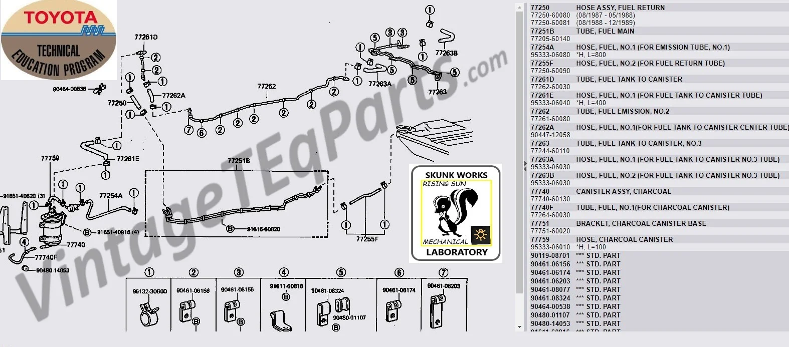

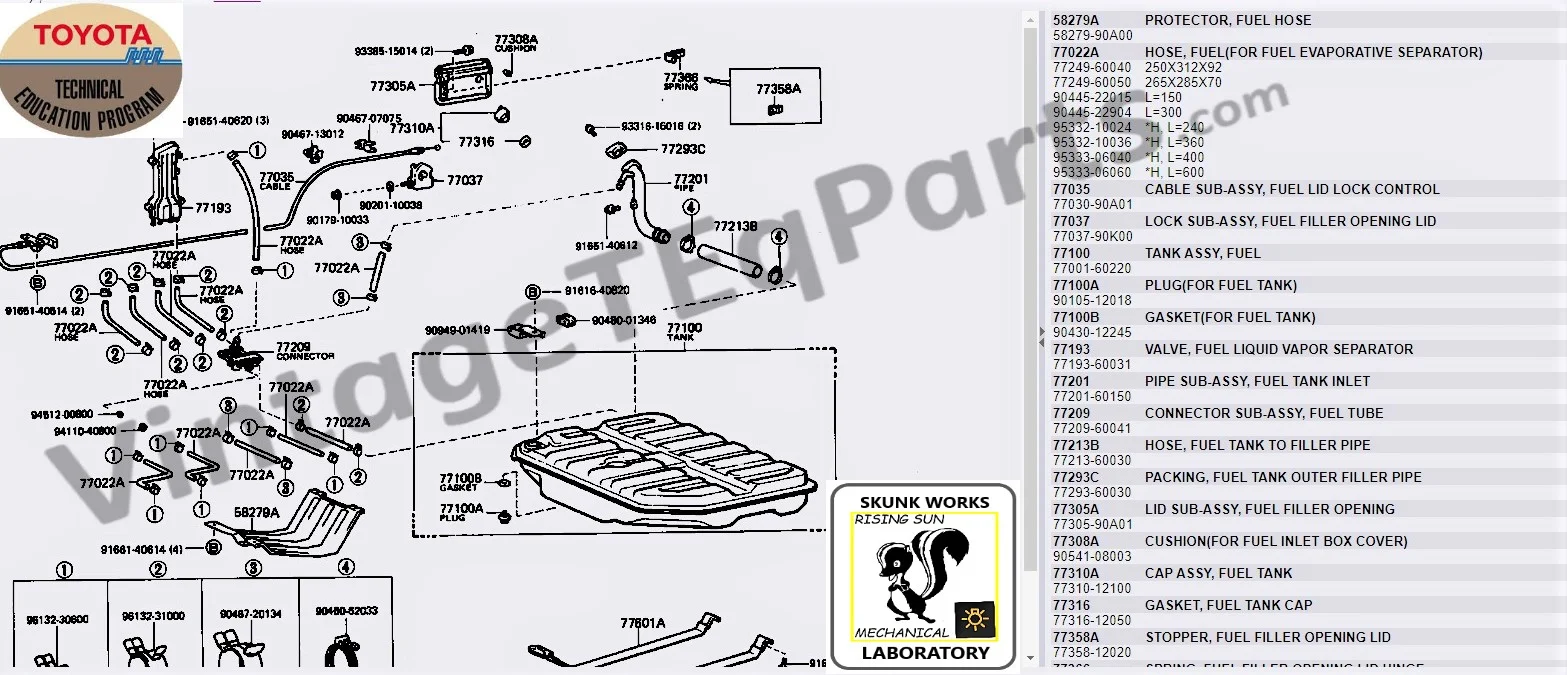

I was under my FJ62 the other day and saw how the rubber fuel line hose is getting old. Does anyone know what size hose and how much to purchase inorder to replace all the rubber bits? It's a 1989 FJ62.
I guess I need to get one of those.
I usually order my parts online so part numbers help inorder to receive the correct items. Thank you though. I'll have to find myself a Toyota professional.
- Here are all the part numbers you need and the call out prefixes too ...
- only SOME of the HIGH PRESSURE line have the special fittings on them like @diesellibrarian mentions , and he IS correct also on that topic ,,fyi
- would suggest you contact a Extremely Professional , as well as polite and friendly VENDOR , @cruisermatt , Cruisermatt's Off Road Powertrain and Chassis Specialty Performance , he specializes in the whole FJ62 Fuel System as a whole , and has some unique NICHE plug and play pre-packaged problem solver Kits already mapped out ,. that include all OEM parts too .....
