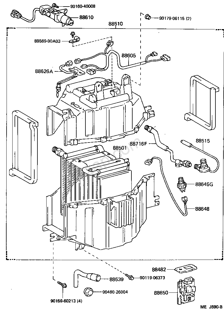

i just checked TIS network @Onur , is suggesting correct path , its still a good part #
fits old YR van
8/80-1990 FJ60/62
call out # 88515
VALVE, COOLER EXPANSION
88515-870041987.08 - 1990.01

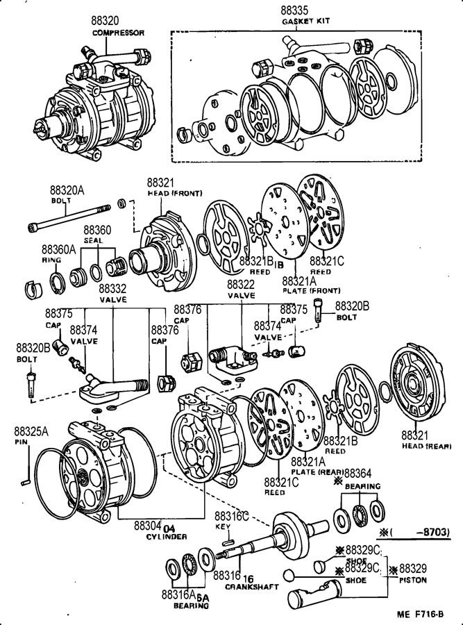

Now, if can find the # for the comp gasket kit ?? 88335- ?????.. :bang: Or even Better # 88320-?????
