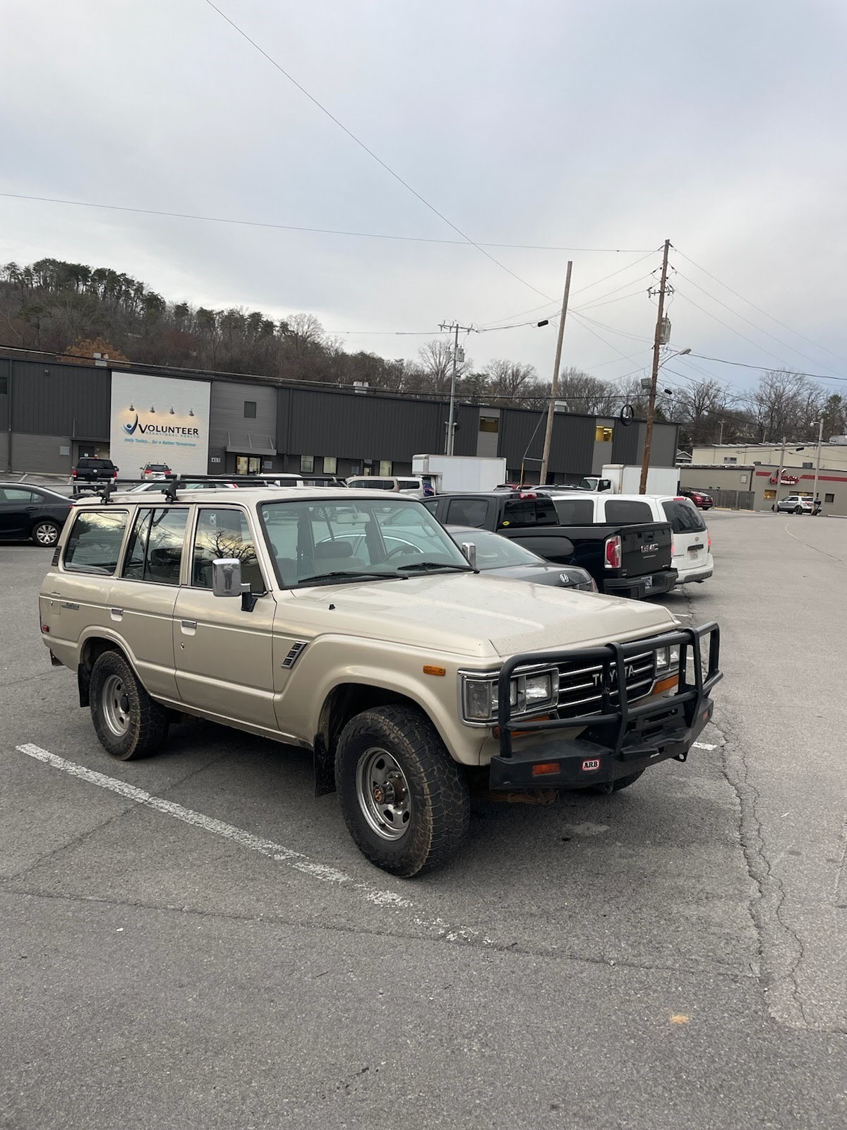

Calling all FJ62 or 3FE Experts
I have an 1989 FJ62 that is having some weird issues. The 62 has been pulling daily duties for almost 2 months now with no issues. Over weekend I worked on doing the relay mod for the locks. I had some issues with that install but finally got them to work right last night.
This morning went to start it, but I had to jump start it, once I did that it started right up no issues. One issue I did realize was I had no heater blower. I figured maybe I tripped the breaker and would fix it later. When I came out to leave it was idling very rough and eventually died. I tried to start again but all power would leave when turning ignition. Jumped it off again and it started but was idling rough once again. Now I had no gauges, check engine light, or charge light. I unplugged the door harness where I added my relays in case that might be causing issue but no change in condition.
Battery shows only 10 volts. I though typically if there no check engine light, it shouldn't start. I checked all fuses and they are good. My next assumption was fusible link, I checked continuity and it showed 0.00 which I believe typically means they are good.
Someone local has a fusible link I am going to pickup and try that. Just confused as technically mine passed the continuity test.
Thank you in advance for any responses.
