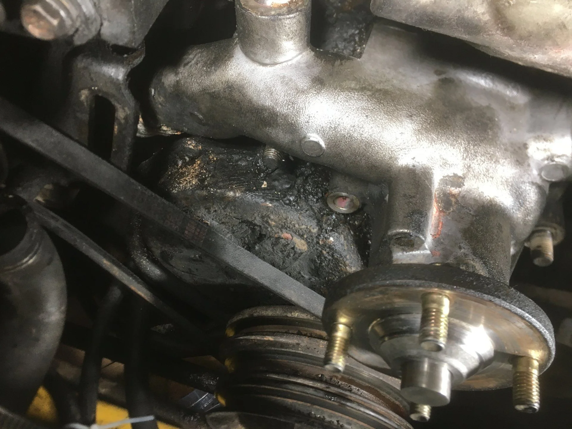

im having a heck of a time getting my water pump off around the studs that hold it in.
The main large outflow pipe where the water flows to the radiator seems to be wedged in behind the Mounting bracket for the AC tensioner, making it seemingly impossible to slide the water pump off the studs that it mounts to. How the hell have people managed this repair without taking the entire AC pump and its mount out?? My FSM makes no mention if this as a necessity.
PLEASE HELP!!
When I replced my FJ62's water pump several years ago I believe I removed the radiator hose sections from the bottom of the radiator to the water pump - the radiator's already drained, right?
Fj62 water pump is just below the rear main seal AFAIC on the :banana: scale of jobs... I have resigned to just removing the studs as a SOP for doing the water pump. As you’re finding, there just isn’t any other way, short of pulling EVERYTHING off the short block proper... you need to torque 2 nuts together onto the studs and then twist the stud out like a bolt... as I said, I gave in to it. SOP
Oh yeah, radiator is drained and that hose is free of the pump. The question is really whether there is any way to avoid pulling the AC pump and its mounting bracket off. Other people have mentioned they had to, but its Strange that the FSM doesmt mention that. Hoping there is another way.
Yeah, Lambcrusher. Looks liek either studs need to come out or whole AC deal needs to mcome off the block. I just dont see how i can get two nuts on that left hand stud in my oicture and then reach the bottom nut to torque the stud off.
Weighed my options and im moving forward with pulling the AC pump and bracket off the block rather that messing with the studs. I dont have the right nuts laying around for the stud removal job and for some reason am intimidated by the idea. Will update my progress for anyone interested.

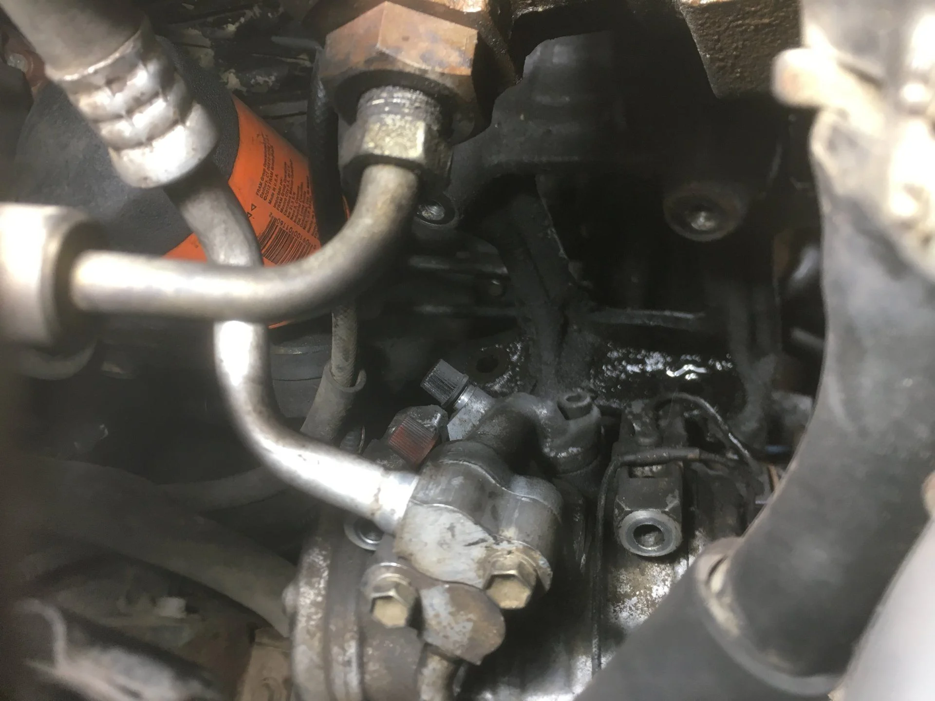

Took the AC compressor off and pulled it to the side. Plenty of slack in the lines to not require depressurizing the system thankfully. 4 14mm bolts. Not too hard to access them.
Took the compressor mounting bracket off. 4 14mm bolts. Also easy enough to access.

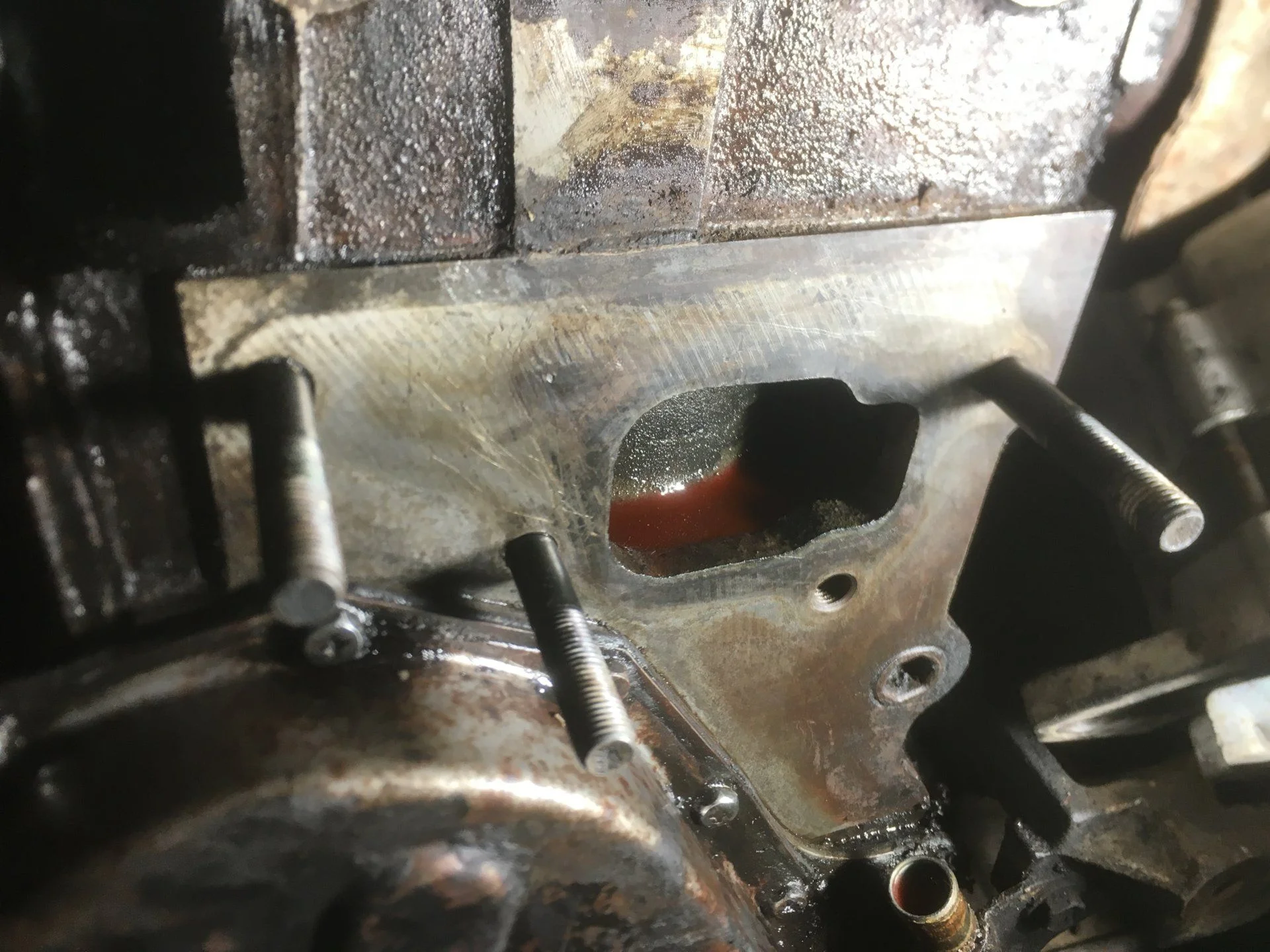

Once that mounting bracket is loose, the water pump has plenty of room to slide right off the three studs. Suprisingly easy.

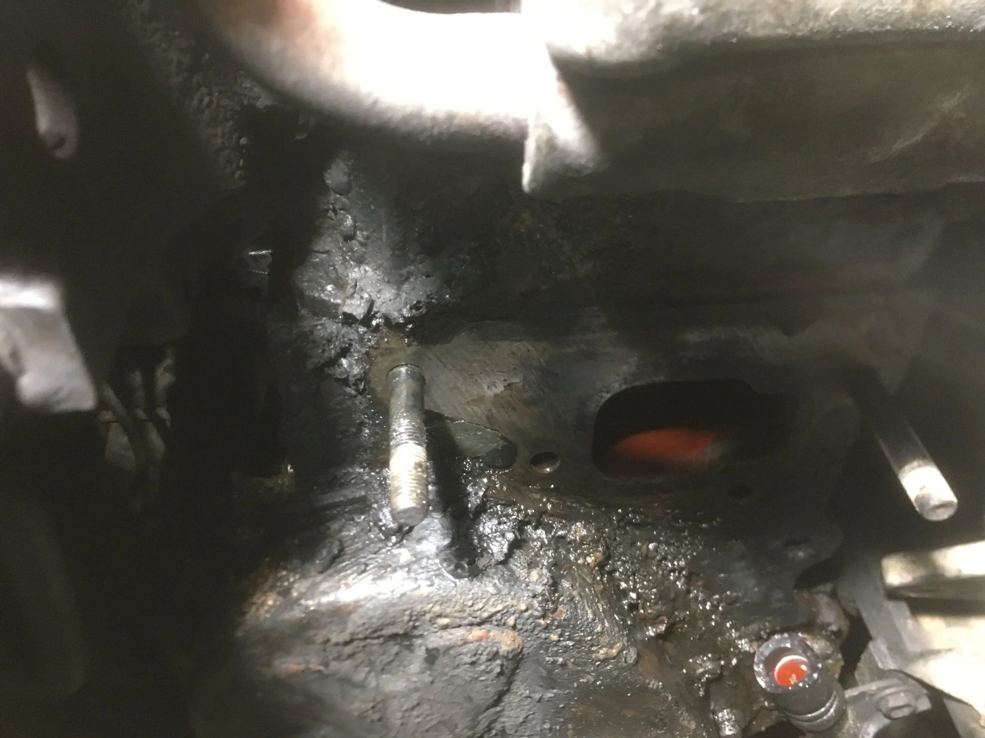

Next time I'd definitely pull the studs. One of mine came right out on its own as you can see in my pictures. You were definitely right that stud removal would have been less work, but it was not all that hard to move the AC stuff if you feel so inclined. Maybe 10 extra minutes.
