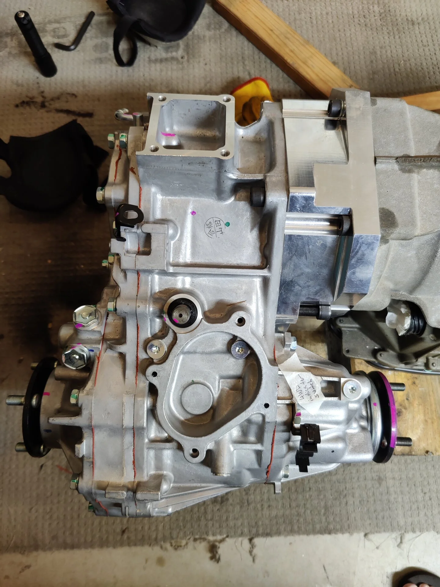

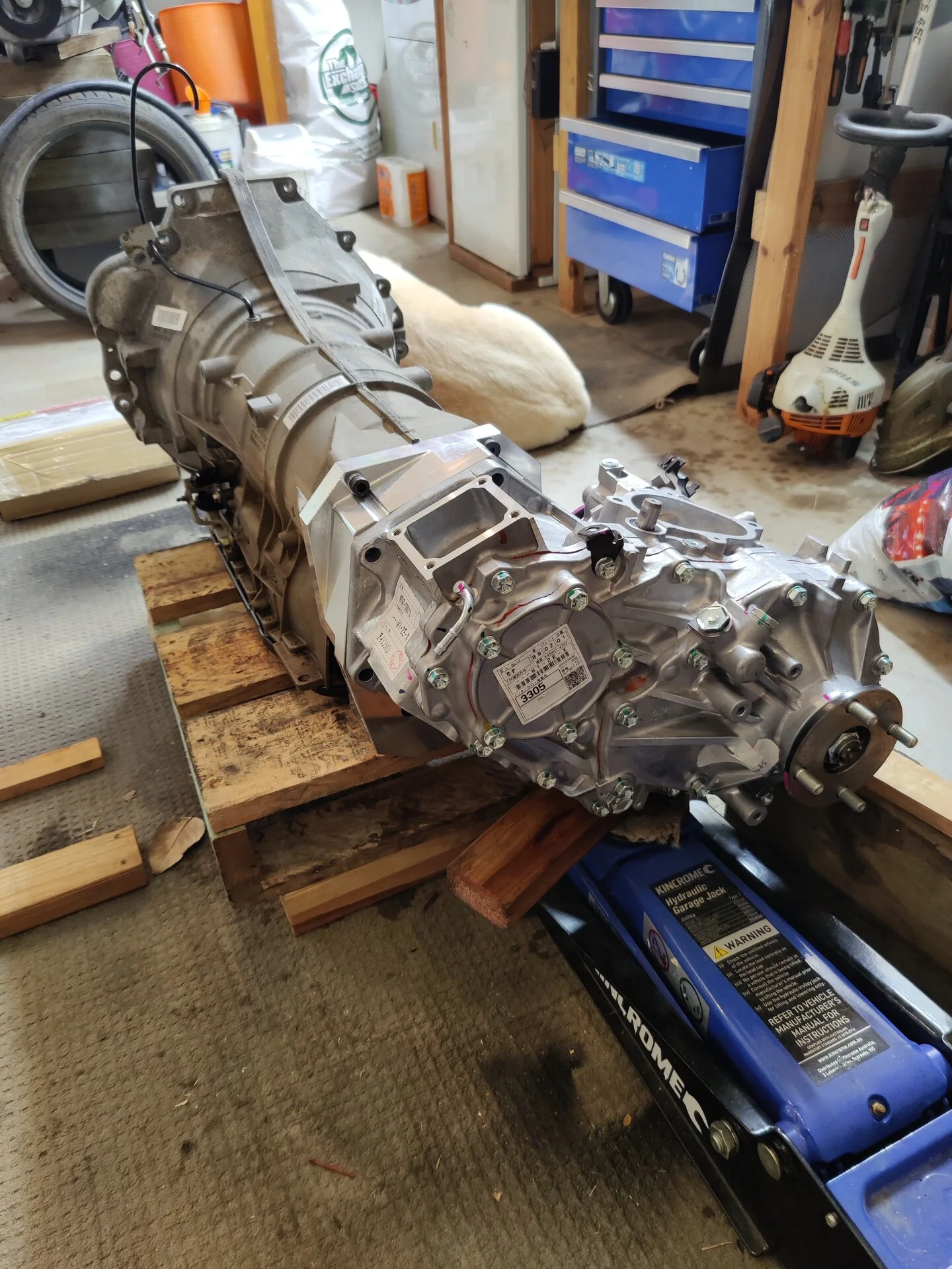

Incoming: a Ford FG Falcon in-line 6 cylinder 4L engine mated with a 6 speed auto ZF6 / 6HP26 transmission and a reconditioned 80 series part-time fully mechanical HF1a transfer case.

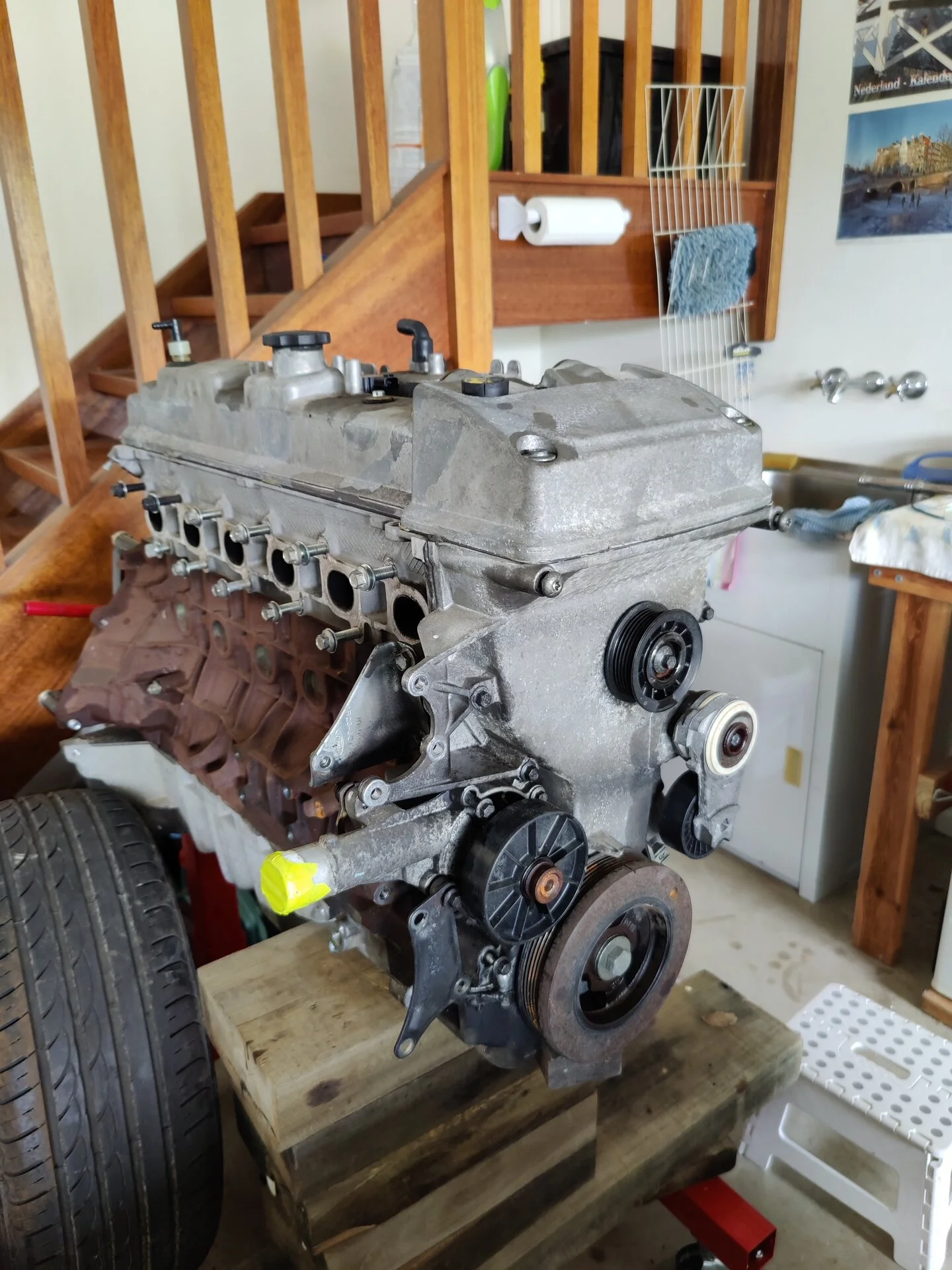

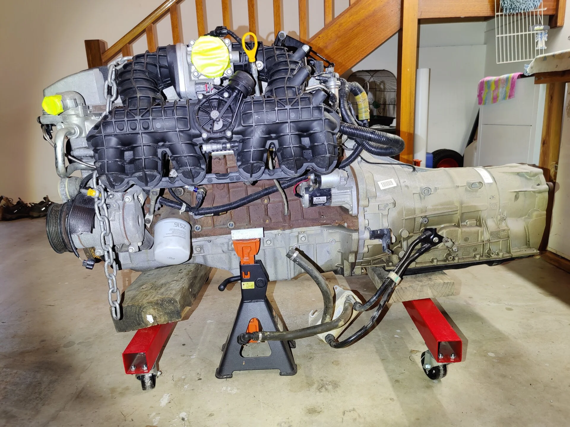

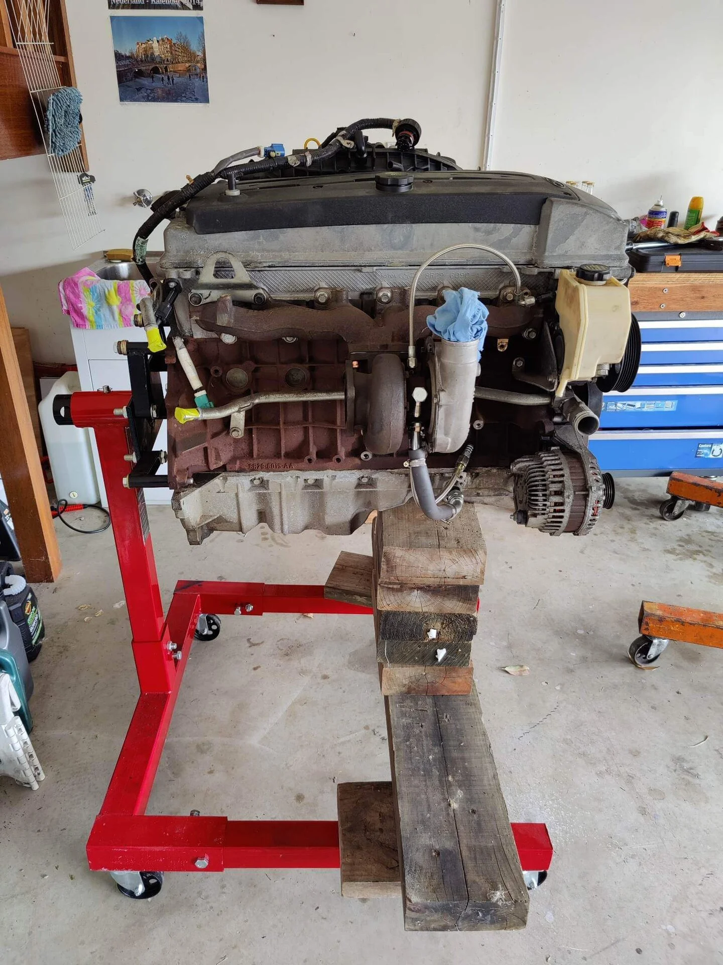

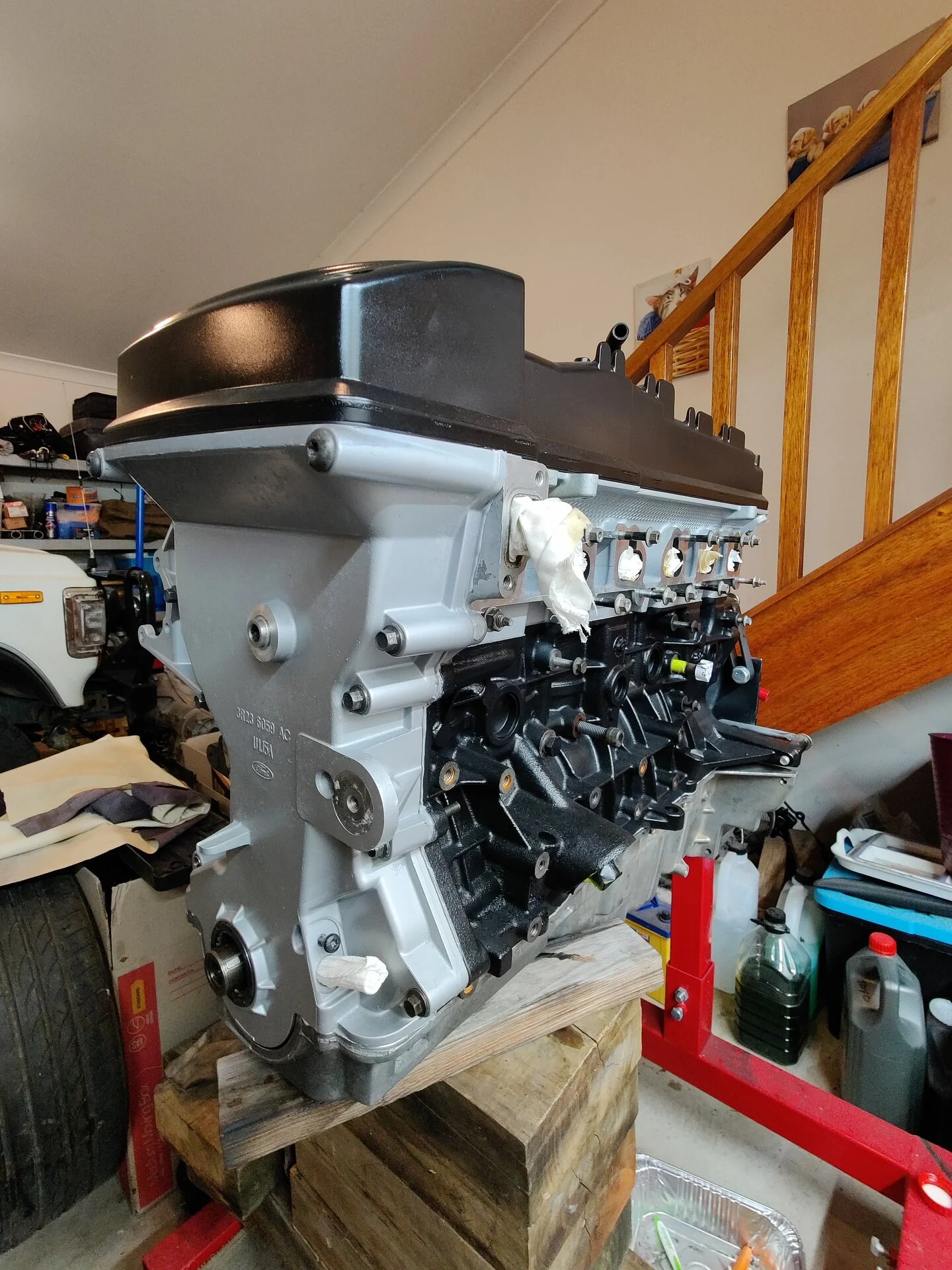

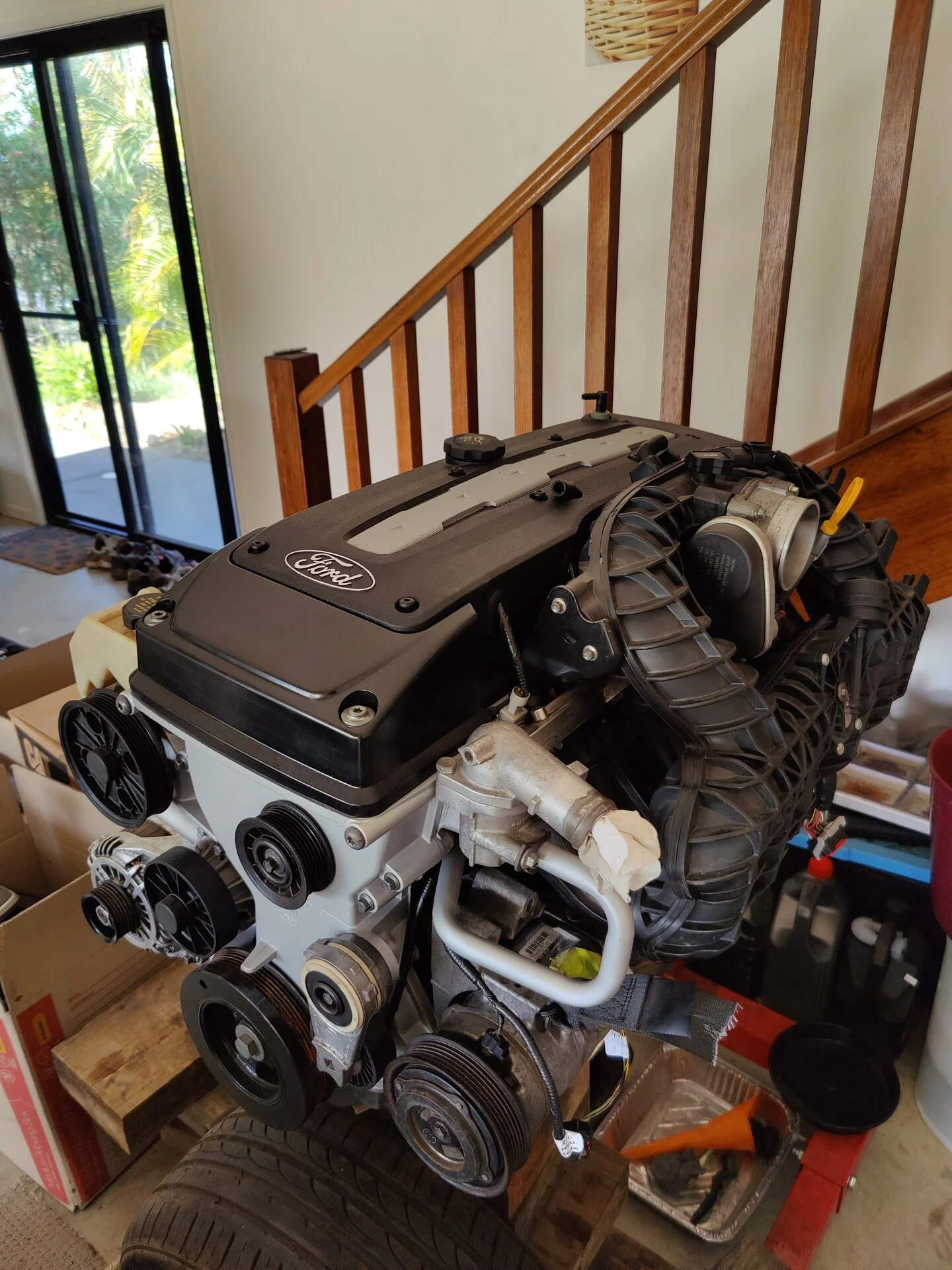

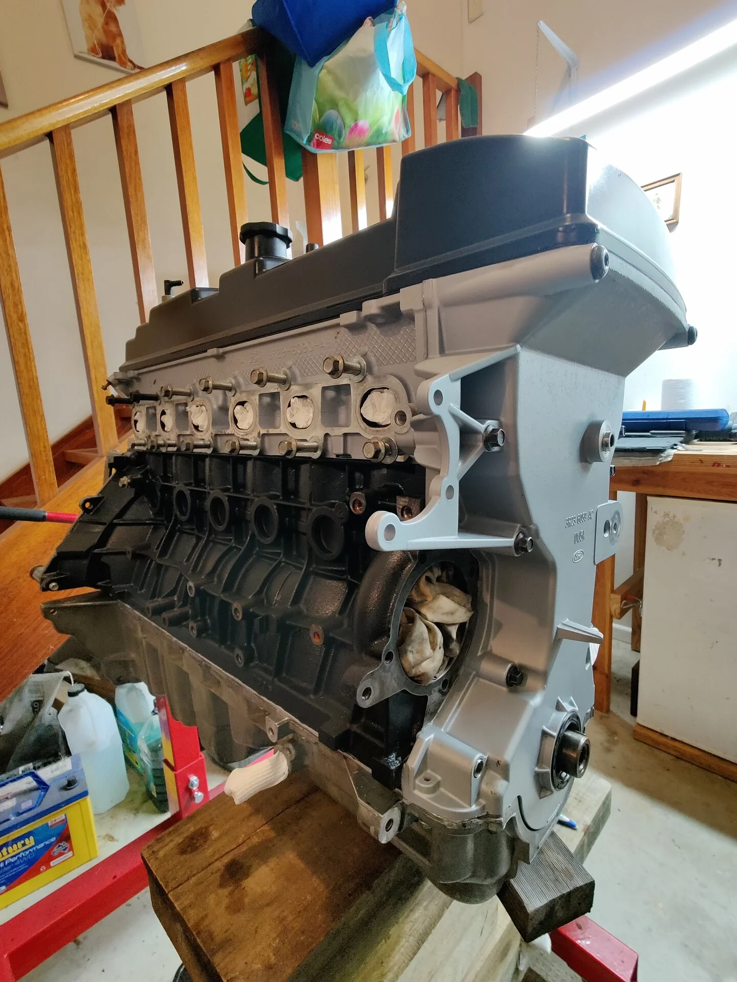

So far (since Christmas last year), I have been collecting major parts and getting my head around various projects. Engine has been cleaned, painted and serviced with common parts such as seals, gaskets, spark plugs, sensors etc.
Have removed the stock Ford transmission cooler (a water cooled heat exchanger on the side of the engine) which will be replaced by a separate air-cooled, thermostat-controlled B&M cooler in front of the a/c condensor, to avoid milkshakes.
No work done on the car yet, but some photos of engine as purchased and done up below. The turbo that came with the package will be abandoned as the engine is naturally aspirated and this little project just turns out to be pretty costly, complicated and doesn’t contribute to the reliability I’m after.
Currently collecting parts from the US including a Tanks Inc in-tank fuel pump set-up, transmission cooler, Lokar tiptronic shifter and gear sensor / indicator kit. A used Ford Falcon thermofan and 80 series tcase shift linkage being chased here in Oz.
am i the only one who's thinkin' he's doing this swap in his family room? :flipoff2: using the stair case as a reference. @Cruisunder, if you are, get after it. will be keeping an eye on this

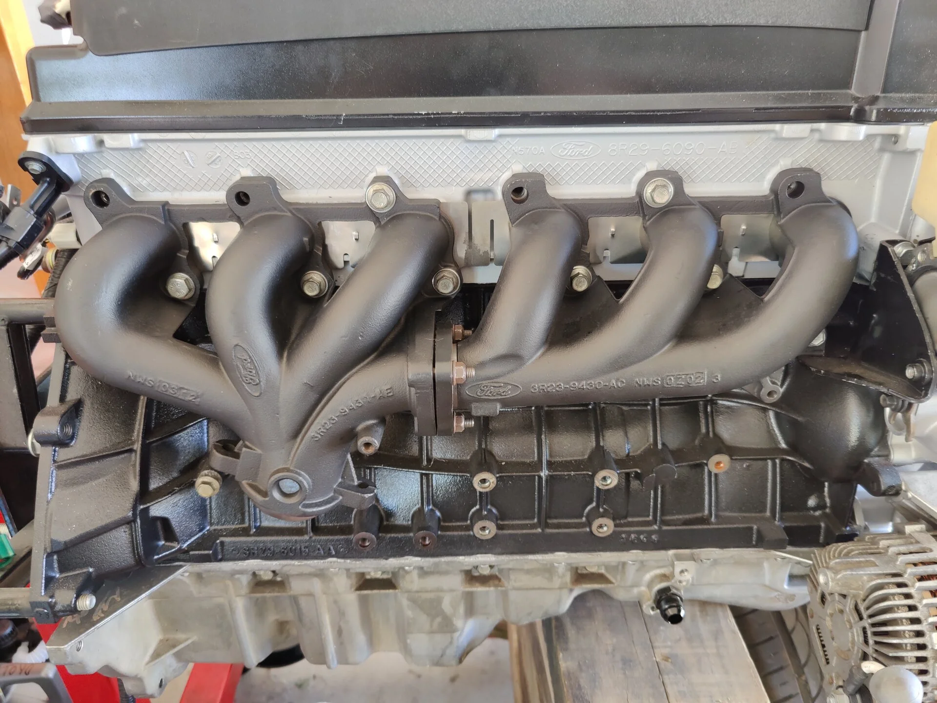

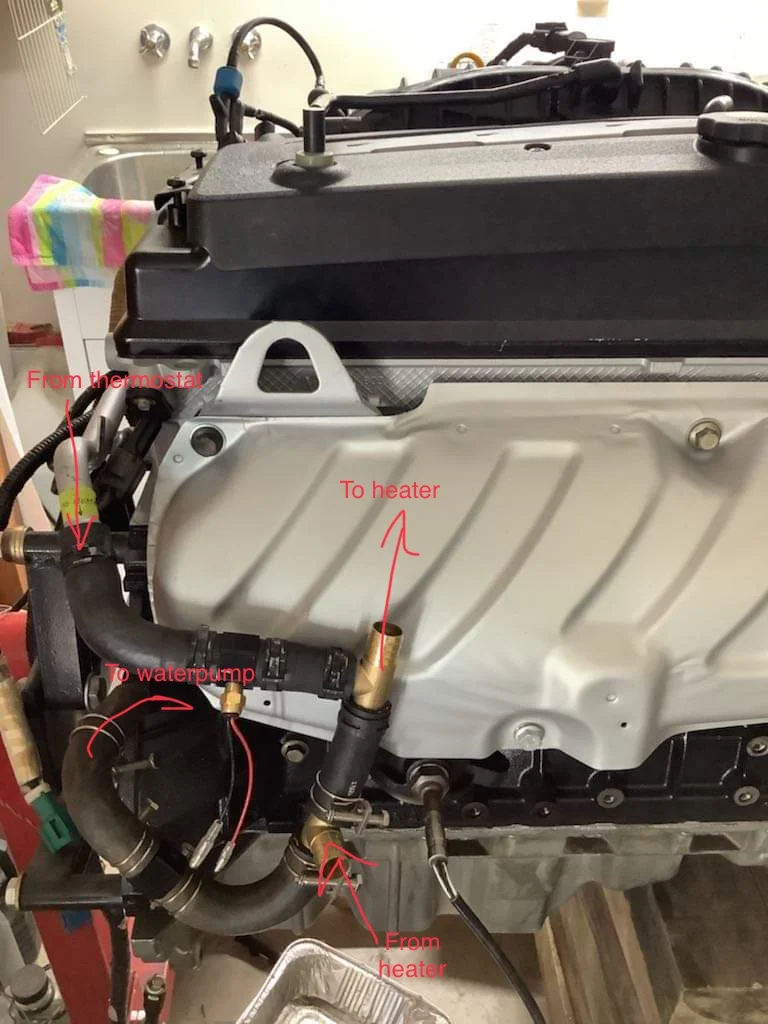

Made some progress on the engine, installing a stock na exhaust manifold and heat shield. Also sorted the heater hose coming from the thermostat bottom going to the water pump, with tees lined up to accept the Toyota heater hoses on the firewall. Included a “H” shortcut to avoid reported popping of the heater core due to higher flowing water pump.
Added an in-line temperature sensor that will be connected to a gauge in the cabin. Toyota sensor will also be hooked up but want a more accurate reading than the needle on the cluster.

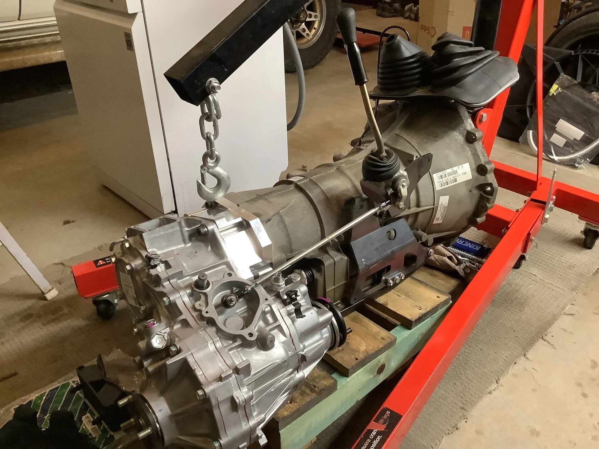

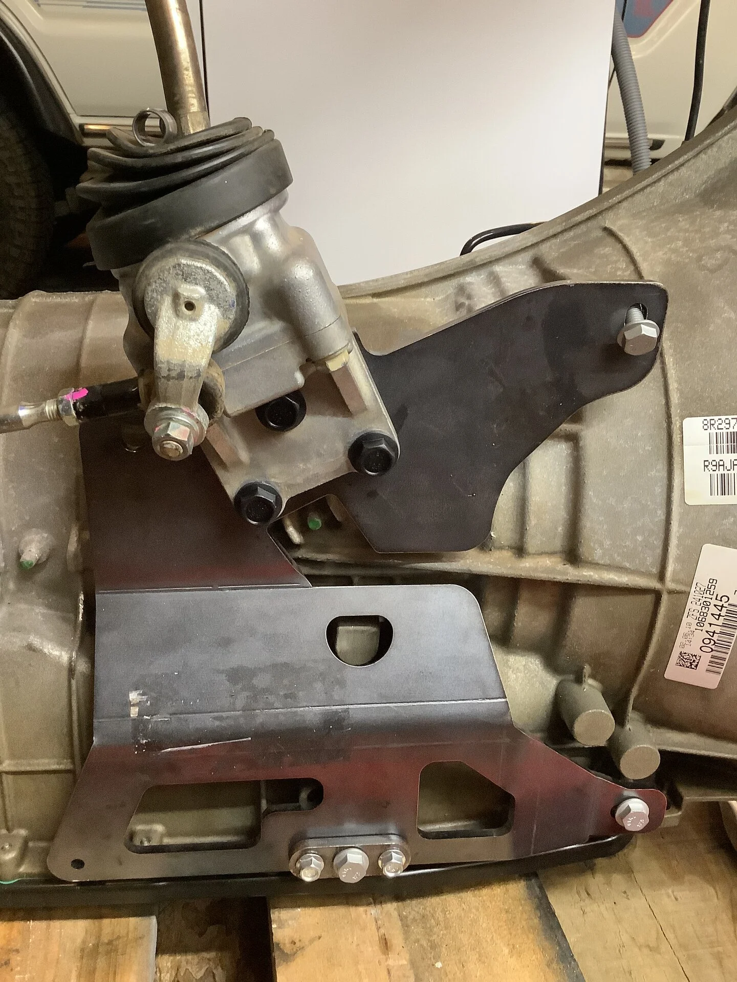

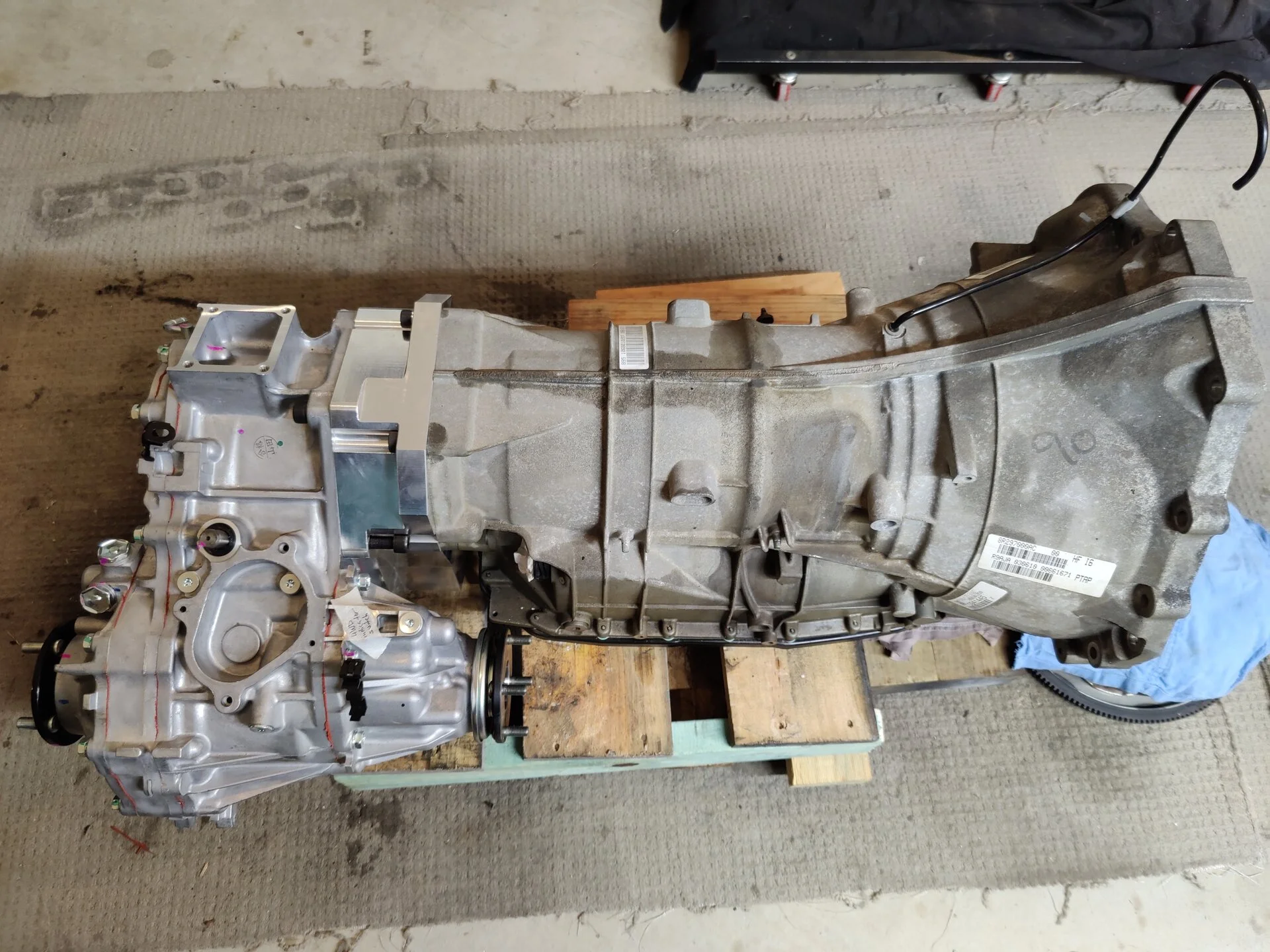

Other end of the drive line also saw some progress with a 2018 VDJ79 tcase shifter sourced and test mounted on a bracket attaching to the ZF6 transmission body. The bracket was made as a test product by a local business and seems to be nice and stiff and fits well. Thinking to build on this to help mount the Lokar transmission shifter.
Nice bracket
I'm wondering if that would bolt up to the 6r80 from Ford. Looks pretty similar.

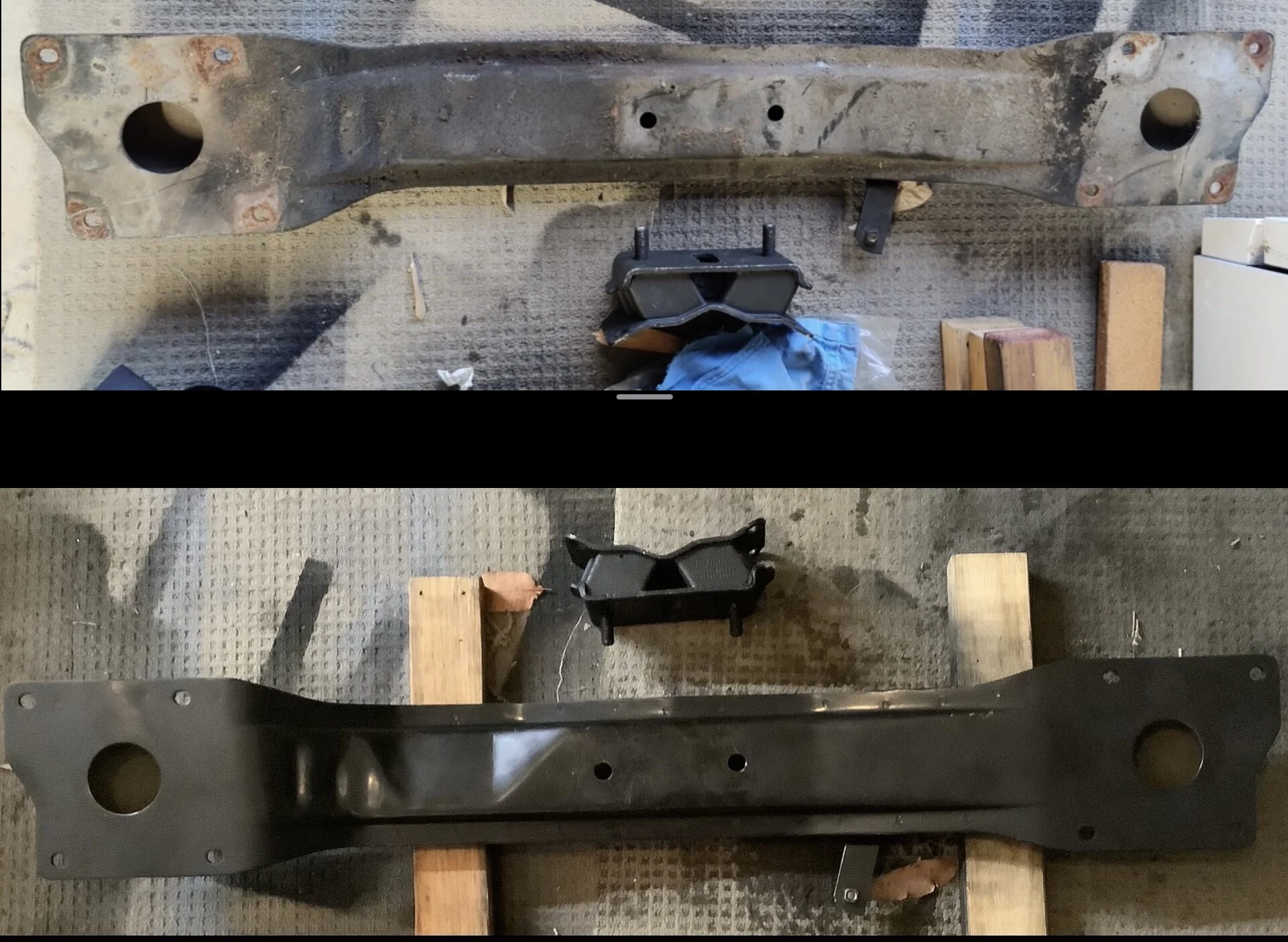

Sourced a 60 series auto crossmember which is about 100mm longer than the manual and can be placed further back between the chassis rails. Photos are just before and after clean-up and touch-up.

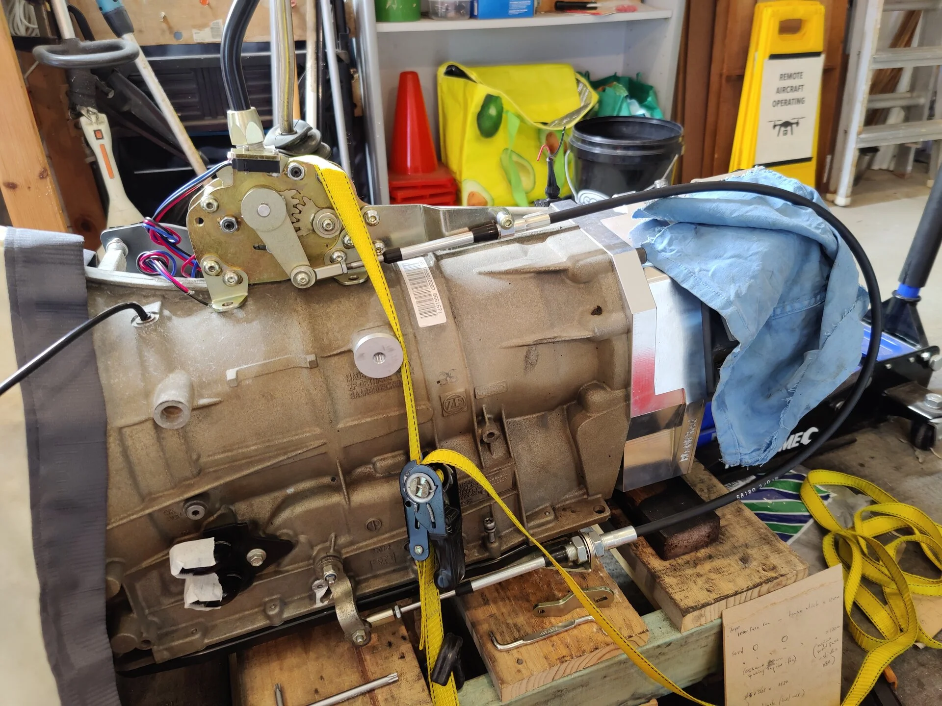

Meanwhile testing / setting up the Lokar shifter cable linkage while the transmission is out and easily accessible. Will post some photos next time.

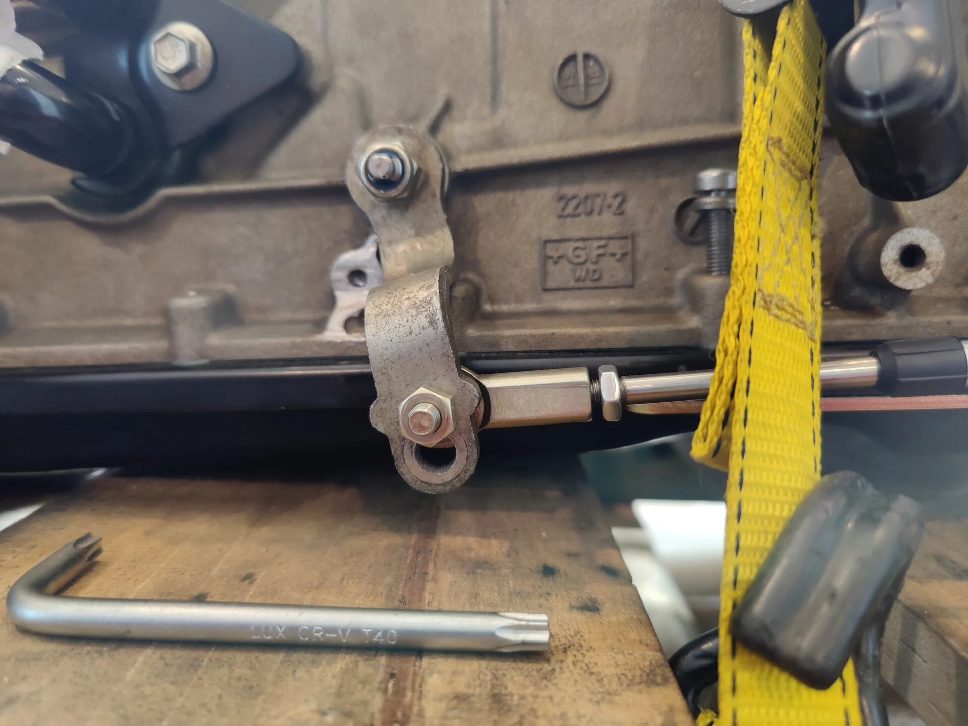

Made some progress with the shifter today. The Lokar shifter standard set up has the cable coming out of the rear of the shifter, so for that reason the transmission lever has to be rotated 180 degrees. To re-use the ZF6 lever which has a fair bit of sideways offset, I had to grind a little off the transmission cast body to give the lever room to move. I also shortened its arm by 4-5 mm to resemble the arm that came with the shifter. I had purchased the 6l80-specific shifter so I assume the arm length is designed for that transmission. I can't be sure but I'm thinking the pattern of the transmission shift shaft to rotate through PRND is pretty similar for most transmissions. Similar enough to make me happy with the test shift anyway.
