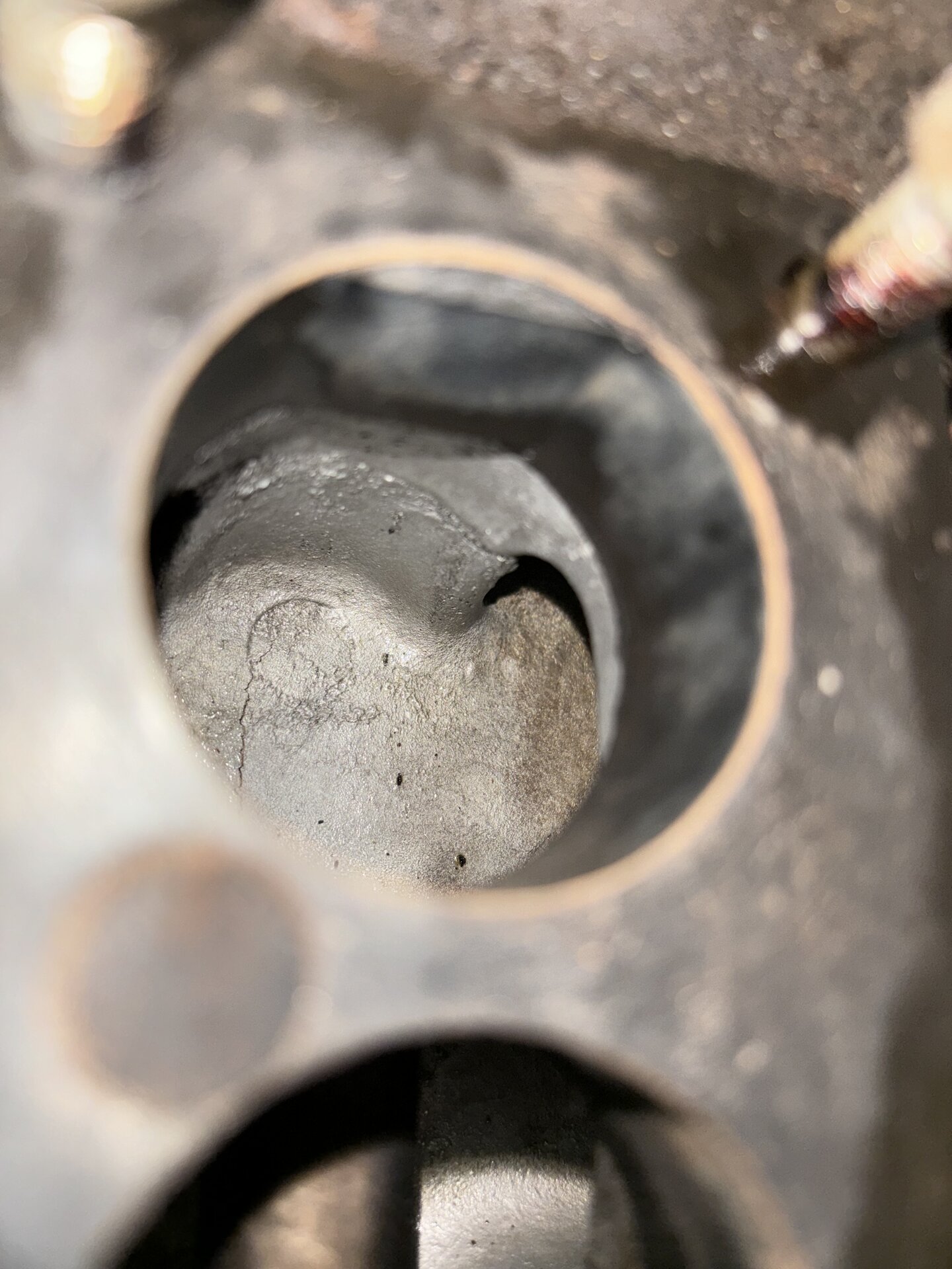

Realized I hadn’t updated this since. Ended up patching up the crack in the manifold. All new gaskets everywhere. Carb rebuild. Went ahead and Desmogged while I was at it. (Lots of smog parts available if anyone’s looking).
Truck is running great. Holding idle and whatnot. Seems like there’s a few flat spots in 2nd and 3rd. Guess I need to dive into timing now. Is there any way to avoid recurving the dizzy? Also, what changes are made to the carb with Desmog?
