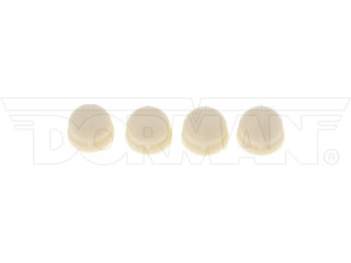

Hello Everyone, resurrecting this thread ... have an HJ60 and the arm keeps coming off the motor ... any idea where I can get a bushing to keep it in place?

I used a generic bushing I got from NAPA and it has worked for me for several years.
It’s not a perfect fit and Requires some modification, but seems to have worked fairly well for me.
NAPA part 6003505 - comes with 4 so you can afford to botch one or two or have a few spares..
I believe the modification is drilling the inside of the bushing so that the wiper arm ball can fit inside.
The wiper arm ball is not perfectly round, there’s a large ‘pin’ and the modification is just getting that pin to fit in the bushing.

Thank you will try that and see if I can get it to stay ... any resistance and the wipers stop working...

FWIW, this part is DORMAN 49451 ... $12 at NAPA ... $2 everywhere else.
