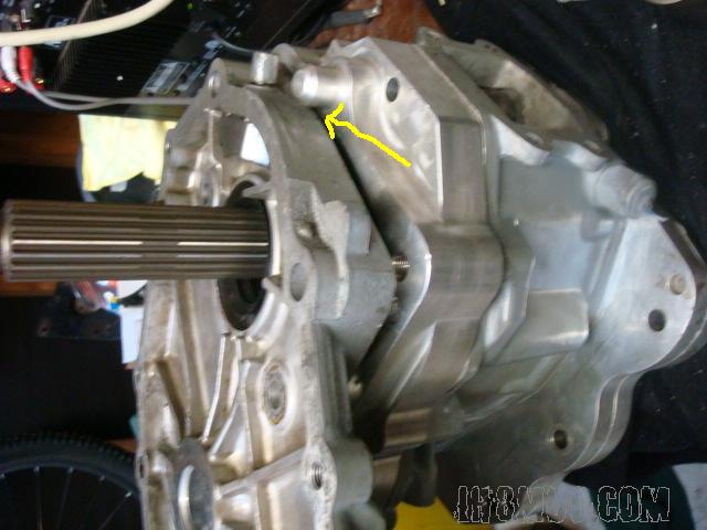

I picked up a used toybox for my 60.
I am having trouble piecing it together.
I can not seem to attach the flat part of the split case to the back of the toybox.
ideas?
thx in advance
Howdy! Hard to tell how much interference there is. If its 1/8" or less, I would grind it down to clear. Are you sure that the Toybox is not designed for the older solid case? John

I thought Marlin included a little jig for grinding the case a bit??? Not certain since I've been UNABLE to get my hands on a Toybox:mad:, but i think that extension holds the base of the shift rail.
Yeah, that knub houses the shift rail for the toybox.

Is grinding required to mount the split case?
Am I putting the piece on wrong?

Is grinding required?

That's how it's designed. Mine is milled for the shift rail.
You can grind it or have it milled. It doesn't take long to drop an end mill into the case and it looks a lot cleaner than hacking at it. with an angle grinder.

So, just have a machine shop"mill" it here?

I just used a dremel to grind mine down with a lot of test fitting. I used bolts to line the t-case housing up to the transmission and marked where the t-case housing needed to be ground. It wasn't very difficult, maybe a little tedious.
My toybox is #1 with a sm420 and split case. I am now running a sm465. You have to grind it down or mill it like freds 40 said. I believe marln might of had a templete for it not sure. I think a dremel was a good idea.
I didn't know you had to mill the split case down to get it to fit a toybox.
Before you reassemble the case I would advise drilling a hole in the Hi/low shifter arm to shorten the throw (assuming you're going to run twin sticks). Also consider rotating the arm like freds40 and I did. Here's a pic. I should have drilled a hole in the middle before I installed it.

How long is the throw without drilling the arm? 8 inches or so?
Huge, because you have the length of the arm on both the twins and the case to factor. Mine was almost completly front to back when I first mocked it up.
