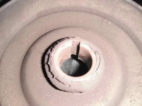

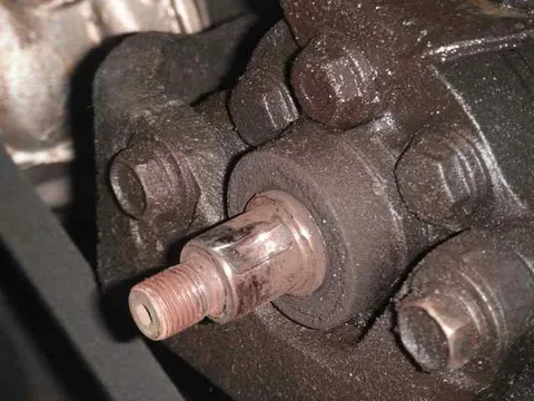

I don't know squat about p/s pumps, but it looks to me like the shaft and maybe the pulley are toast. Hard to see in the pic of the pulley, but the left side has been bored out a little.
A piece came out/off when I removed the pulley. It was the "guide" on the shaft to align the pulley.
What are my options? Can the shaft be replaced?
yes, you can replace just the rotor shaft. problem is that basically it is going to require a complete tear down. might as well rebuild it then with all the parts out. the vane spring assembly is insane to put back together. i rebuilt mine a year ago and is fine so far. i have one from hugh that i need to rebuild. maybe he will sell it to you. i have the rebuild kit already. most 60 guys as you know upgrade the pump anyways so it might not be worth it.
