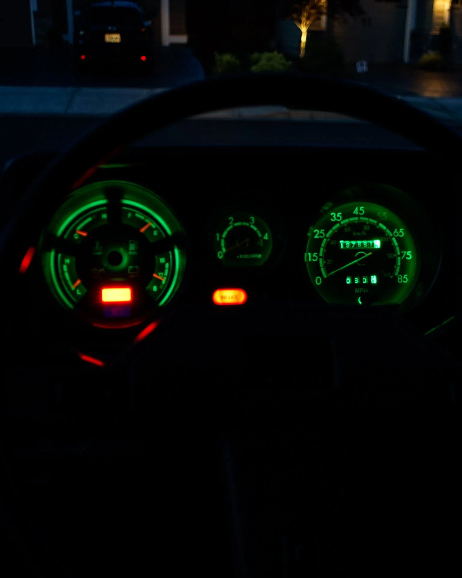

Just did the dash of my 60 and used 4 194-RHP5 in red for the gauges, 2 194-g-120 for the turn signals, 3 194-r-90 for brake and seatbelt and charge, 1 194-b-90 for the high beam, 1 194-g-90 for the 4 wheel drive, and 1 194-a-90 for the choke. The turn signals and high beam are not too bright. Hope this helps.

Cool, have a photo of red lights in the cluster? does the needle dissappear? considering this.
Anyone retrofitted a dimmer switch? im super sensitive to bright clusters, get aggressive right away.
This should be a good service if you get the brightness right.
When I did it my blinkers were nearly blinding and I had to partially cover them.
The high beam light is a bit intense too.
Purest won't like it but I went with red for the night vision aid.

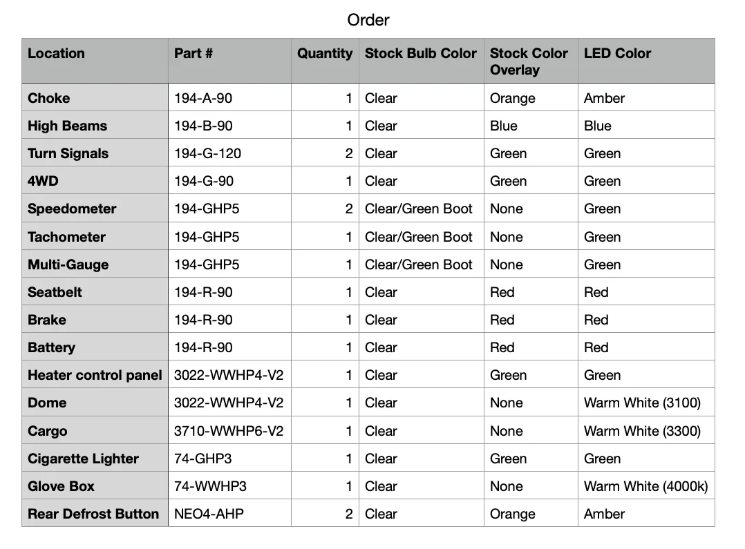

What I ordered for my interior retrofit from SuperBrightLEDs is below. Just finished up and my observations:

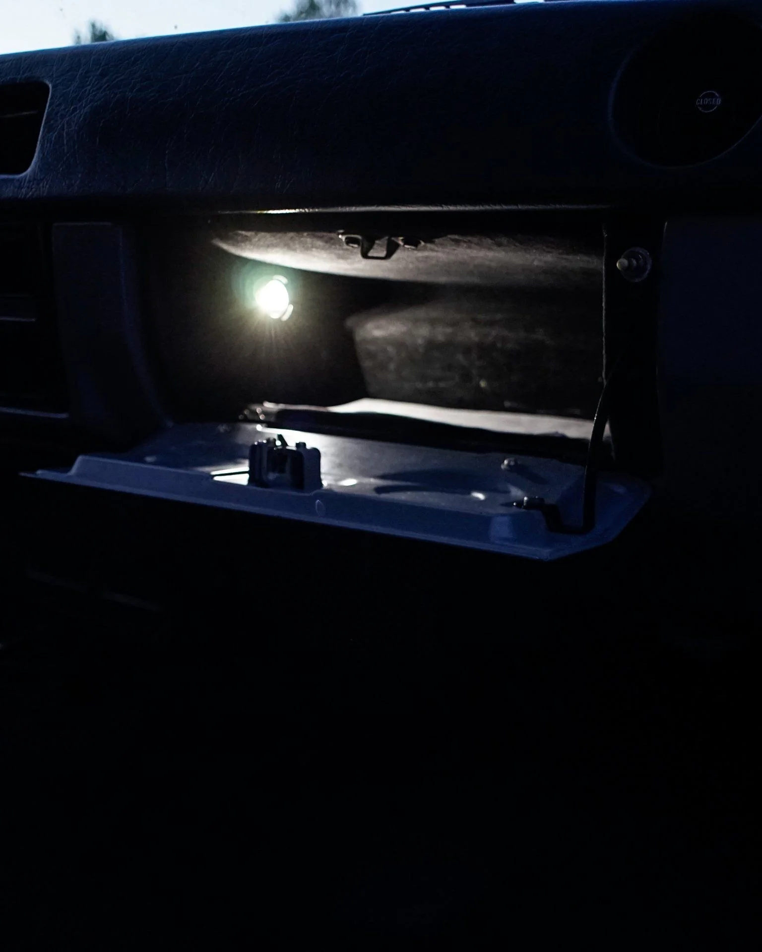

  • The dome and cargo lights are wonderful upgrades. Very happy with their increased brightness and color (I think a tad less yellow then OEM which I actually prefer).
  • The green color for the cluster backlight is substantially more green then the original LEDs, enough so that it doesn't feel that OEM to me anymore. I kinda want to address this but not sure how. They're also really bright, haven't driven at night yet but might look at one of the dimming options.

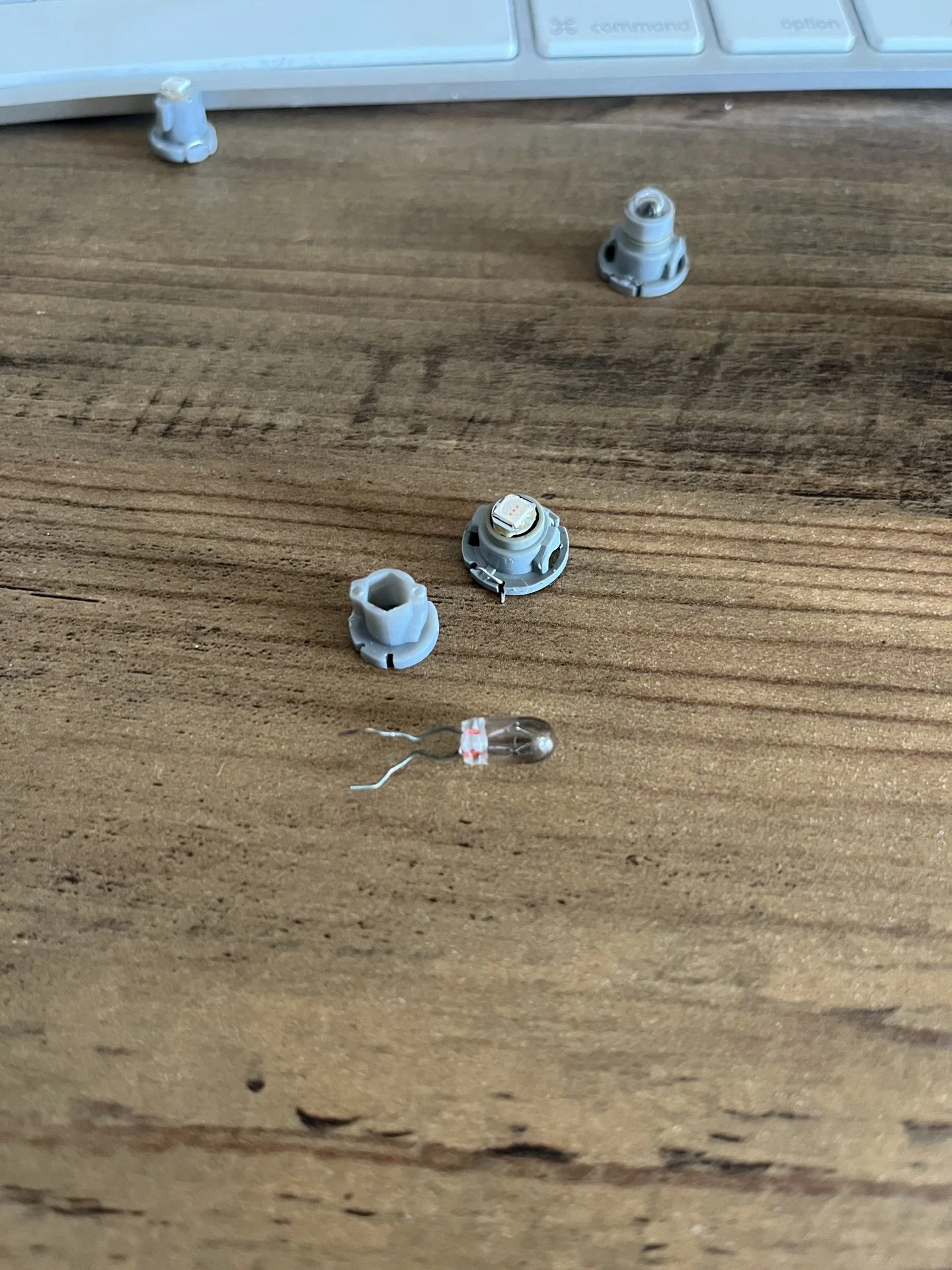

  • I had to re-pin the rear defrost button LEDs onto the housing that goes into the button... NEO5 size (5mm) may work better. See pics at the end of this post. For some reason they're the only LEDs not working for me though, so... maybe I got something wrong. The NEO5 are noted as polarity sensitive (unlike the rest of the LEDs on this list I believe) so I need to try flipping them around as a first step.

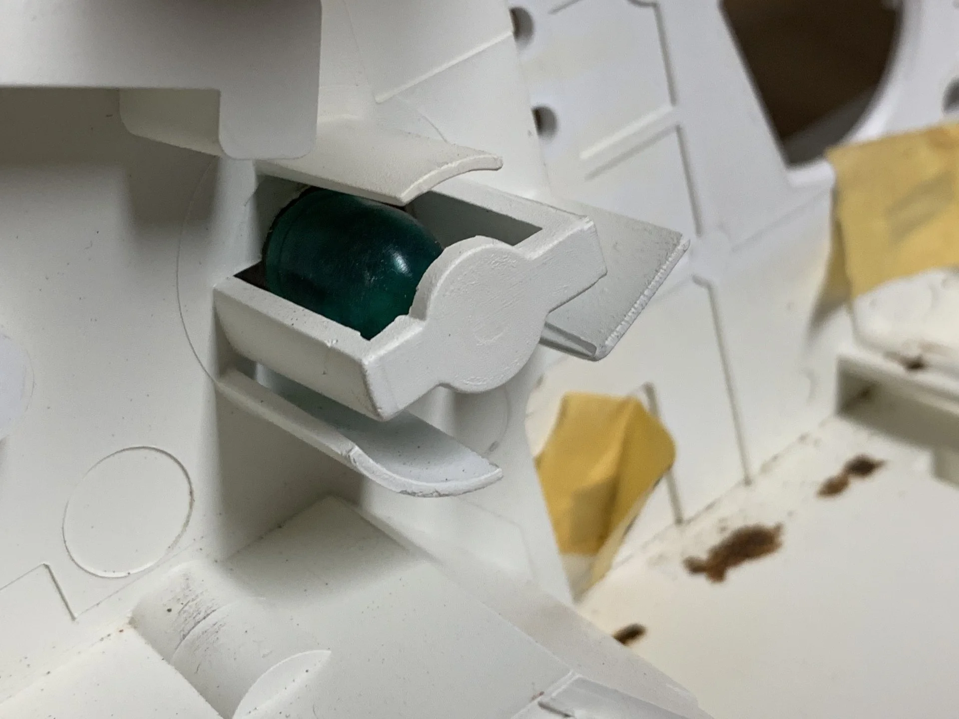

When using the 194-GHP5's on your clusters, do you all have a plastic guard/shroud that blocks direct output from the light bulb? See photo below. Have you modified/removed that if so? The 194-GHP5's just barely don't fit in my sockets because of that plastic.
I used NEO5 and they fit fine.
NEO5-GHP (Green) in bottom of the defrost button
NEO5-AHP (Amber) in back of the defrost button
NEO5-BHP (Blue) in for the AC button

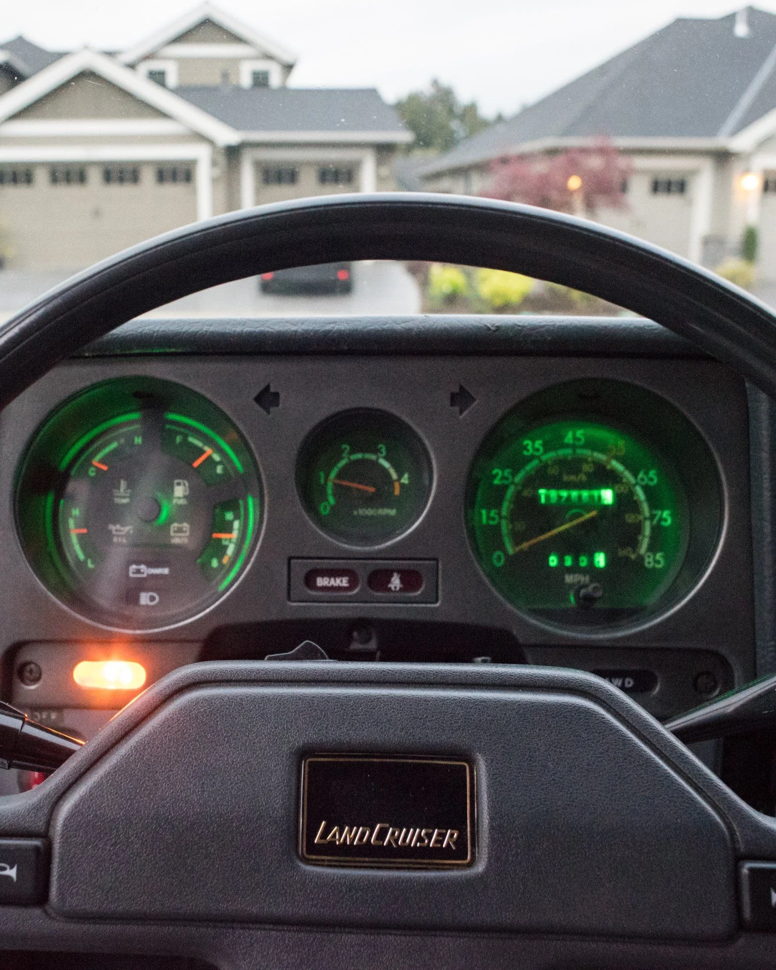

I just swapped out all of my old light bulbs in my 1986 FJ60 Landcruiser for some LEDs from Superbrightleds.com. Instead of writing up an excel sheet list here's a shared cart with everything I got that you'll need:
Just add everything to your cart and check out (let me know if this link breaks and I'll update). You'll be left with a few extra bulbs for the dash. This should have all the light bulbs that will keep the stock light colors (speedo, choke, climate control, ect.) plus reverse lights, taillights, turn signals (you'll need to add a light resistor to combat hyper-flashing). Just don't have the driving light bulbs/high beams as I will be going with the cityracer led headlight assembly.
Also, for the dome lights I decided to go with a conversion kit from oddironoffroad, but the dome bulbs should be in the list above I just don't plan on using them:
Dome light conversion kit:
I haven't installed these just yet put I'll post some updates (hopefully this weekend).
Some photos installed:
