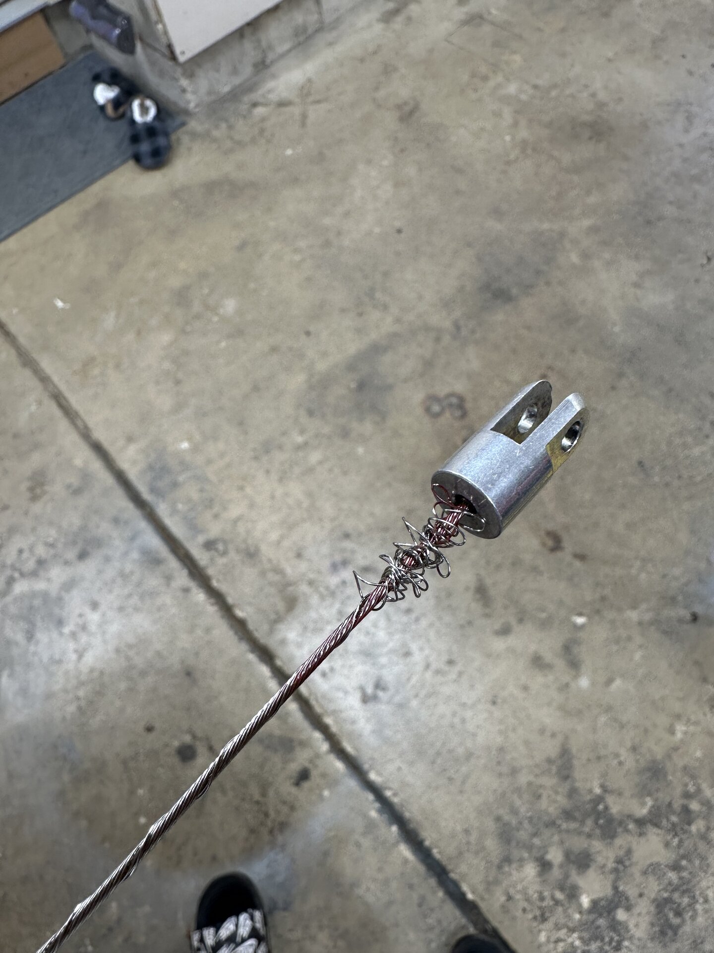

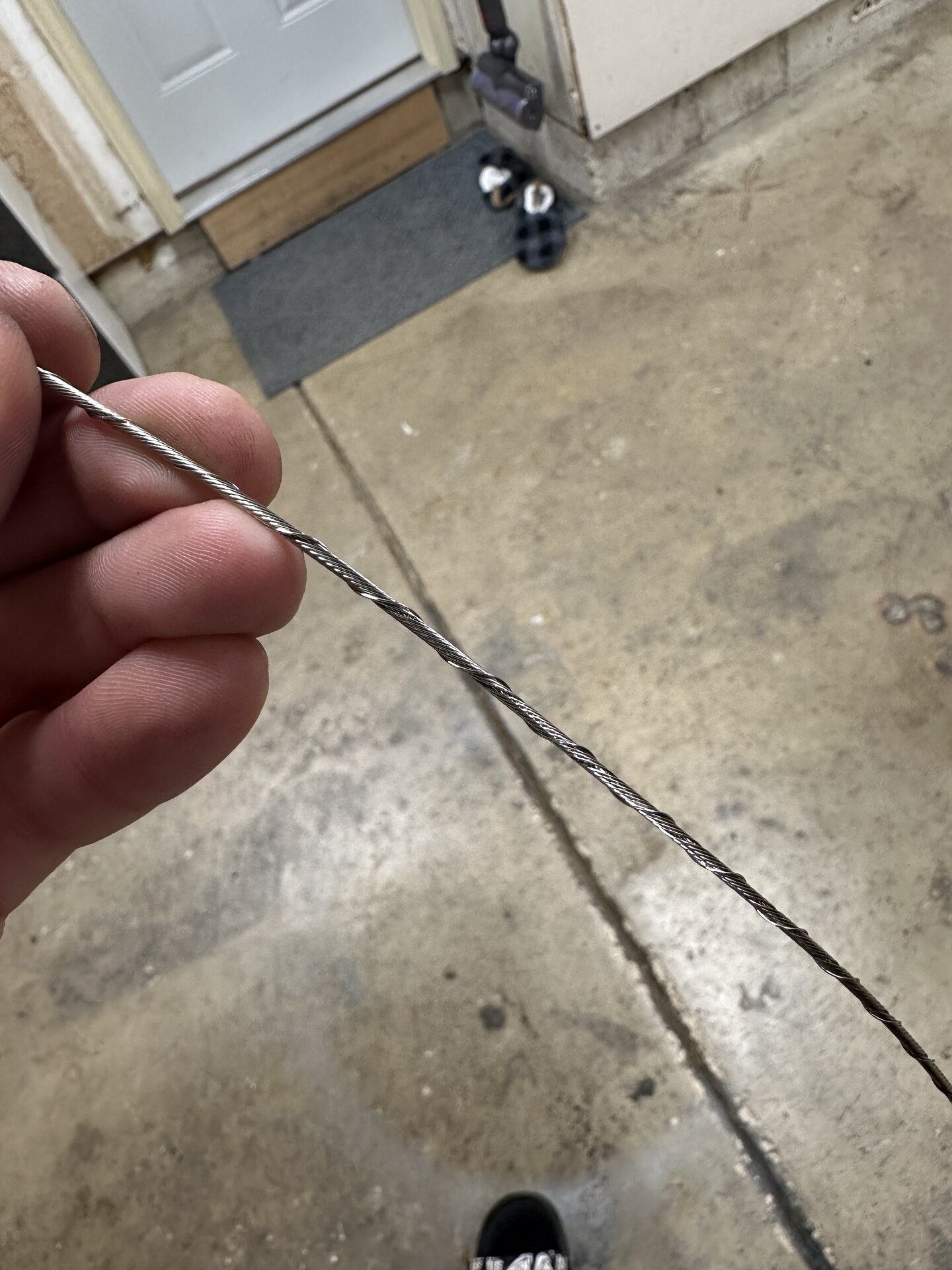

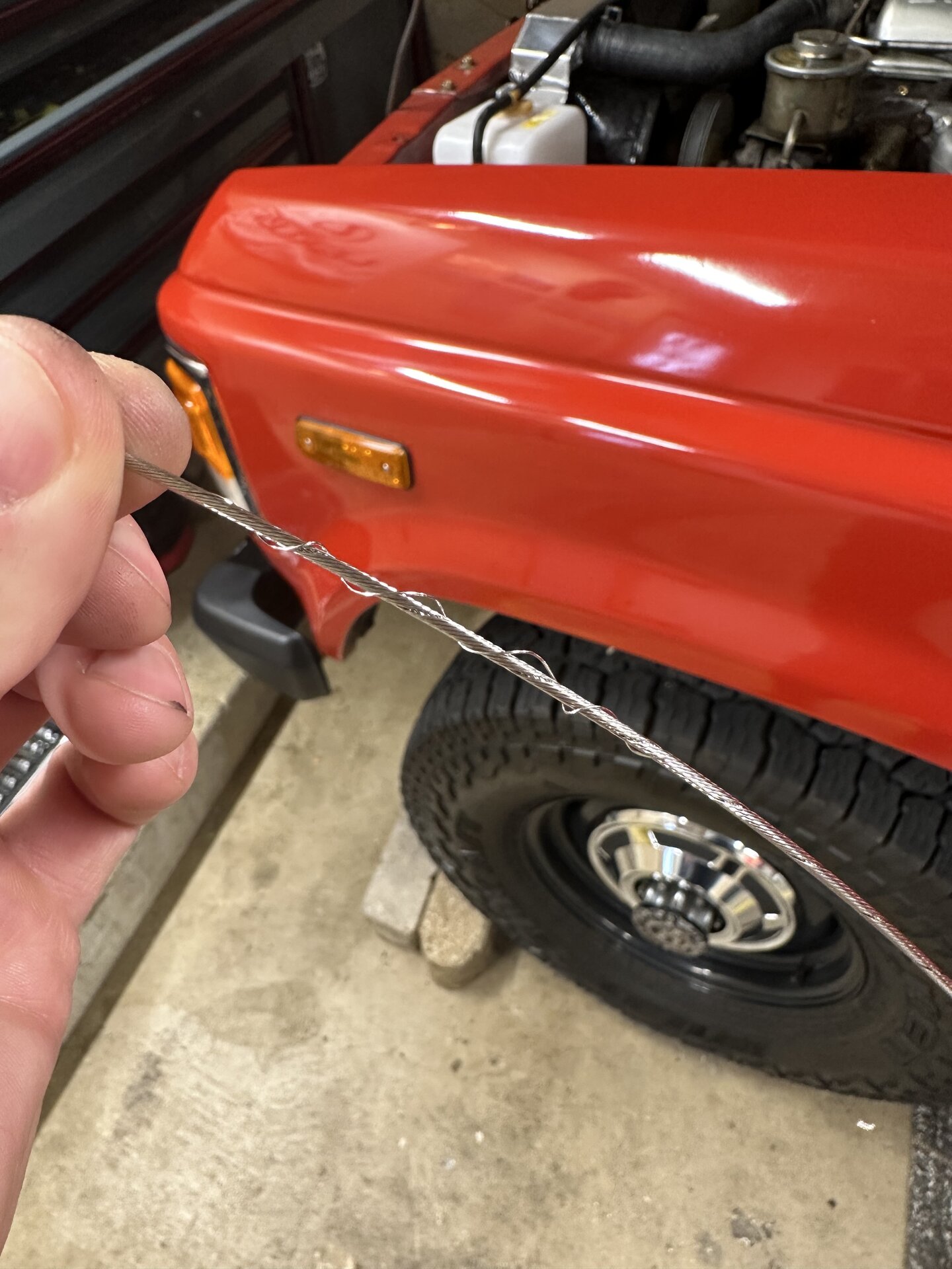

I ran into an issue with my Lokar cable fraying on my Sniper setup which caused exactly that concern.

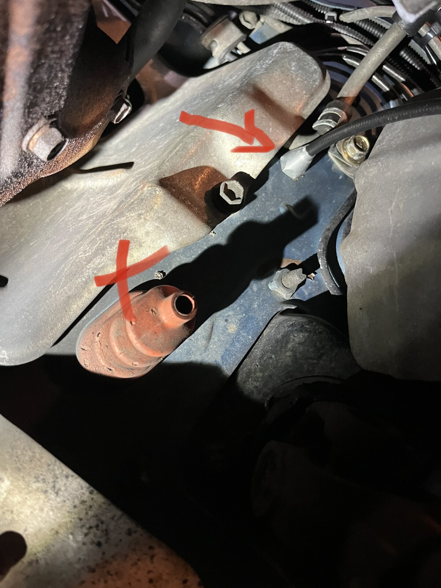

Very confused but looks like the throttle cable was deleted and moved up here?

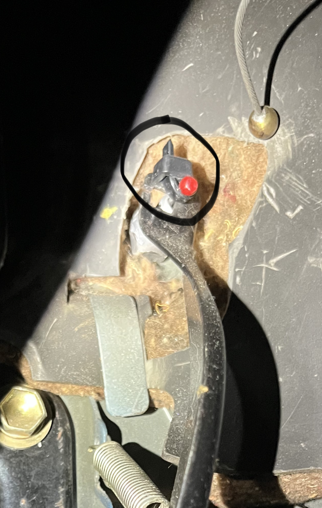

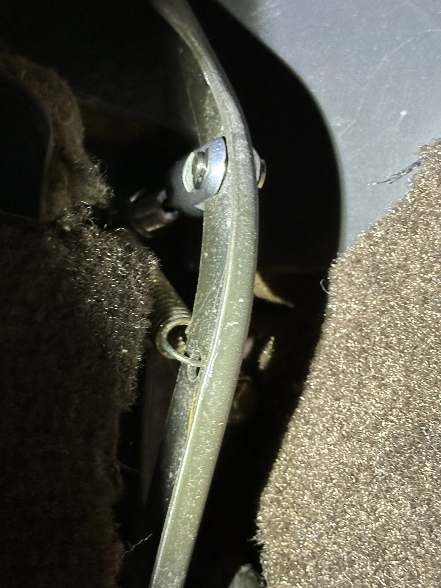

I can’t figure out what’s going on with the zip tie pic, but this pic is normal. The OEM rod/linkage setup is removed when the carb is taken off. The new cable is then run from the pedal to the sniper. That is a lokar cable, same brand that gave me issues.
Edit: I figured out the zip tie pic. Whoever did it did it differently than I did but if it works it works.
Can you put your foot behind the pedal and pull “up” and get the idle to come down?
