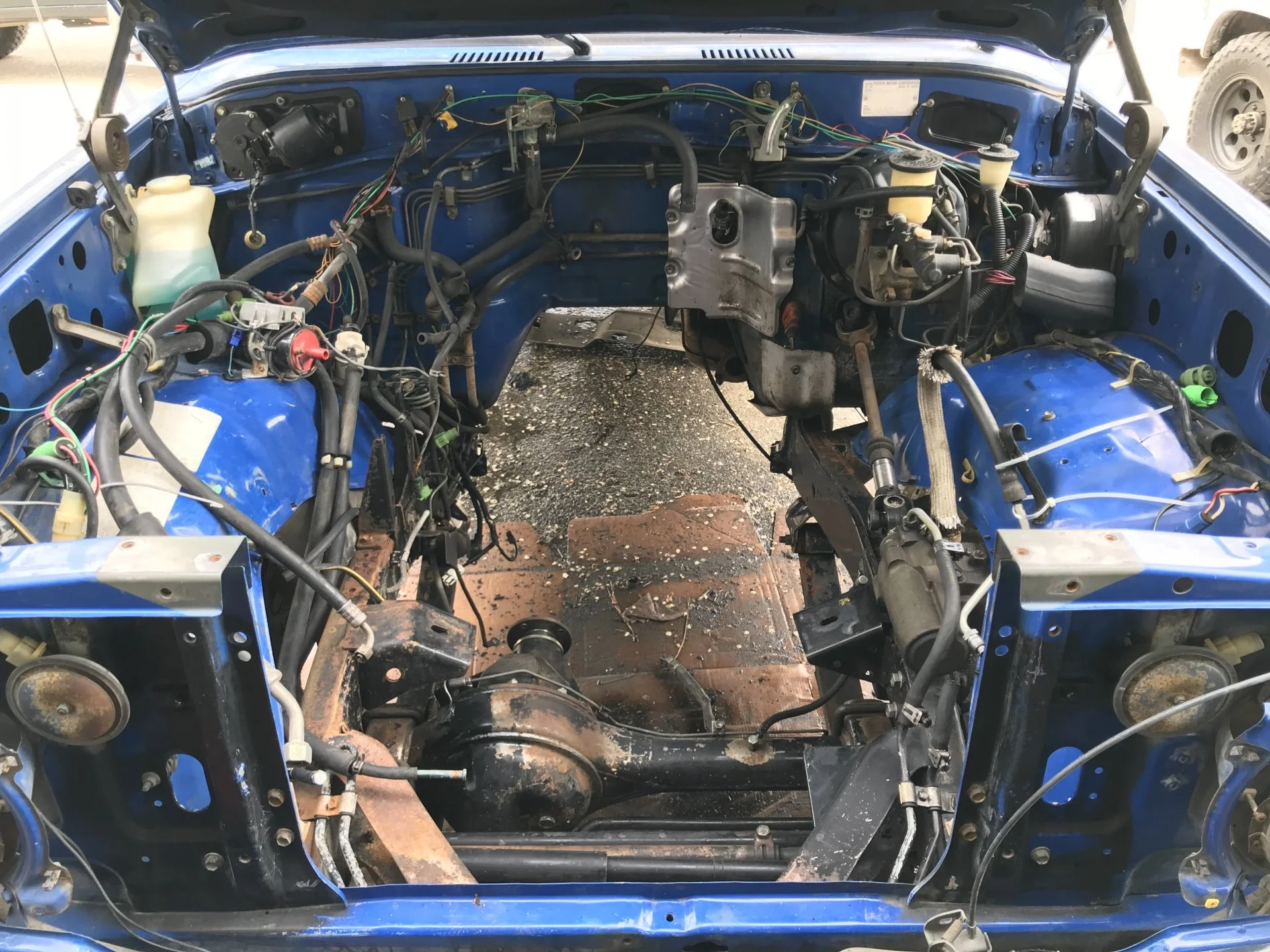

This is a pretty nice 1987 FJ60, its been off the road awhile and came to us with no engine. The owner had been eyeballing it for years before he was able to finally purchase it.
We went around about engines for a few months, an EROD was finally selected if crate form. From the beginning the owner wanted a manual trans and it really wasn’t up for much discussion. So we went with the NV4500.

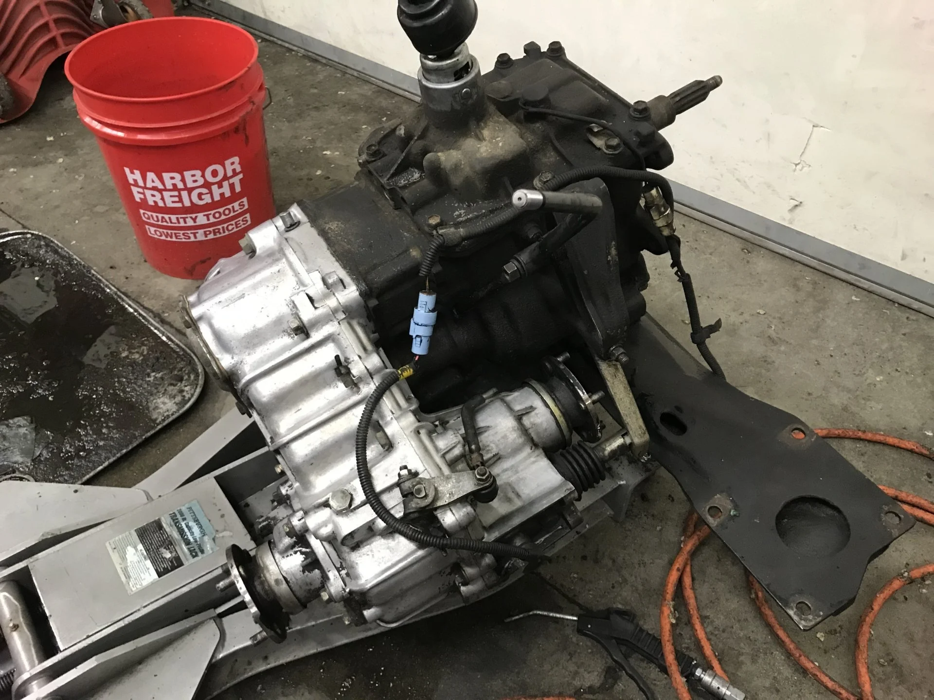

Stock trans was still in it when it showed up at the shop so we pulled that and cleaned it a bit.
We also cleaned the engine bay and frame rails, this was before we pulled a bunch of stuff out of our way.

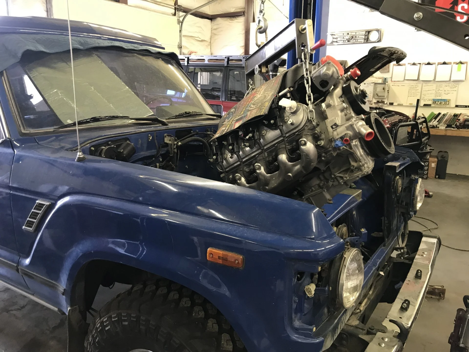

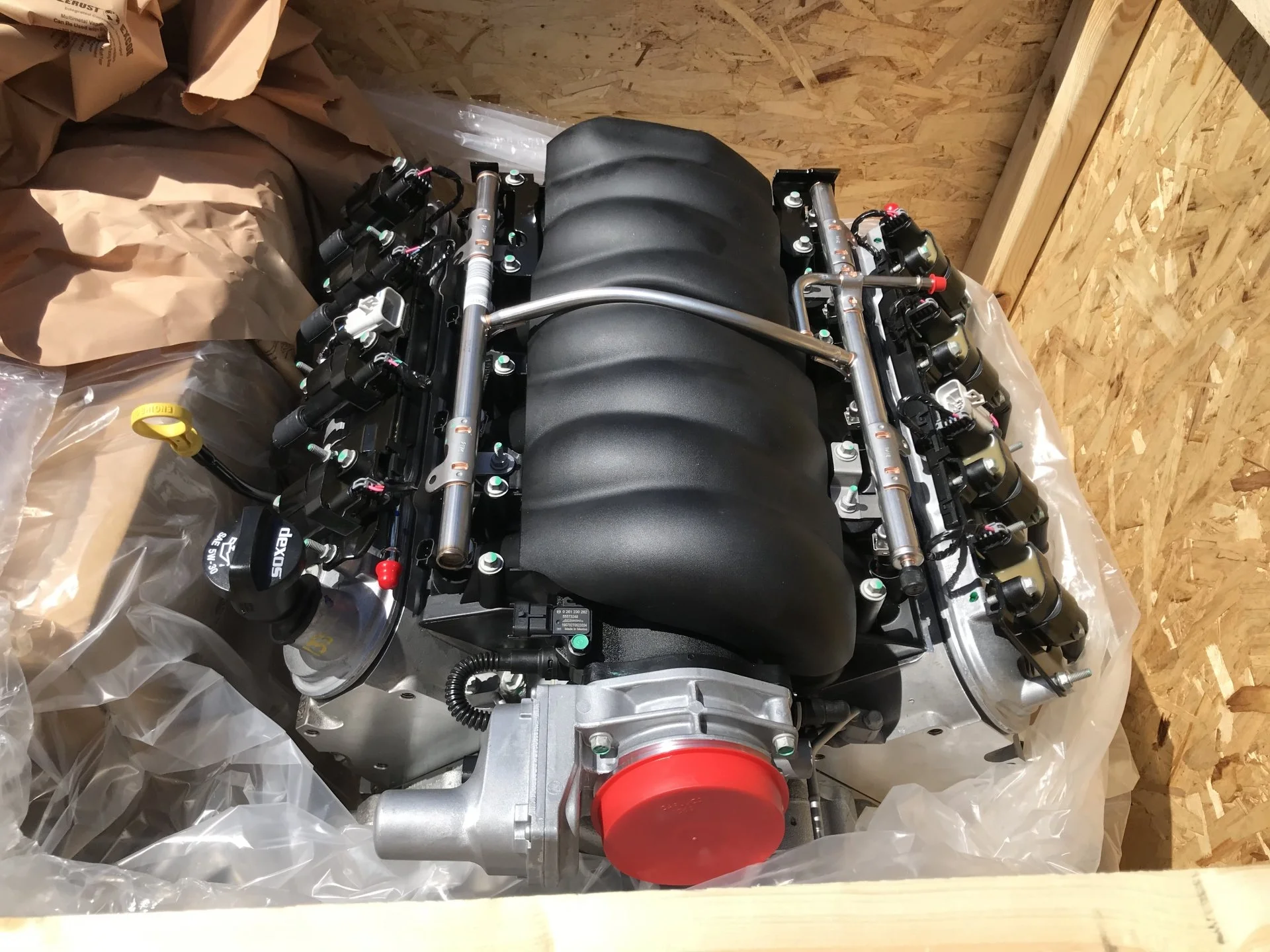

The EROD goodness.

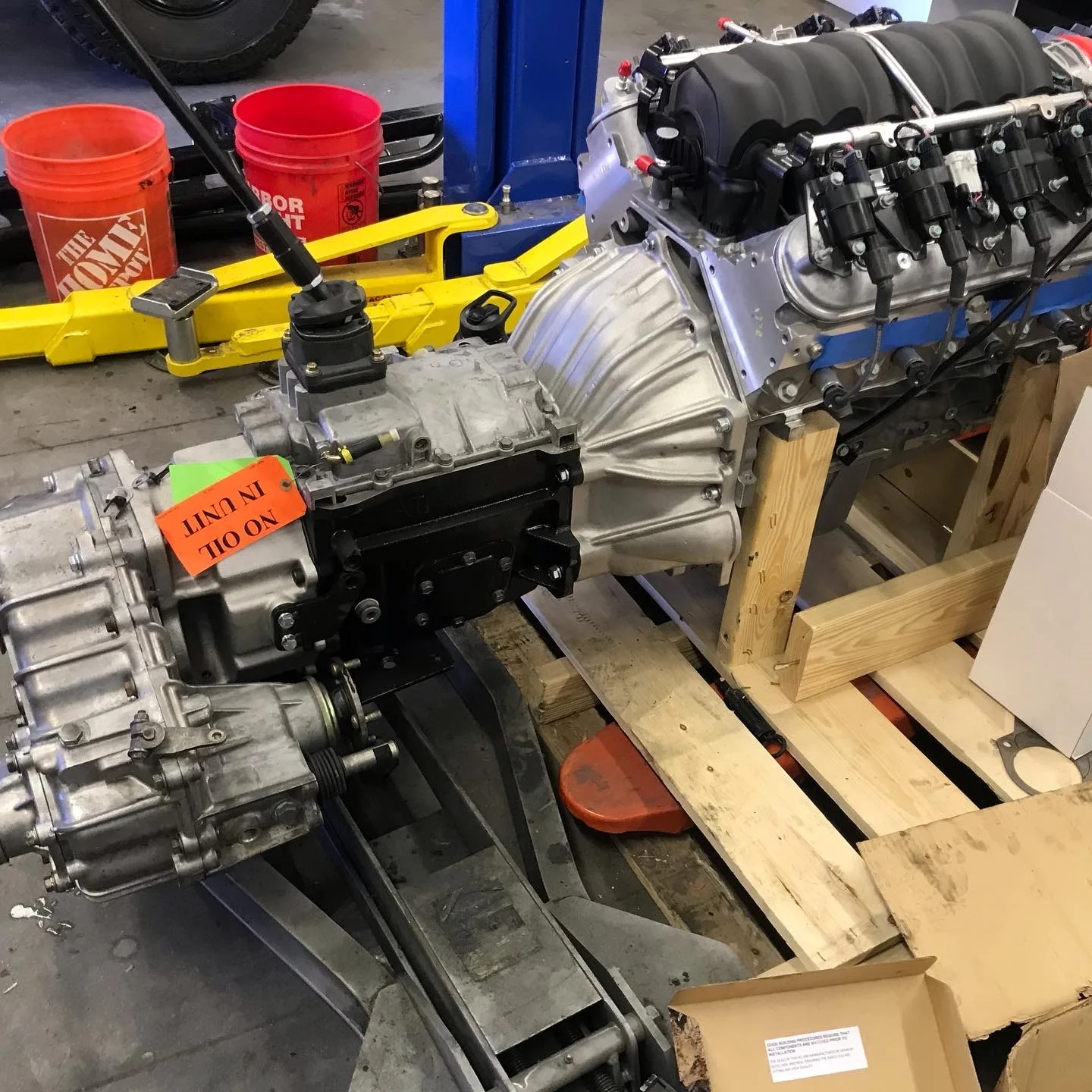

Used the AA adapter, is there even another available? Little disappointed with a few things with the adapter but hey no worries. The tcase shifter adapter required mods and the clutch slave will as well. Besides that not to much dramas with the adapter kit.

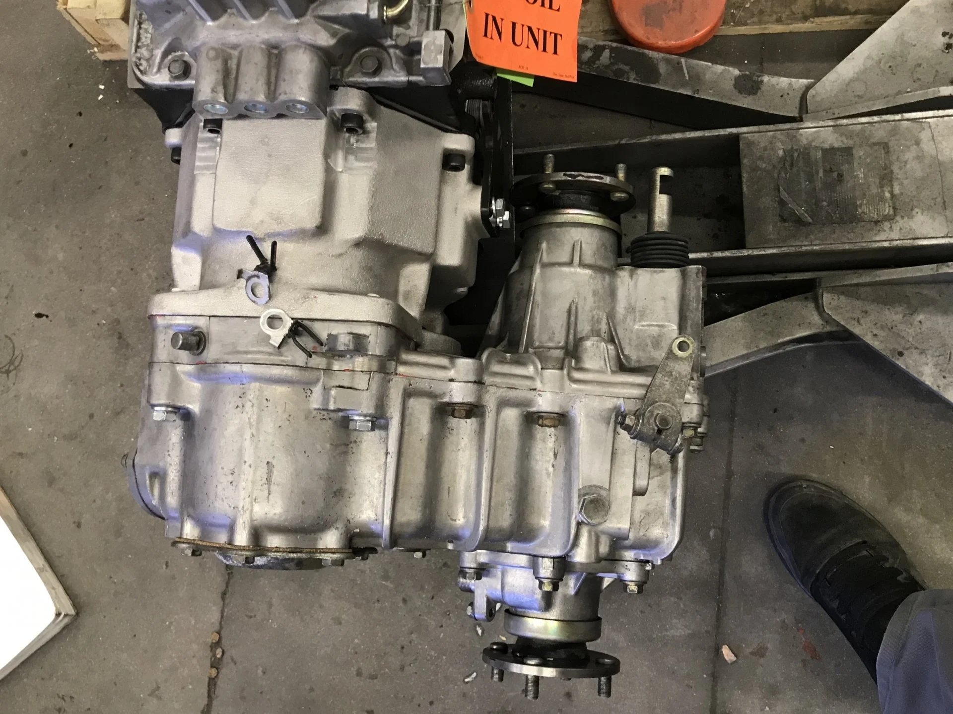

Tcase was rebuilt to standard.

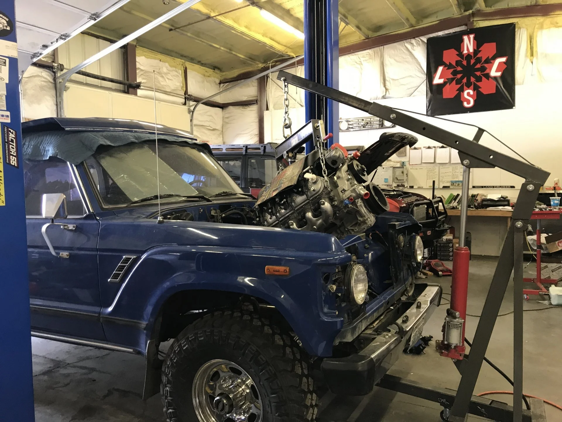

Once that was done we did some more prep before stuffing the powertrain in.

it seems like every Advance Adapter product always includes at least a little bit of disappointment in some way

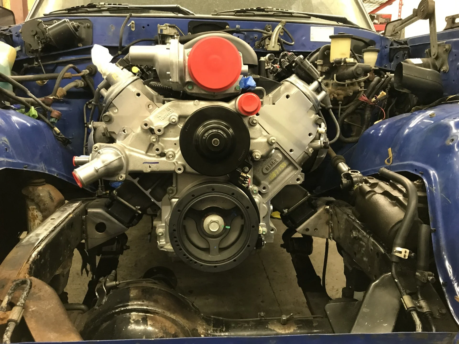

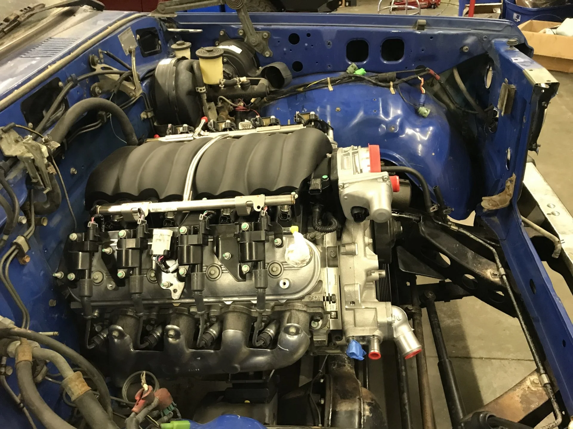

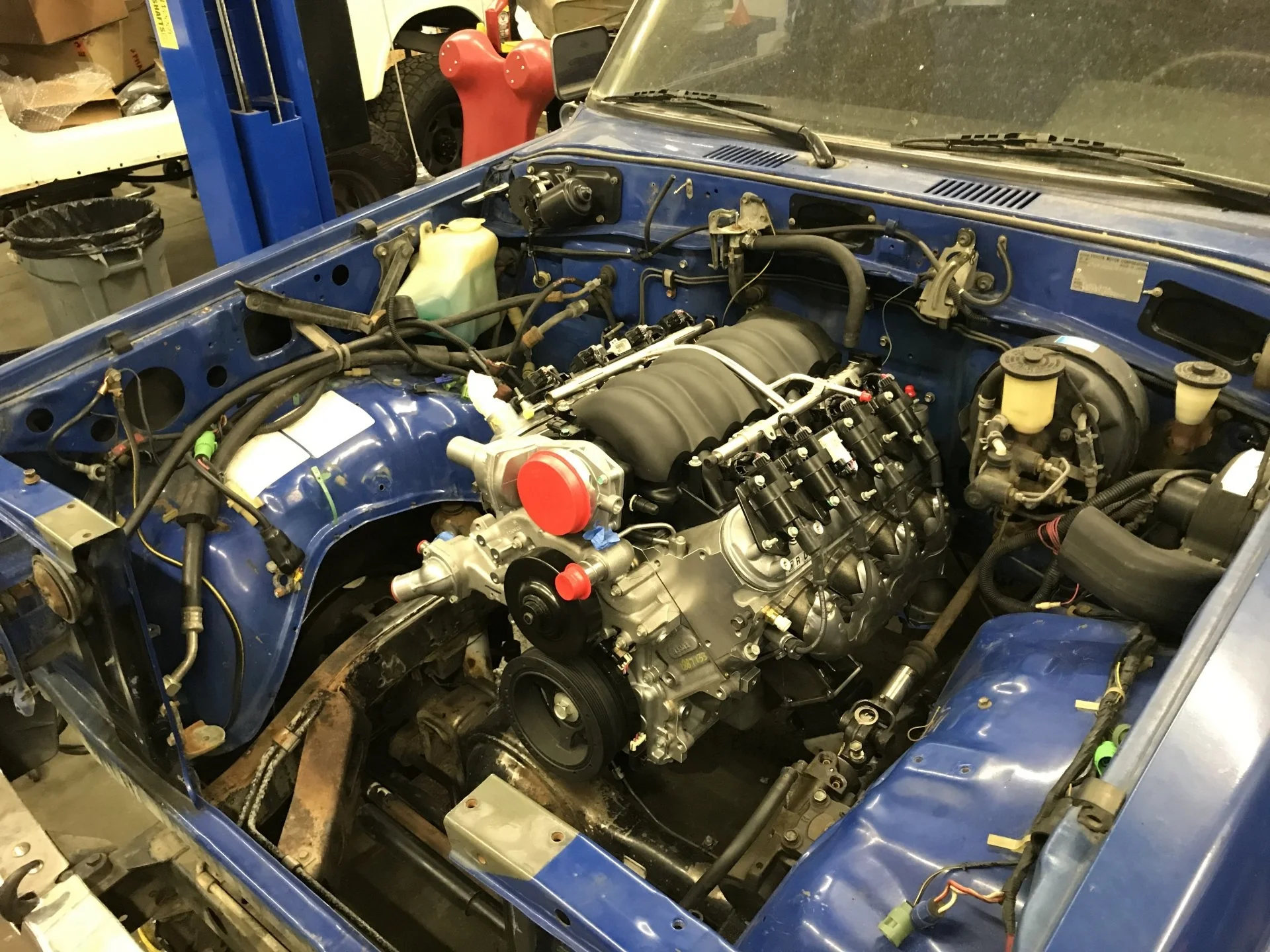

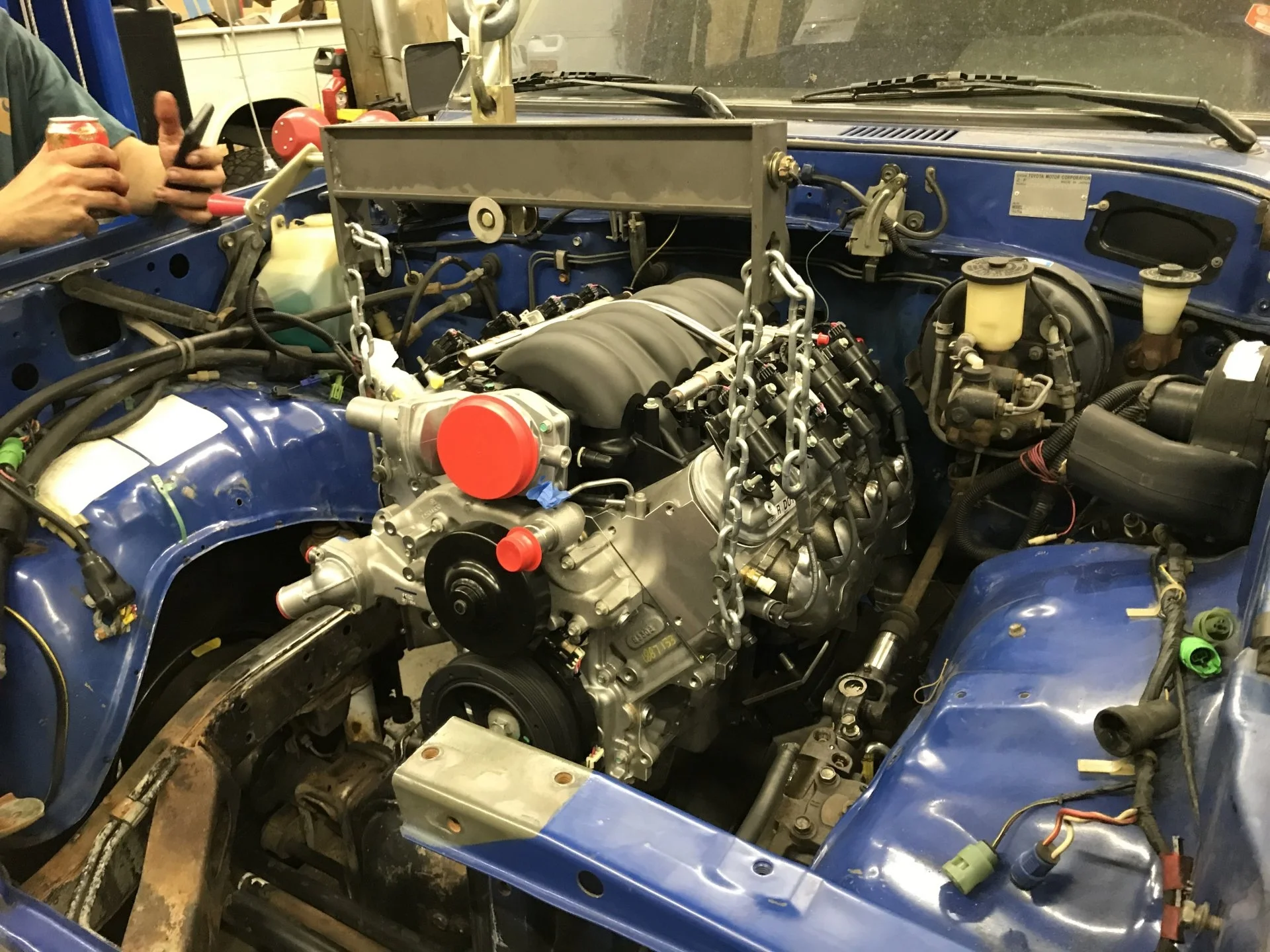

Getting it set where we want.

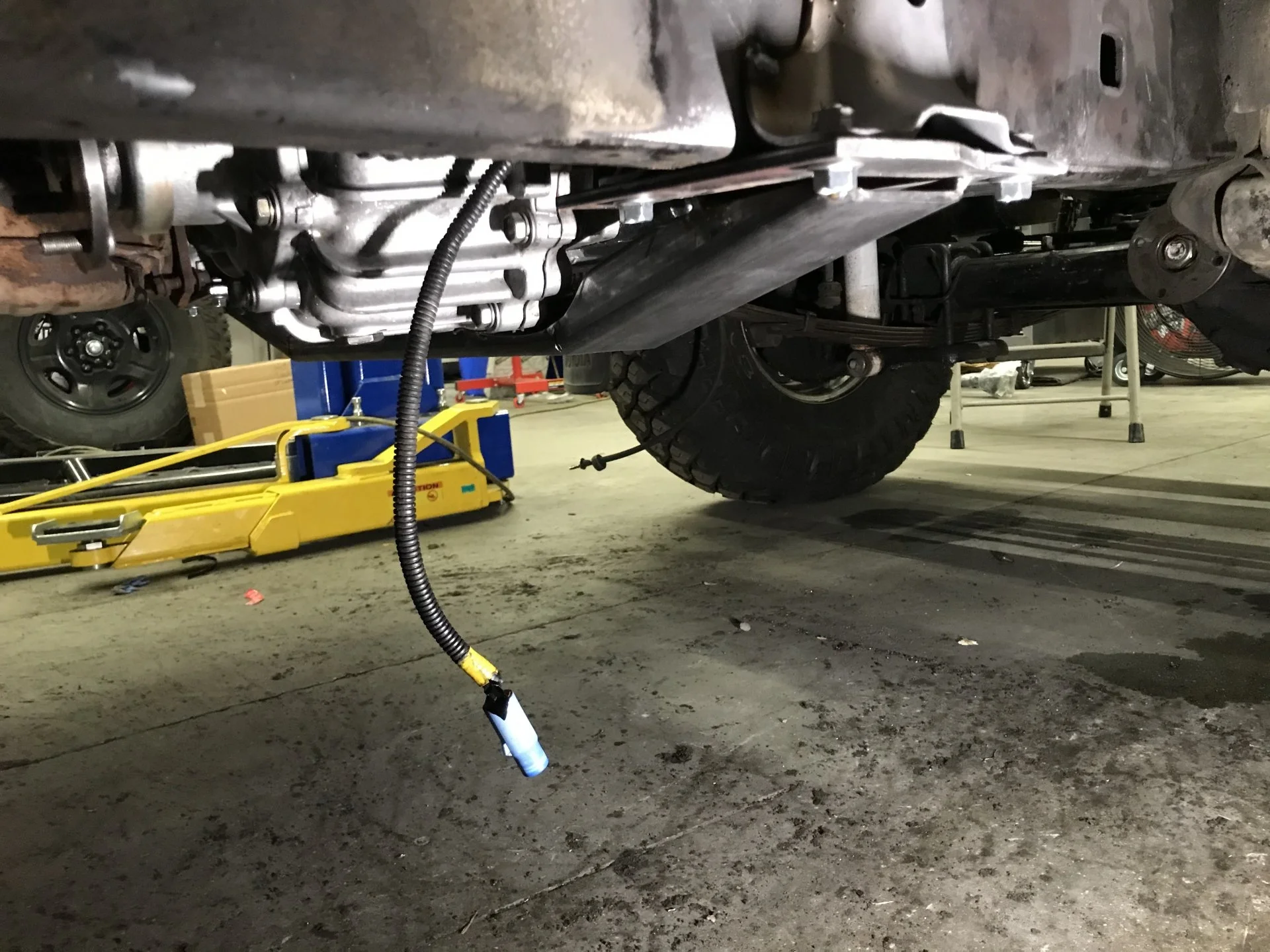

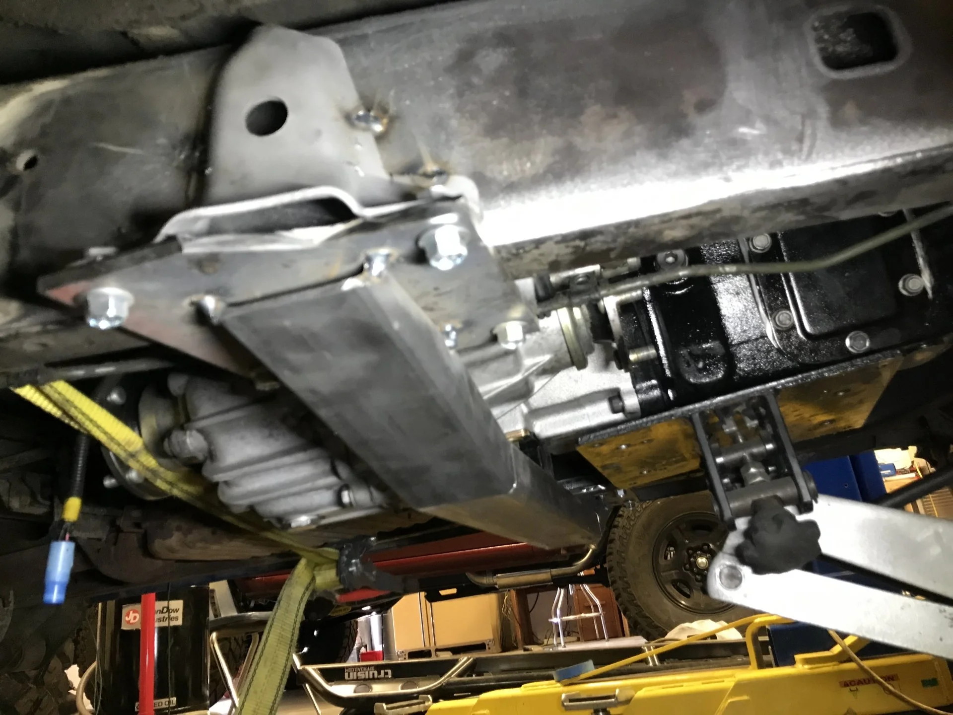

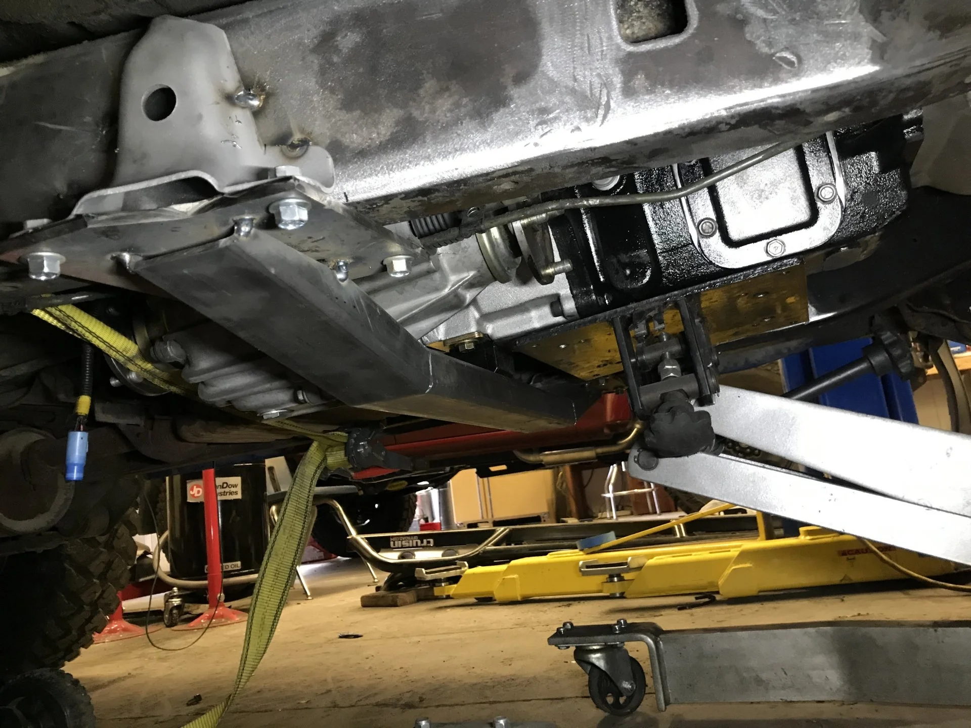

Like most of these swaps we built our own trans crossmember. We want to keep it as high as possible (same for trans & tcase). We also want to use the stock trans crossmember hanger brackets so we cut those off and moved them to suit the swap.
The crossmember is just roughed in right now, we will be adding a tcase skid to it as well.

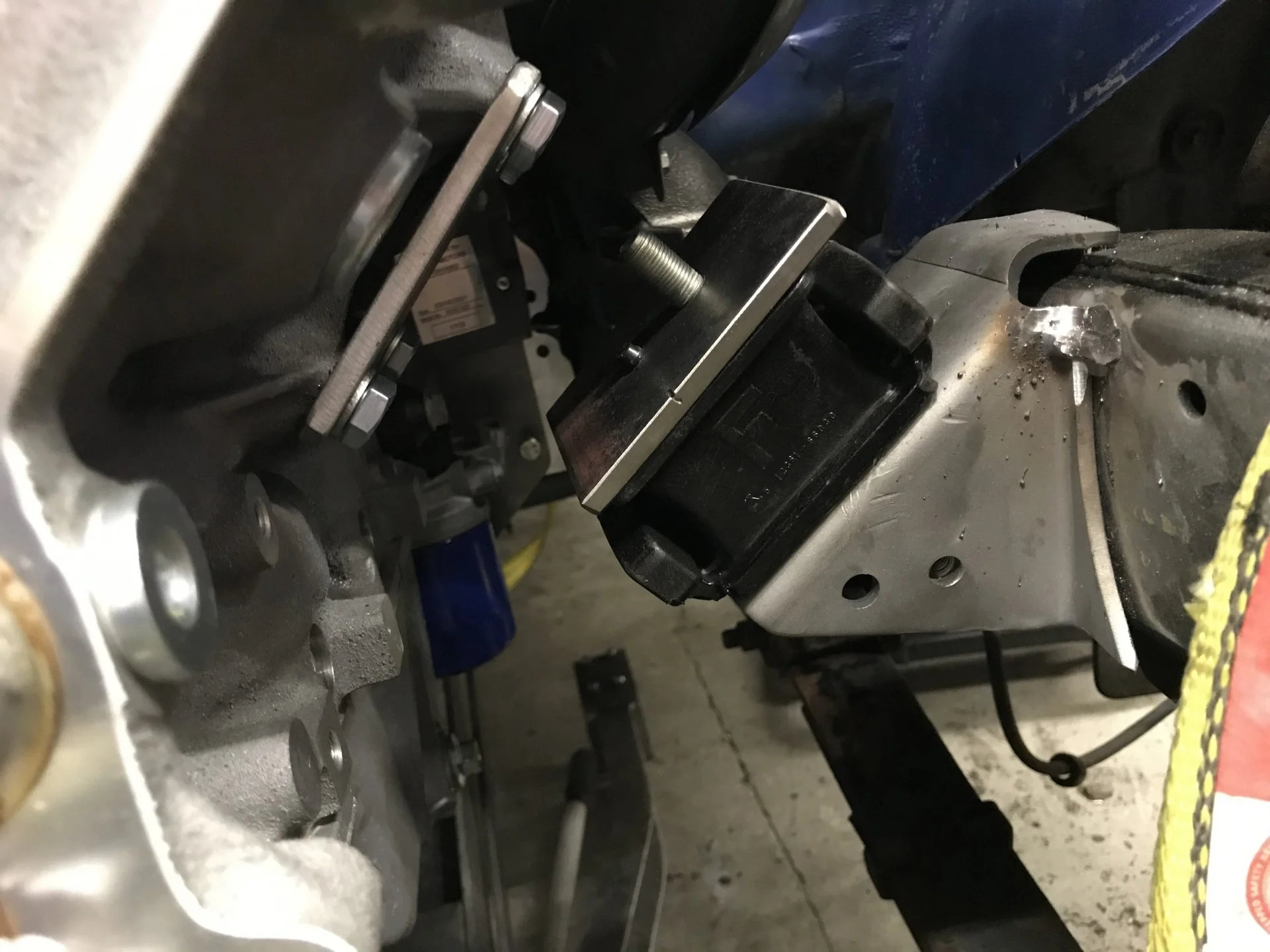

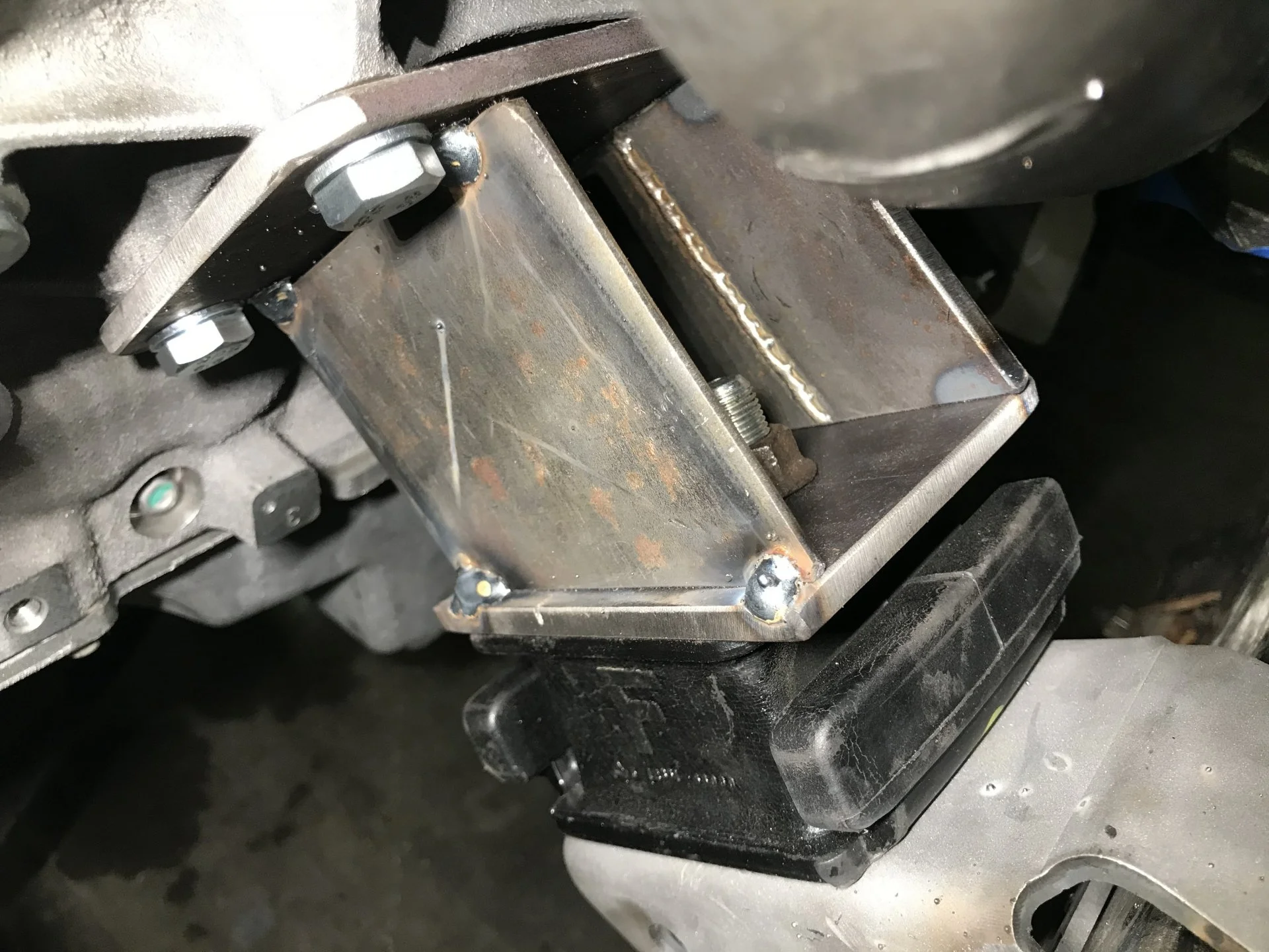

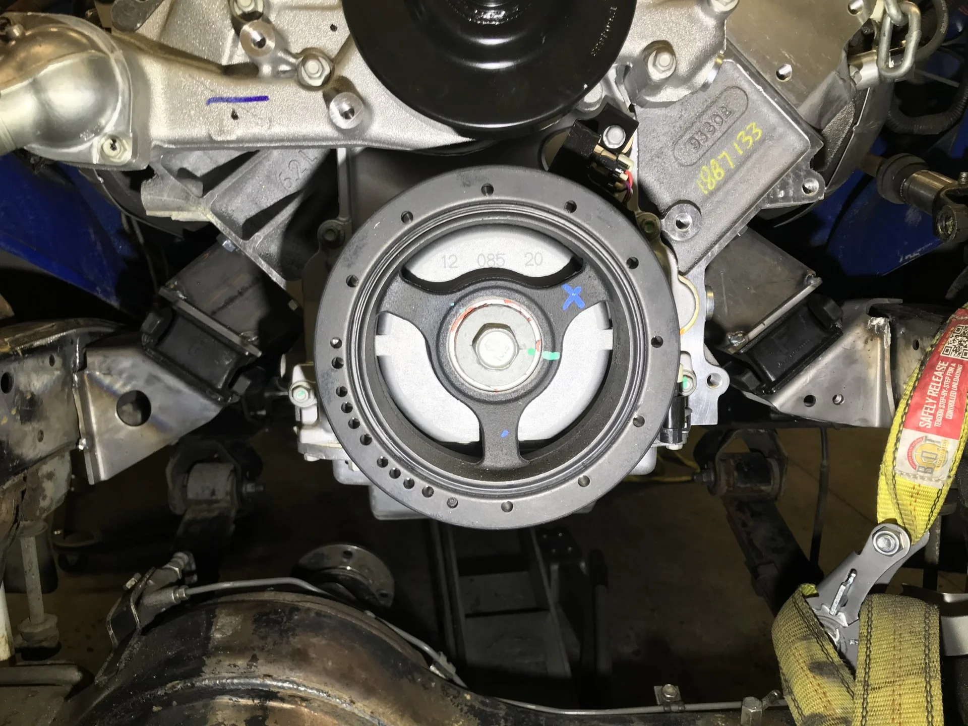

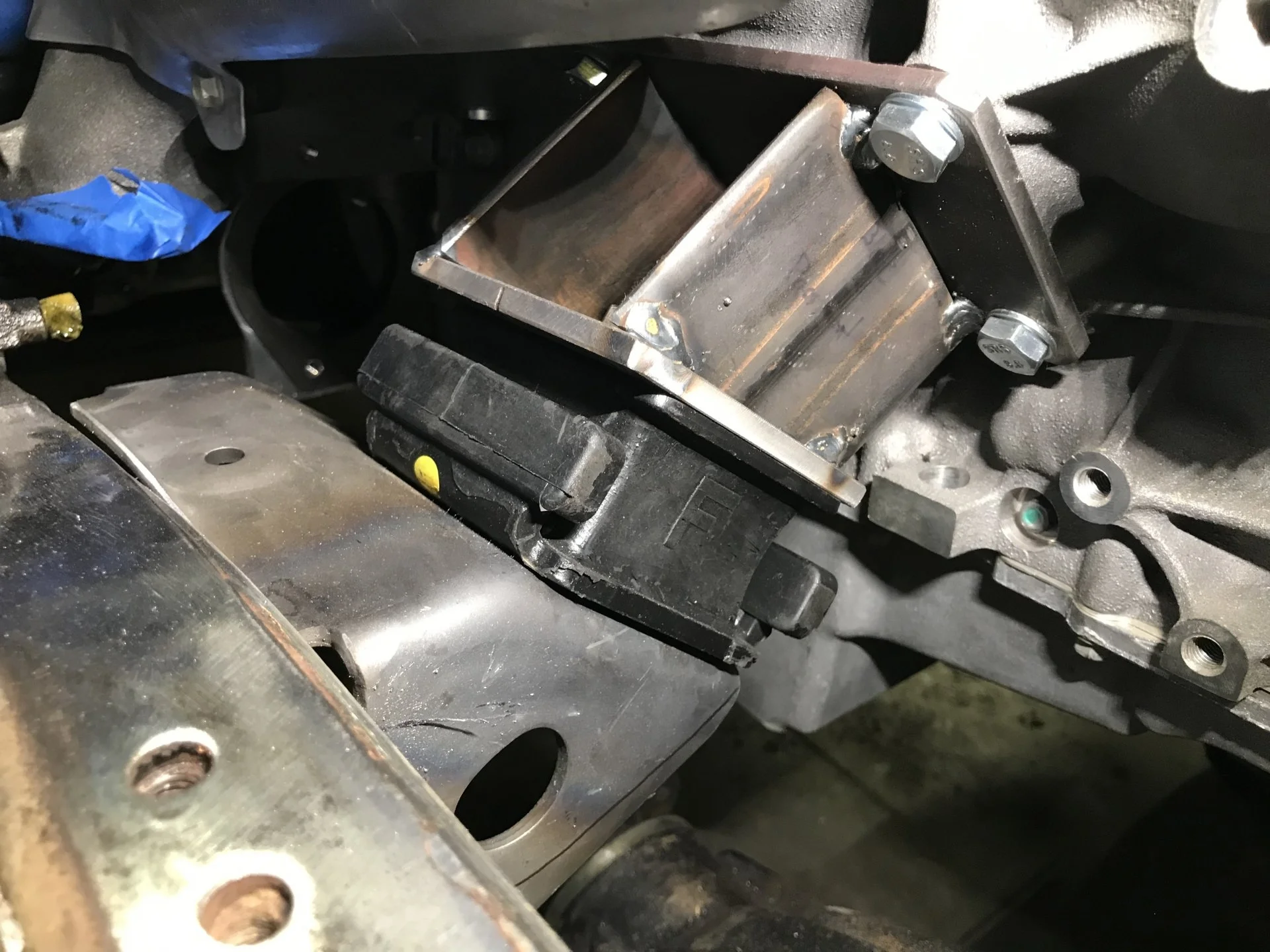

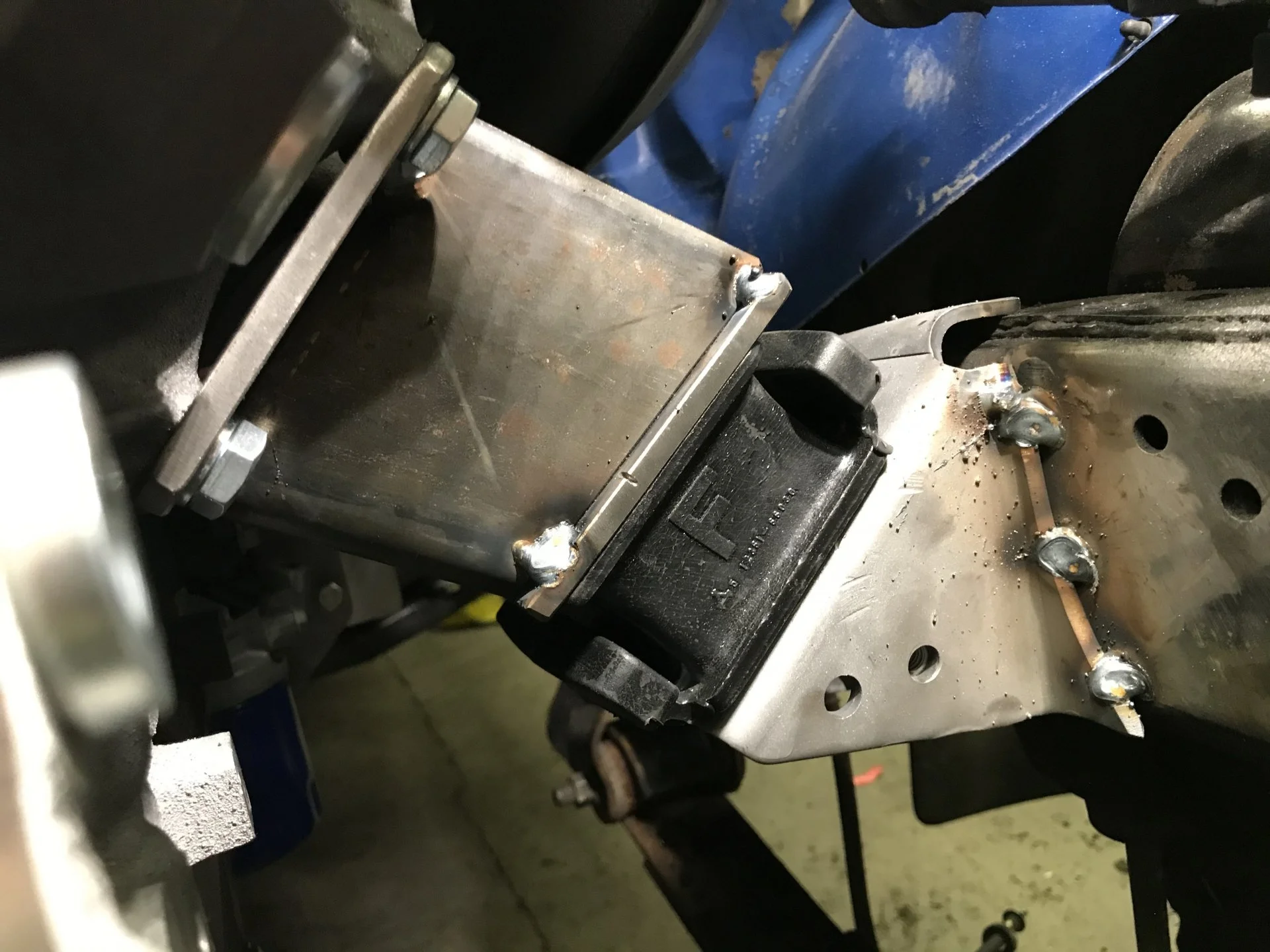

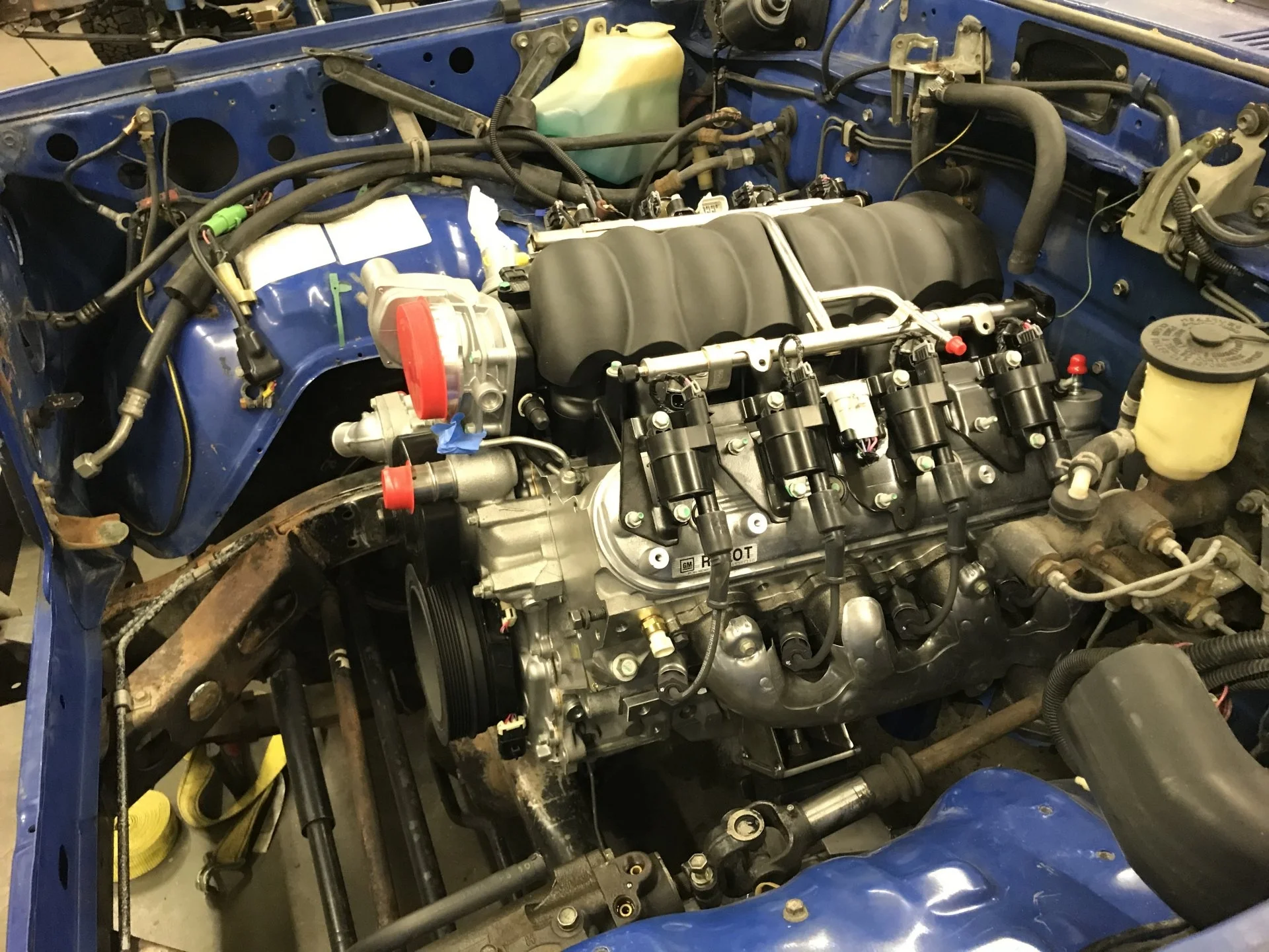

For engine mounts we selected 80-series on the frame side. The hard mount on the frame we cut off an 80 chassis, actual mounts are new OEM Toyota.
As of end of today engine mounts are not finalized but you can see they are coming around.

interesting choice on the motor mounts. Cool to see something new.
Happy with how the engine mounts turned out. These are just roughed in obviously.

About 3/4+ of an inch here.
Trans crossmember supporting the weight and bolted in, more to do though.

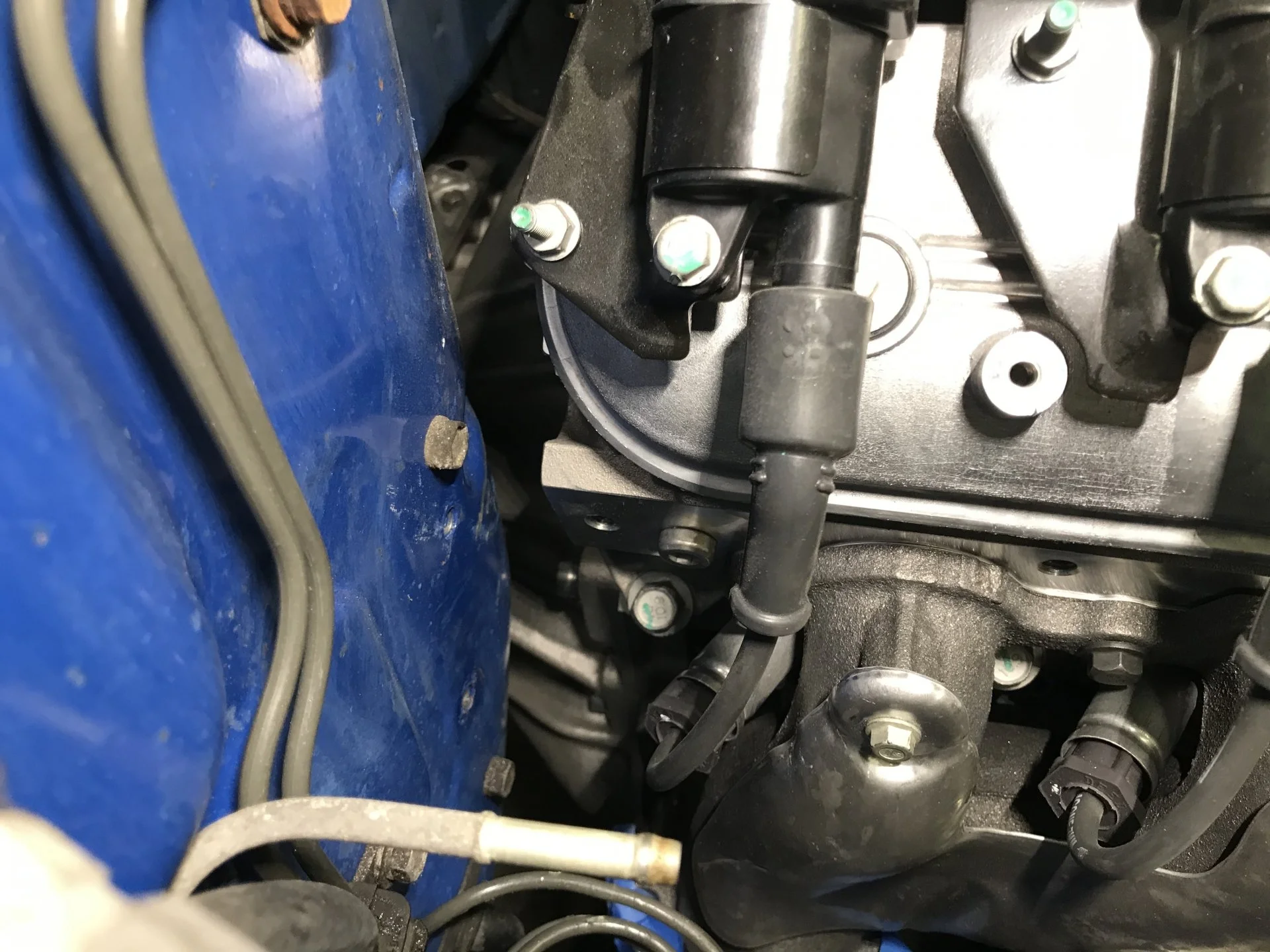

Also we went with these for a few reasons.
I have pulled them out of 80’s with well over 300,000 miles. While toast they were not completely delaminated just cracked and hard as a rock. For this Cruiser, I see no reason these won’t deliver 200,000+ miles. I also dislike AA mounts or that style of mount a lot. Much prefer a “cradle” style mount vs a 90* mount. Also, leaf spring bushings make good mounts but have no where near the damping these do. Nothing wrong with GM mounts and you can even go gel filled or whatever they are. I like Toyota mounts myself.
Shouldn’t have a problem getting these for years and the trans mount while disappointing in the AA adapter is available anywhere in any auto parts store for $40. Like I say I much prefer Marks adapters that use a Cruiser trans mount but nobody makes a NV4500 to split case adapter besides AA.
Also did these for the cool factor. 😂😎

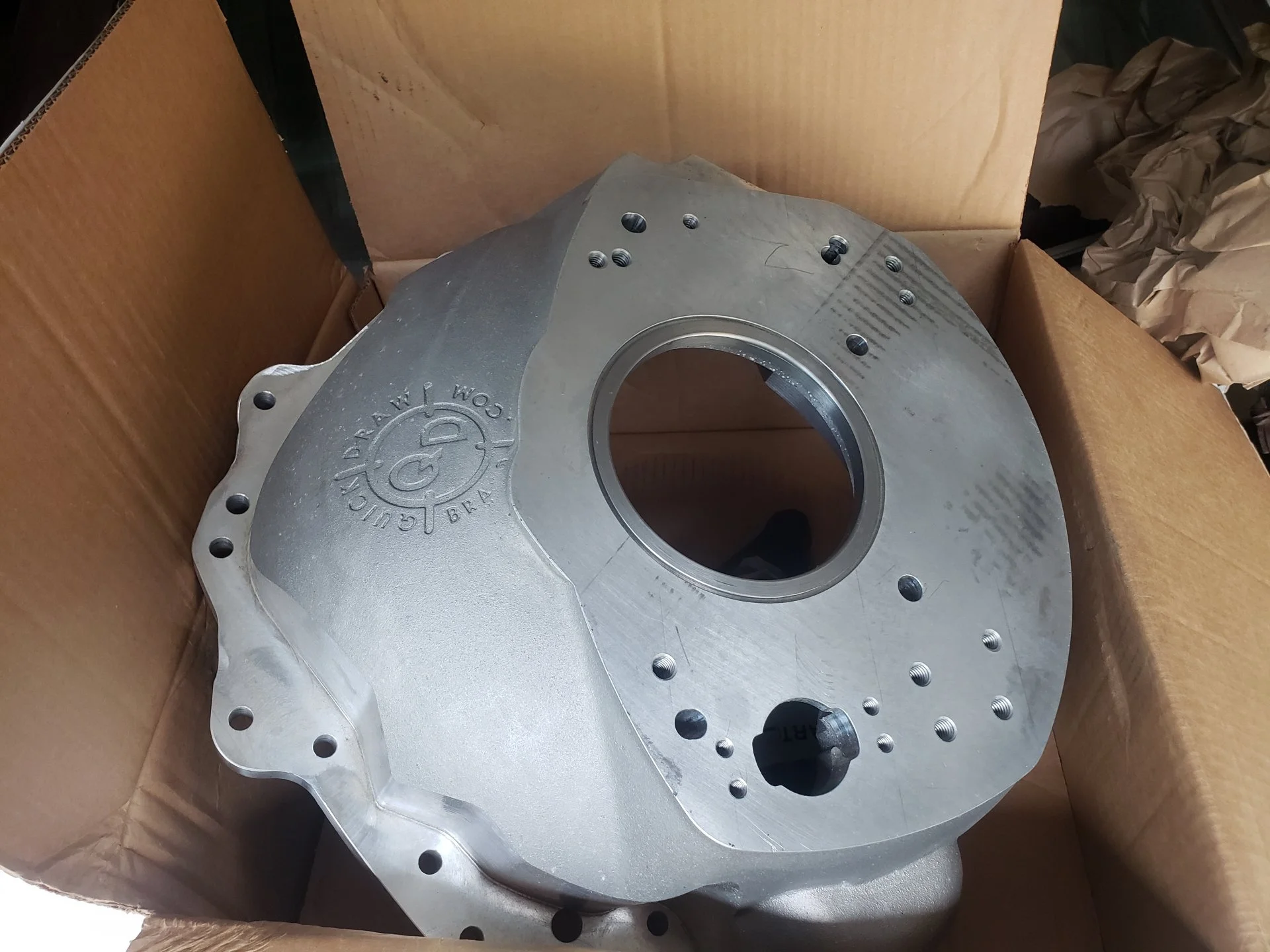

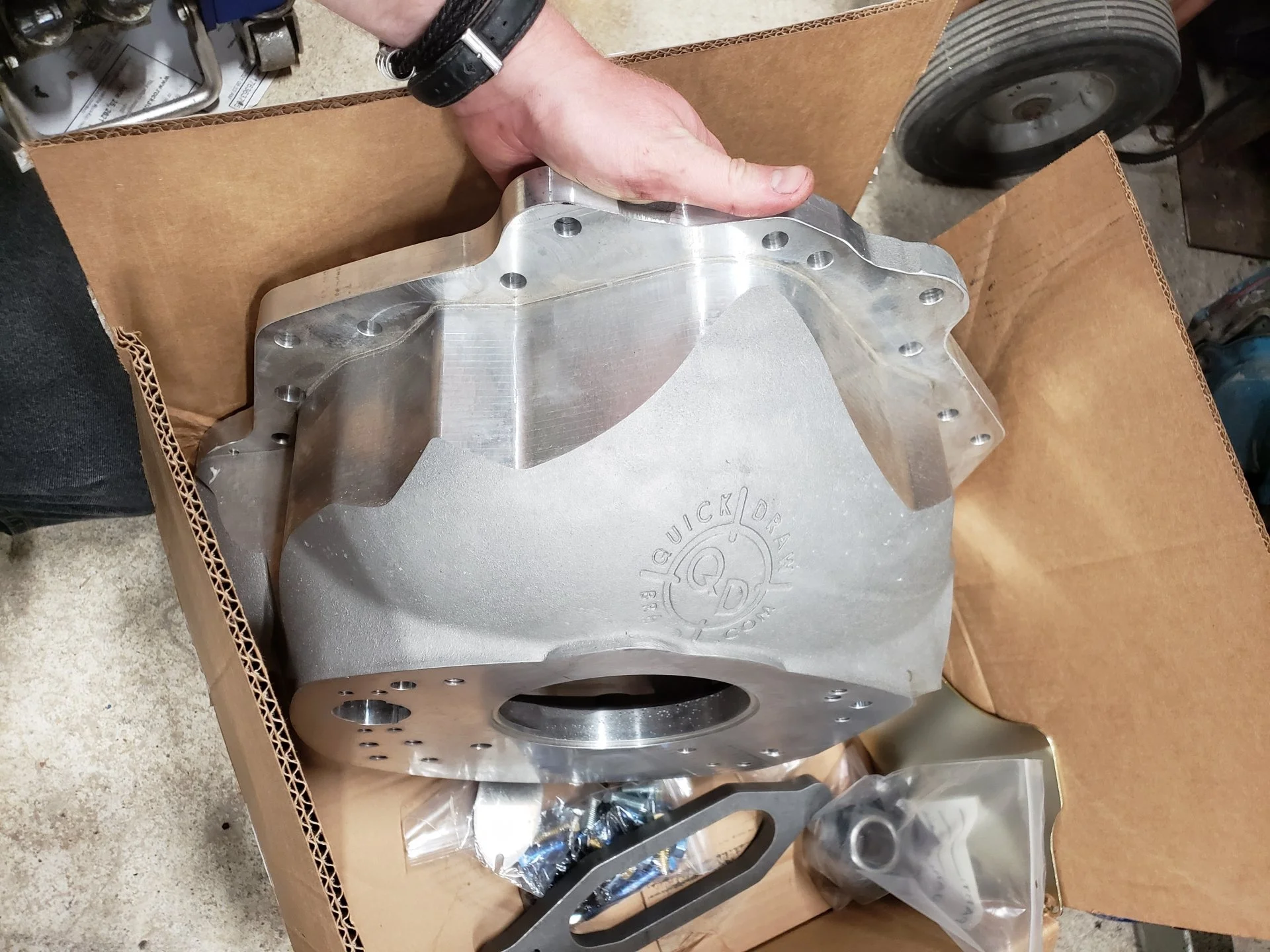

I'm putting an LS/NV4500 in my 62 now - using the Quick Draw bellhousing, so far a vastly better option than the AA bellhousing that I used in my 40. It catches all the LS bell holes including lower oil pan.
Uses an off the shelf Jeep TJ slave tucked up tight to the trans and all factory clutch parts including stock flywheel for a late model 6.0/5 speed Chevy truck. The AA bell on my 40 I had to get a custom flywheel and still had to screw around with different throw out bearings to get the release right...
They are advertising it a early NV pattern but it looks drilled for both and has a removable index ring for the earlier smaller bearing retainers.
It is 100% beef compared to the OEM GM bell or the AA piece.
