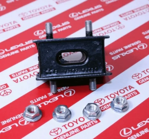

The stock rear exhaust piece doesnt come with anything other than the pipe/muffler. You will need to buy bolts, nuts, washers, gaskets etc that you need. You should be able to get all of those from the dealer. You may also need the rubber supports as they are often broken on old exhausts. I think the system has 3 in it if I remember correctly...2 near the middle of the truck and one at the tail pipe. They look something like this:
THink this is the part number 17567-61030 and (4) nuts = 90179-06007
OK thanks here @Seth S. I see a lot of that stuff is available still so will gather it up. I'll need to get under there and check current condition of the supports on my truck. I'm sure they need replacing. Thanks for the help.
View attachment 2574093 THink this is the part number 17567-61030 and (4) nuts = 90179-06007
FWIW. If you're in a pinch, Amazon has these rubber mounts w/nuts for ~$25 for all three mounts. Search TOTMOX Exhaust

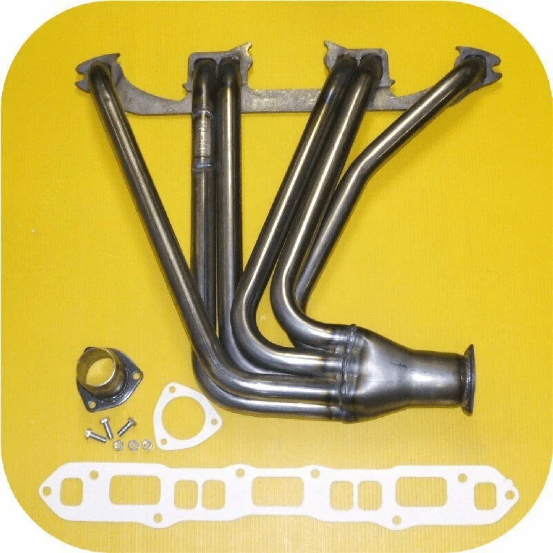

Is a preformance header going to have any notible power improvment? I do plan to desmog and deCat the rig in a comprehensive way. At some point, one of the cat's was replace with a non-stock part,

Where can i find these headers? how much did they run you?
Dan
Ebay
Search- Performance Exhaust Header Toyota Land Cruiser 1F 2F FJ40 45 FJ55 FJ60 Manifold $339
Ebay
are these the same dimensions as the stock header?
