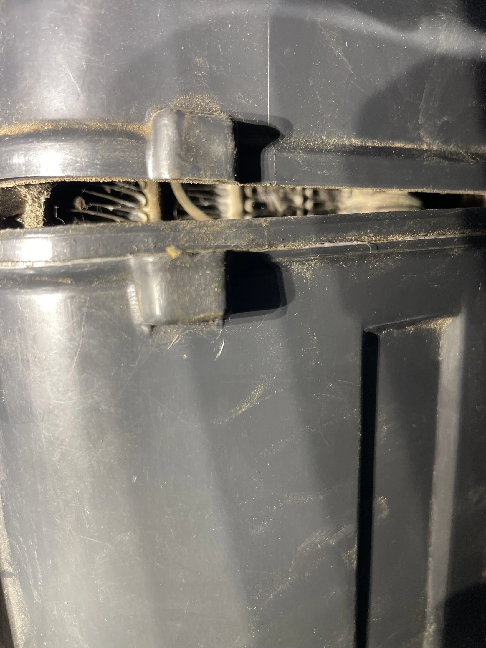

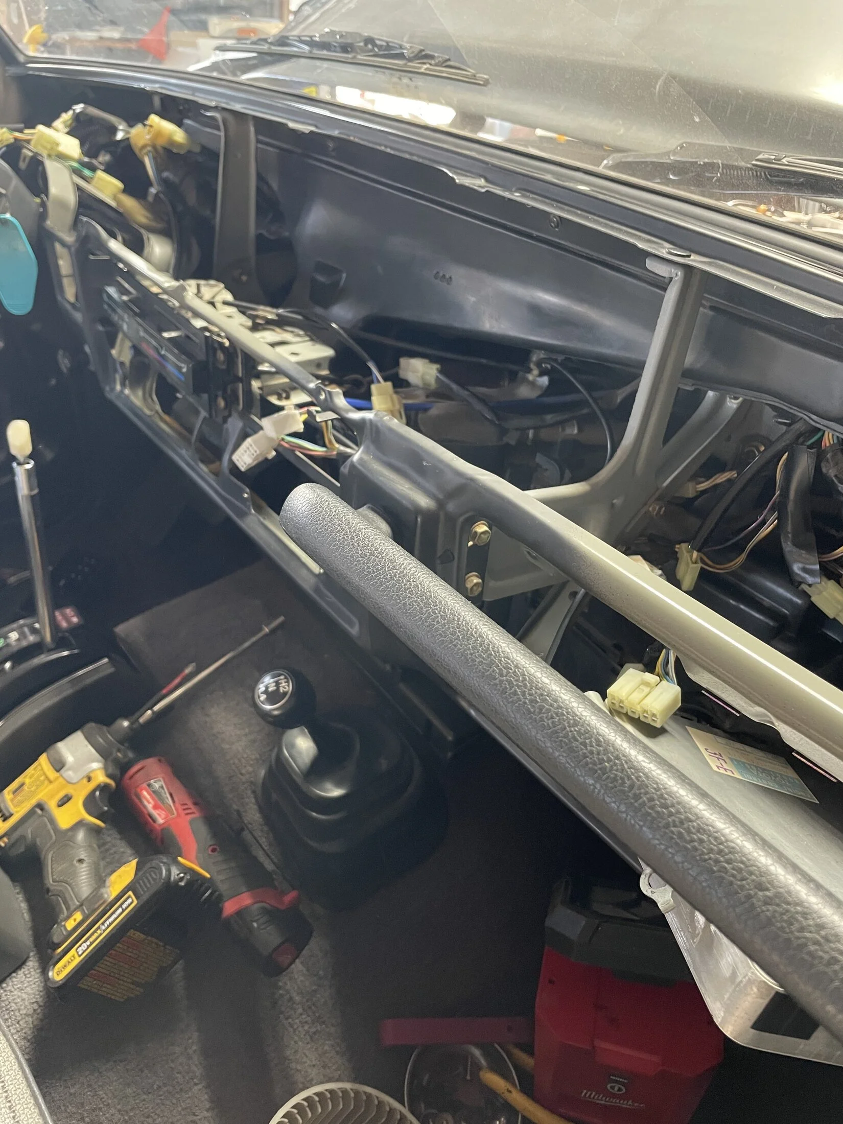

I have very poor air flow through all the ducts. New fan. Took the dash apart to do some work. Everything is so dirty, so I started taking out all the ducts. Still have poor air flow right beyond the heater core. Heater core seems very dirty.
I will try what Mike suggested. Is there any way to remove the bottom plastic, or is does the heater core have to come out with it? Do not want to remove the heater core.
Thanks for any input.
