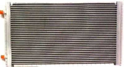

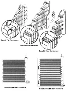

The condenser in a 60 is huge, like most modern ones. The space in a 55 is tiny. You would have to mount the condenser in front of the radiator and move the rad back, or use a different condensor. I'm looking at a Honda Civic one. It's narrow and tall and looks like it'll fit. I just hope it has the correct fittings.
Condensers in any size you need .http://www.ackits.com/index.cfm?fuseaction=Parallel
