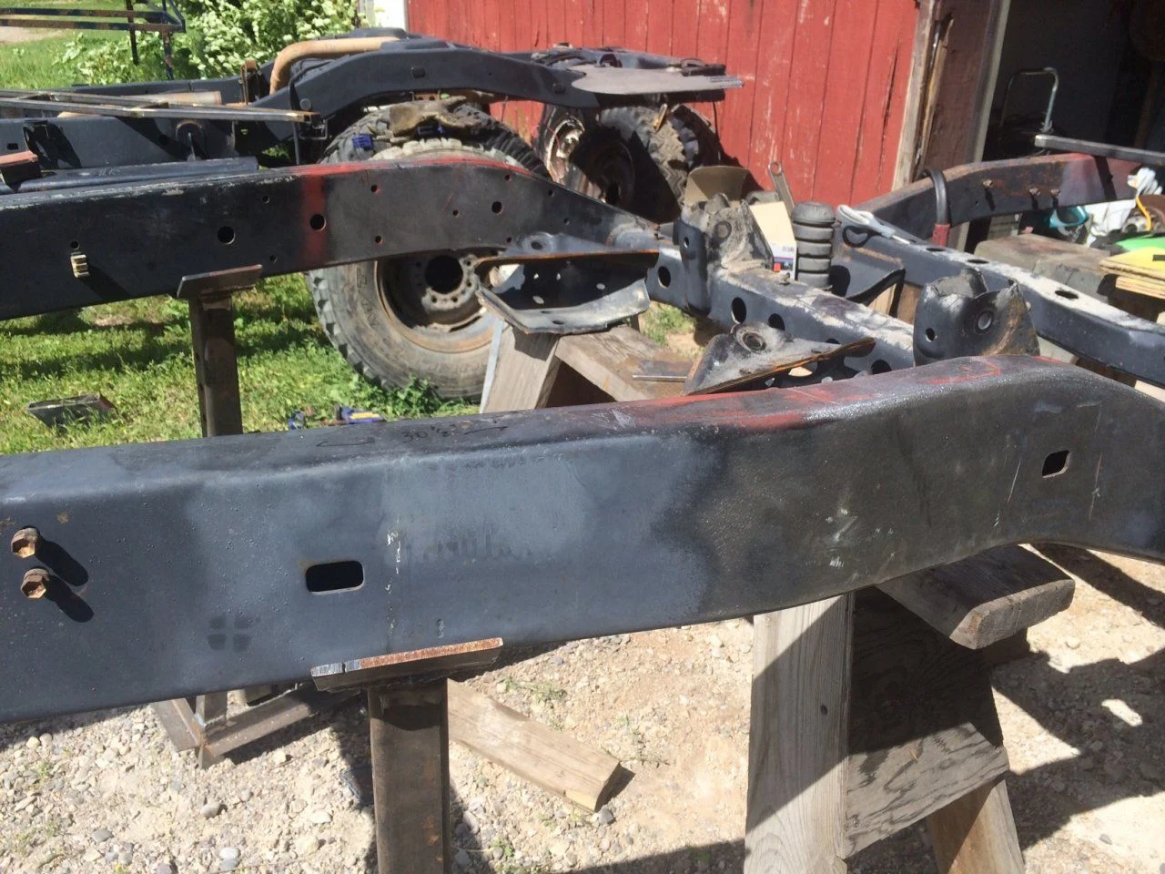

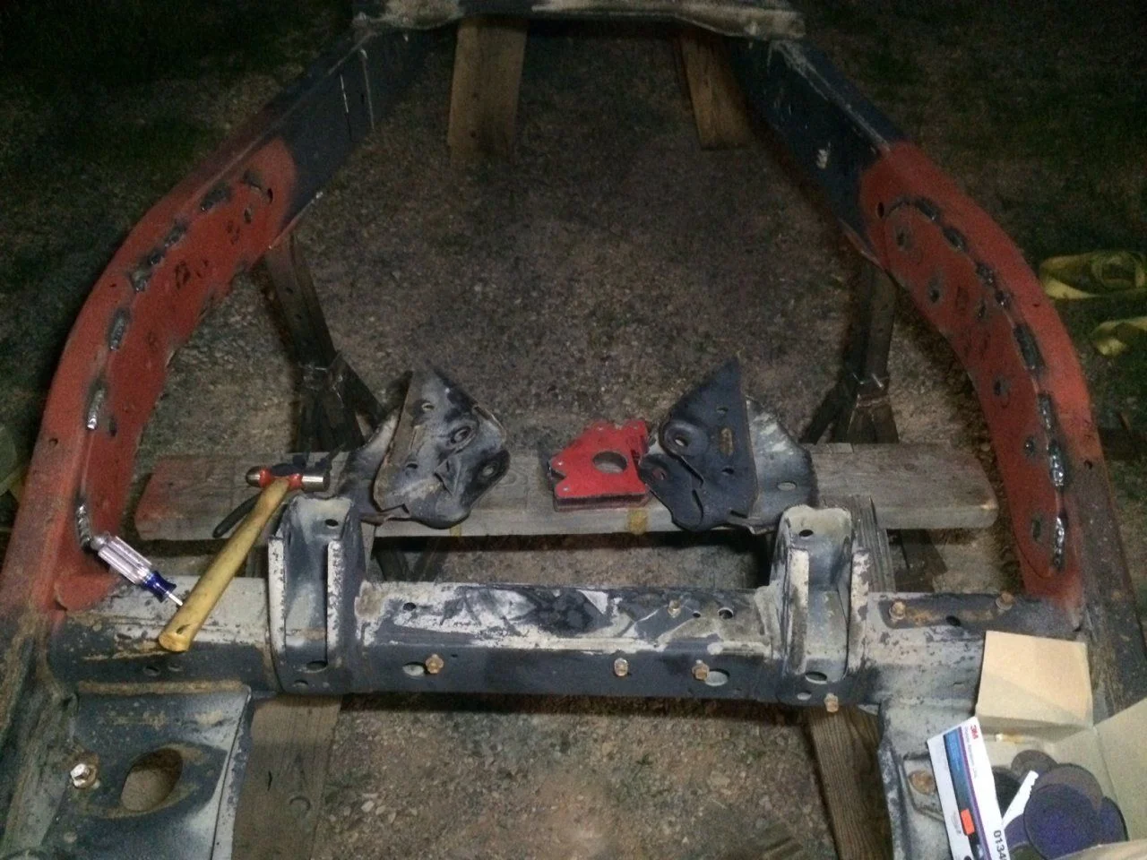

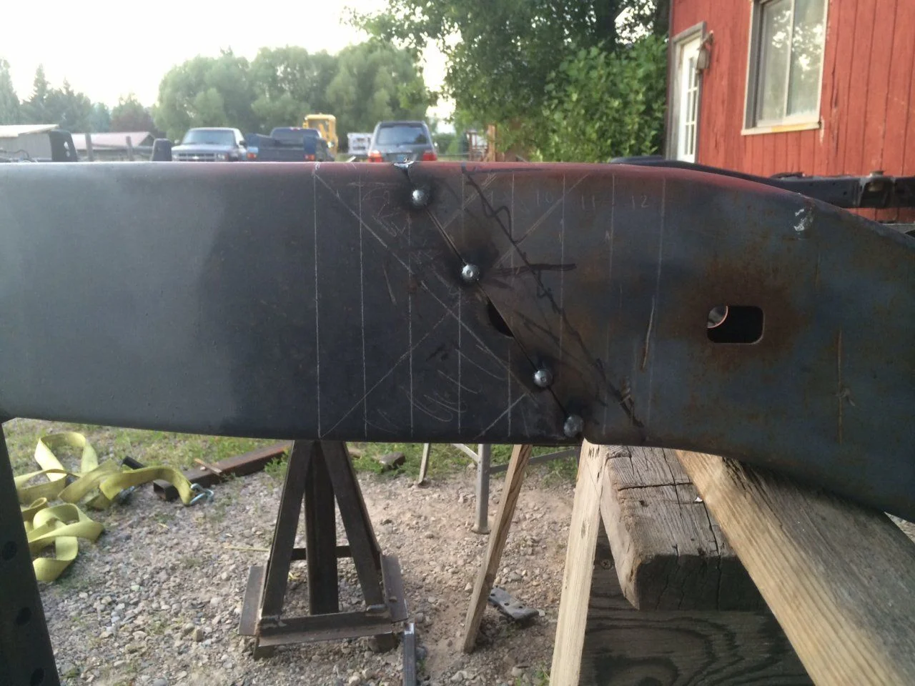

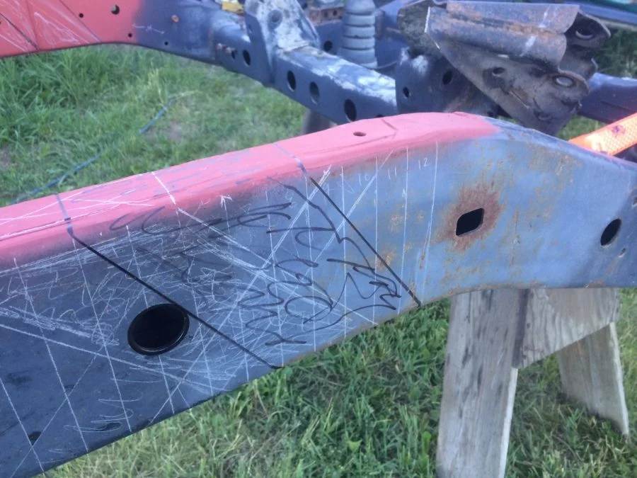

I played with the frame a bit this last weekend. Cut off the RLCA mounts, cleaned the frame all up and plotted where I am making my cut. I changed my mind a lot of the cut because 5" is coming out and I am cutting on an angle not vertical. There is really only 12" to work with here, I started out with a 45* angle but didn't like it so went to 30* and then finally 25*. Hence all the marks in the pic. At 25-30* there is plenty of room and I don't get into the flared section in the frame or the axle hump in the back. I am happy with it and ready to cut now, I just need to get set up in a good place in the shop. Once the frame is cut and welded back up I am ready to make my body mounts. Still haven't figured out how I want to be lifting the body up and down 30x but that is coming soon. I decided I am not going to paint the truck. The paint on it is good, especially if I touch it up, cut & polish and Monstaline here and there. It is just not my favorite color at all but it has grown on me a little. To much work and time + $$$ right now to re-paint the whole truck when it is rust free with very few small dents.

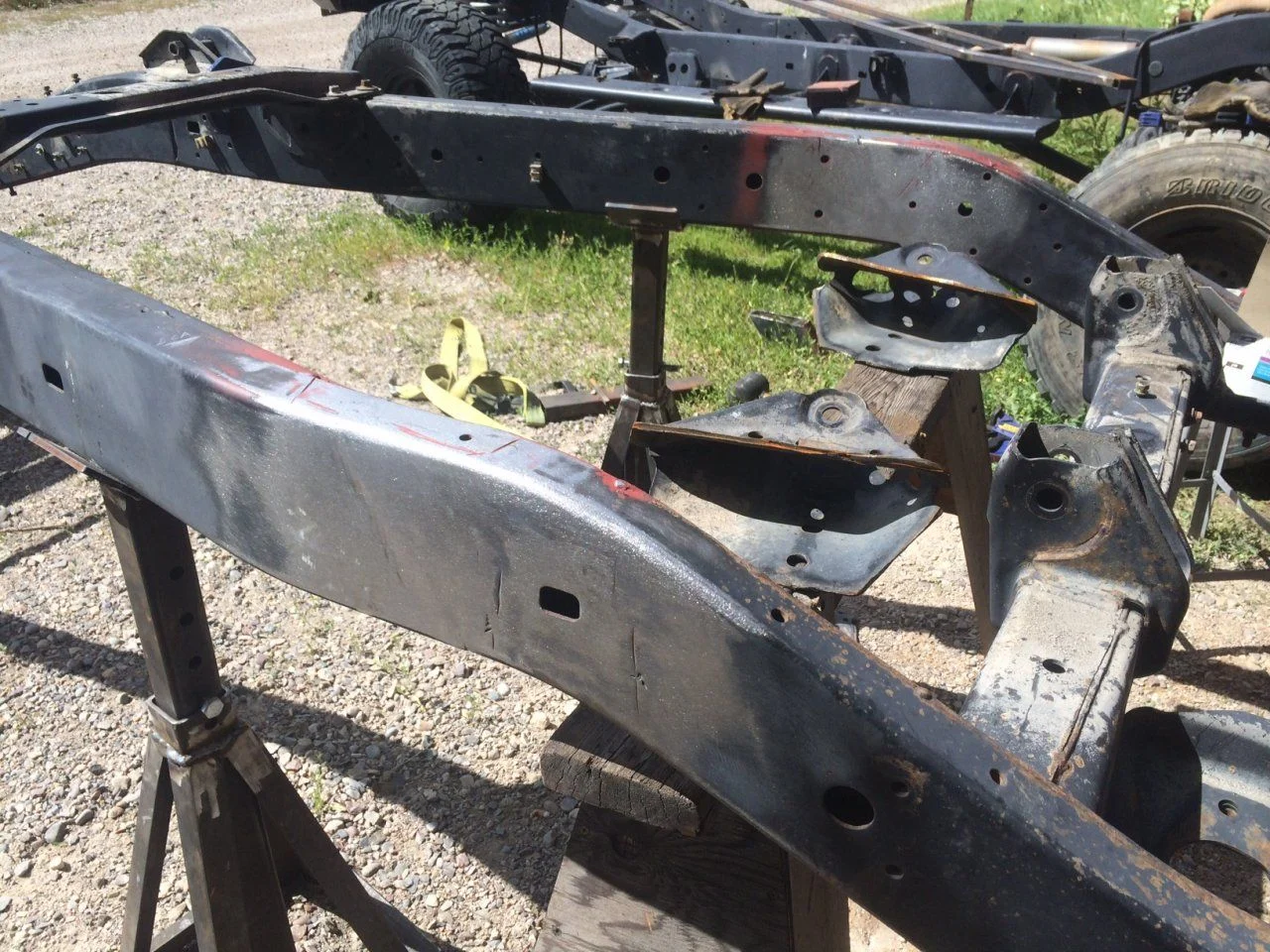

The frame I am using, like I said, I decided to not use the frame from my 91 FJ80 I rolled and use this one instead since it was mostly prep'ed. It is from an FZJ, nothing different though except, the vin #. ;)
I realize it looks like the angle is not the same but it is simply because the pic is taken from an angle. I have a digital angle finder to plot this and no not an angle cube. :rolleyes:
There is a bunch of different ways you could cut this and remove the 5". Obviously, you don't really want any vertical cuts, google it if you don't know I don't really want to get into explaining it here. Most of your hotrod shops would do this more in a "Z" but since I am plating the frame on both sides after with 3/16's I don't feel the need. I may also run a plate top and bottom of the frame rails. The real issue here is if you re-use the RLCA mount. It is nearly 12" long and this section is not 12" long once you cut out 5". The way I am doing it seemed like the least amount of work, the RLCA mount will be a bit past the hump in the frame rail (rear axle) but I plan to box it in. The other way was to have to cope the RLCA due to the bend and taper in the front of the frame. Any ways after 3-4hrs of playing around with this I am happy with my decision and how I am going to do it.
Oh ya, I plan to cut it with a sawzall. If I don't like that I will use my Metabo with a cut off disc. Got to get some steel before I can extend the rear frame rails or start in on body mounts, I already got all the 3/16's for plating.

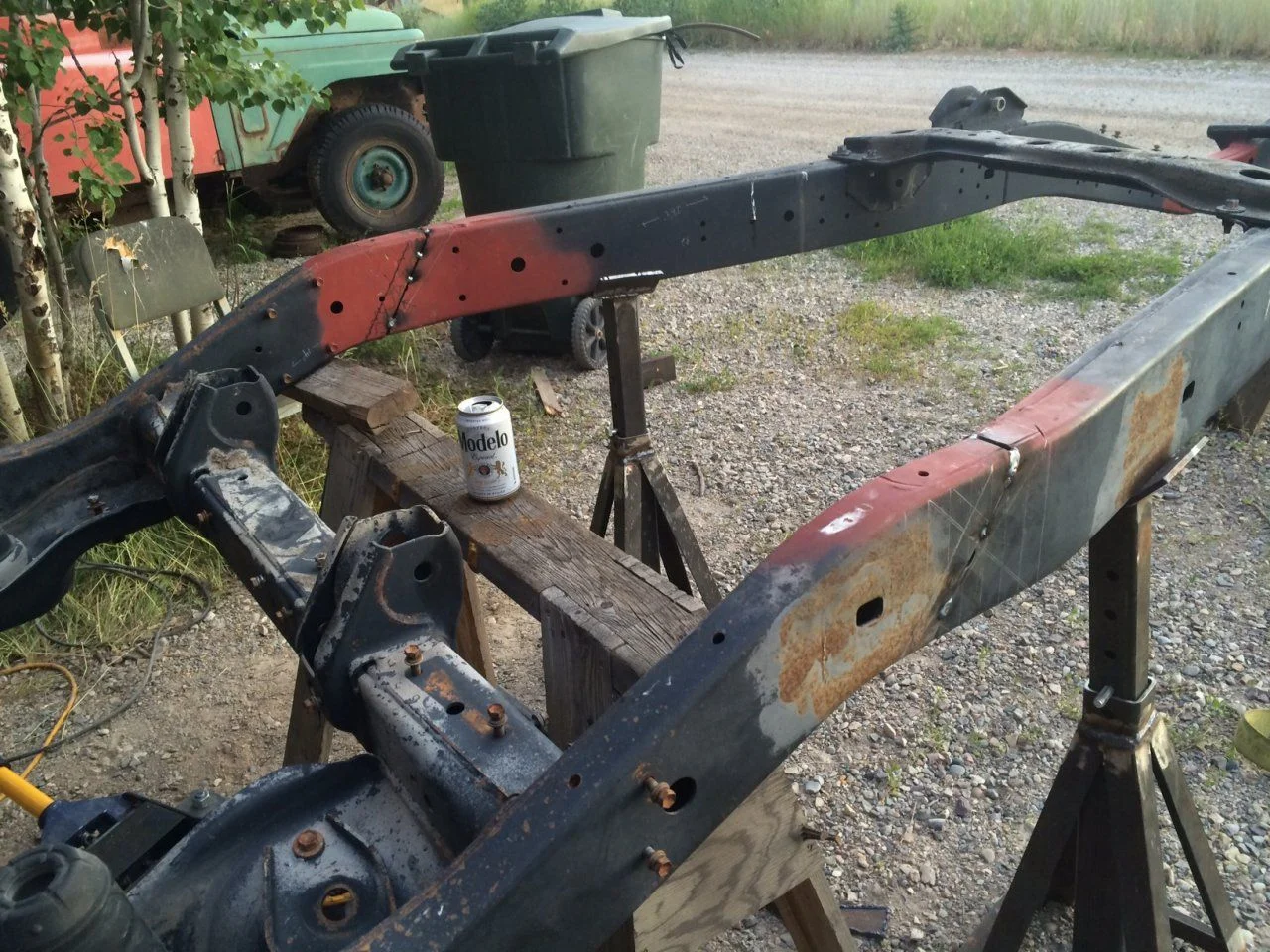

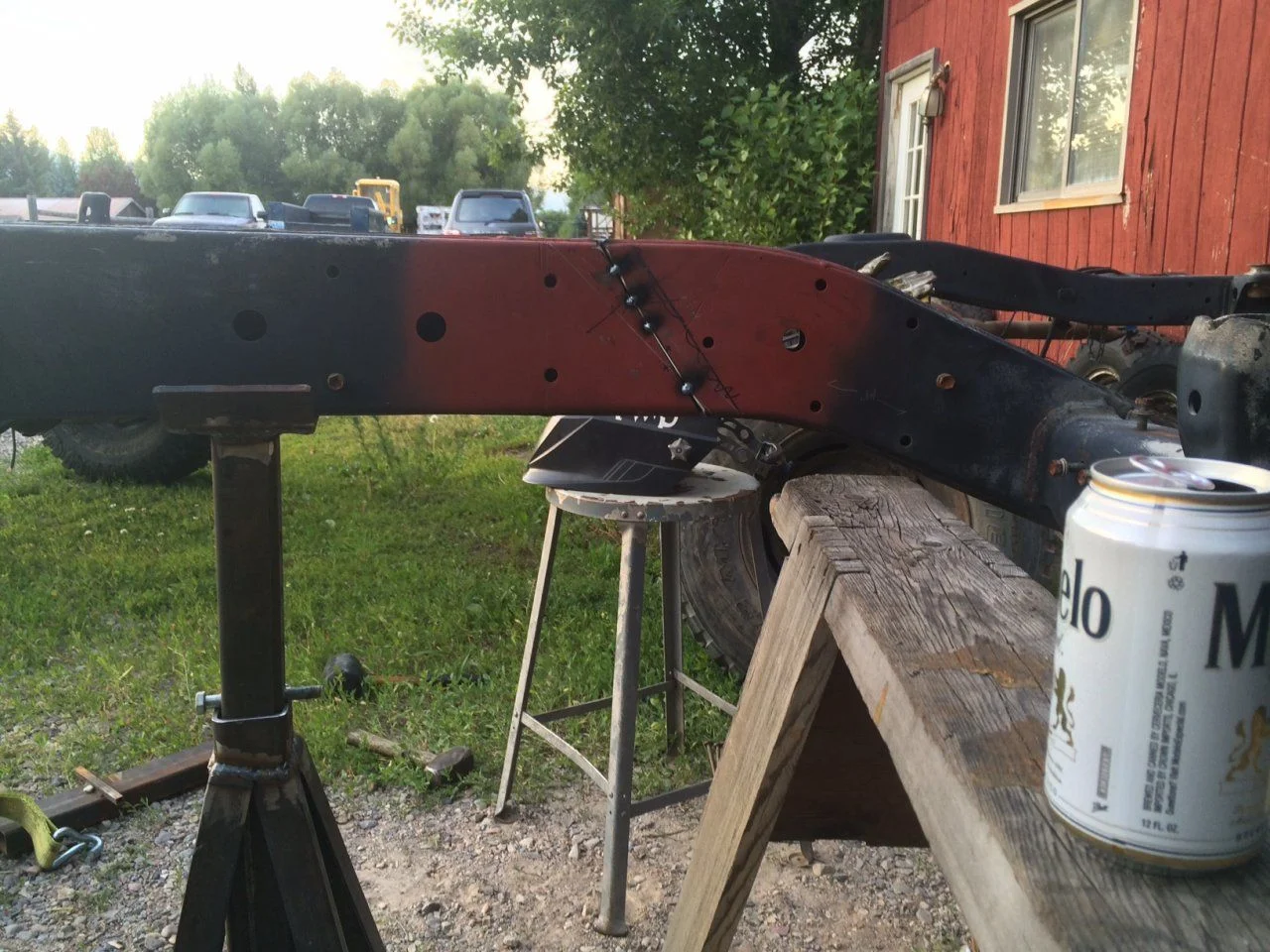

Very happy with how easy and quickly it came together. Not the best surface (gravel) or set up but I made it work, no room in the shop right now. It is within .1* and under a 1/16" from being perfect, square ect ect. I can live with that, tomorrow start making frame plates.

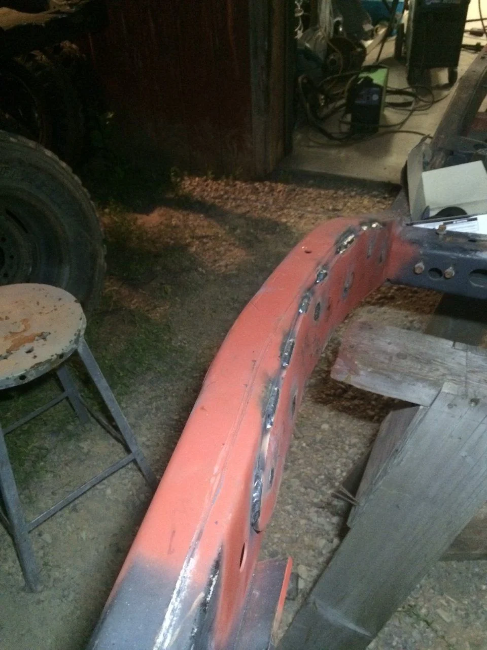

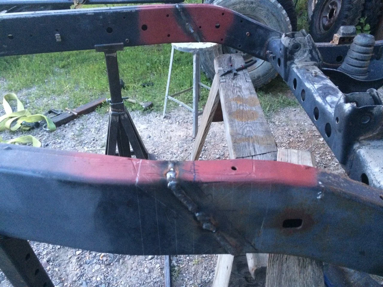

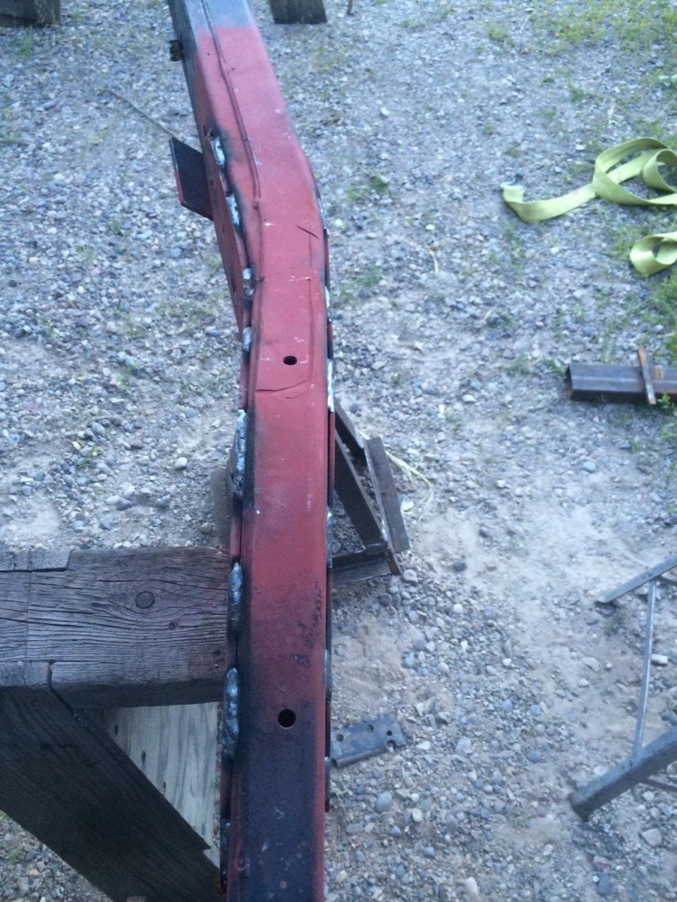

Not bad for a splice......

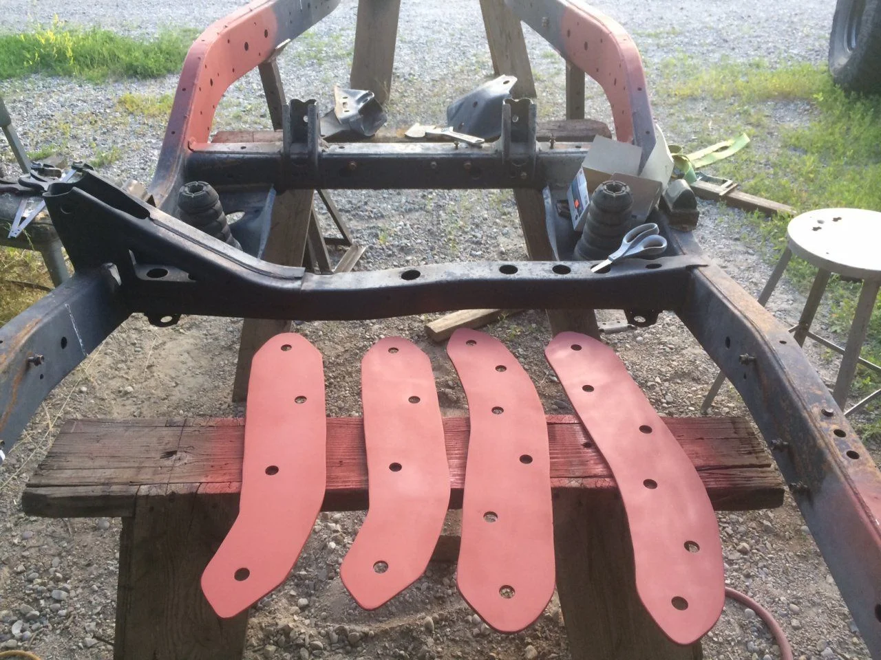

And with that done I made plates for the frame.....

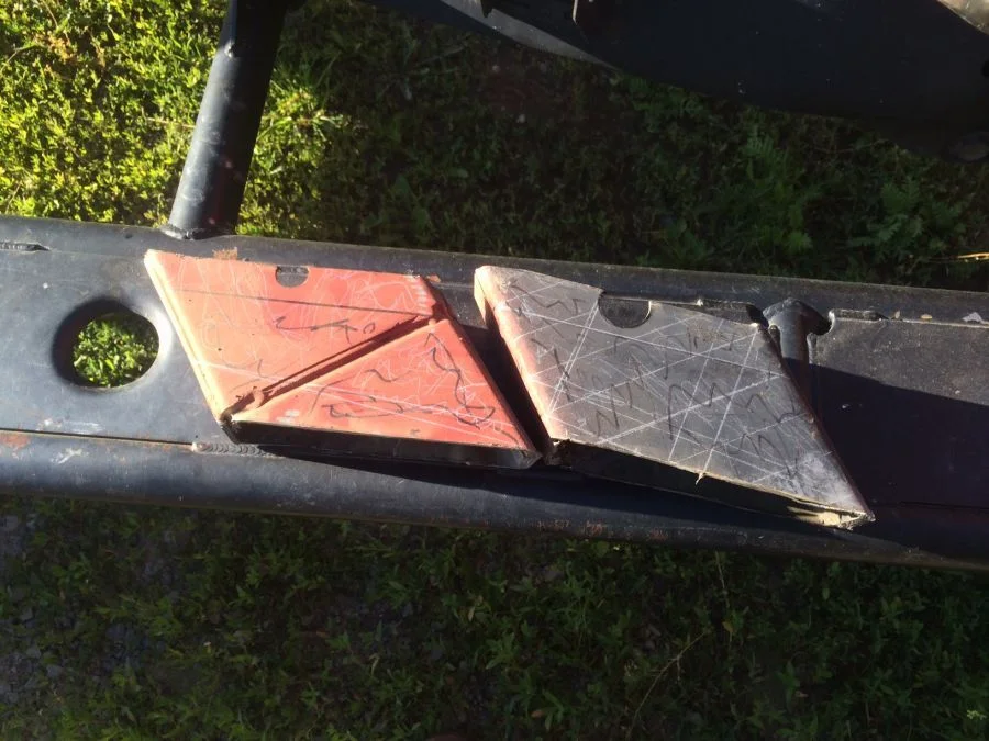

Yup, stoked on it. Just took a bunch of time on the grinder and plasma cutter. Doubt this will ever fail, it is extra strong now.

That is probably the strongest point on the entire frame. And I would want it to be, considering that's where it was cut in half and put back together! :)
I am pretty stoked, I feel like the bulk of the work is done on this chassis. Extending the rear frame rails will be a snap, making engine and trans mounts will be nothing. Now making x12 body mounts will be some work but it shouldn't be near s much time on the grinder as I have spent thus far, I dislike the grinder if you can't tell!
It is right on the money at 108" for the wheelbase. I just need to buy some c/o's and I can make this a rolling chassis. I am feeling like it is pretty cool to have an FZJ80 frame that is nearly ready for an FJ62 body. :)
