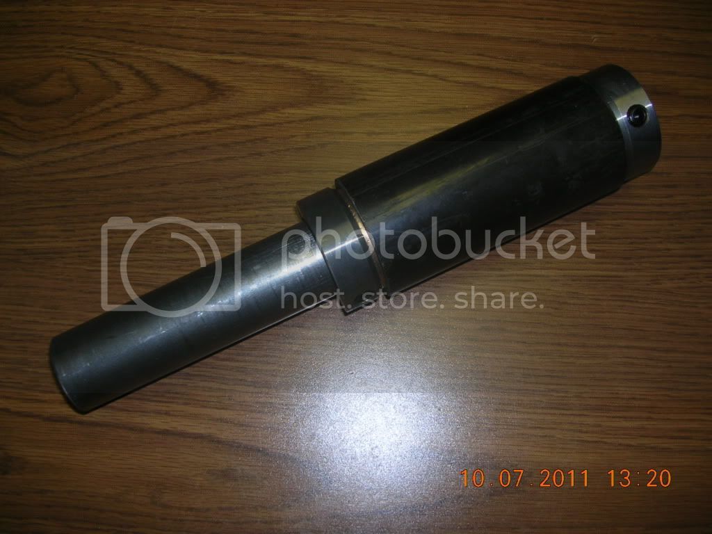

Single (bearing) - one horizontal swingout arm, vertical support for tire carrier, round plate for mounting the tire (correct hole pattern for Toyota, can make other patterns upon request), one 1-3/4" spindles, one bearing kit which include two 2 sets of bearings, seal, cap, castle nut, and cotter pin.
Dual (bearing) - two horizontal swingout arms, vertical support for tire carrier, round plate for mounting the tire (correct hole pattern for Toyota, can make other patterns upon request), two 1-3/4" spindles, two bearing kit which include two 4 sets of bearings, two seals, two caps, two castle nuts, and two cotter pins.

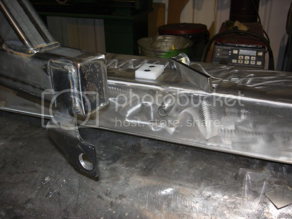

What is not included - no studs or lug nuts for the tire mount, no plastic arm supports (can be seen in the picture below)
Here are some pictures of a single arm setup. This setup uses the same bearing/spindle as the first one I built and what you see here in this thread. I can also provide the bumper with provisions to use a spindle with bronze bushings. They are a cheaper alternative to this setup. Some final welding/grinding/cutting is required.
Parts included with the Tire Carrier Kit (includes two horizontal swing arms and two bearing kits, only one of each pictured).
Spindle, Hub and Bearings included with the kit

Tire Carrier Latch Mechanism Kit (single arm shown in picture)
Swing Arm Stop Pin Mechanism Kit
