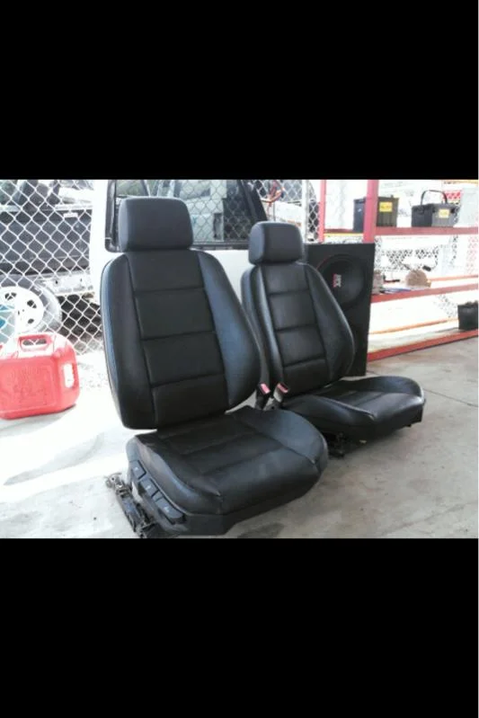

We've designed a set of seat brackets to bolt BMW 3 series seats into a late FJ60 or FJ62. I'm looking for a few people who want to test them out for us and provide some feedback on fitment.
We can probably manufacture 3 sets so some people can try them out. If you want to test them, then you need to be ready to buy some seats. I would support someone who is ready for this upgrade now, so we can get feedback on the brackets sooner.
So far we've used them in about 3 of our 60 series resto-mod builds, and they have worked well with some tweaks. Now I'm ready to get some feedback from you guys.

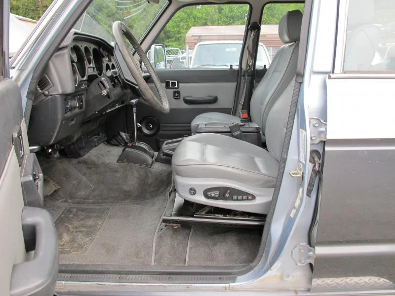

Cool, good luck with these. I did the same thing put the 3 series seats in and used them for about 4 month's. One thing people should be aware of when buying the BMW seats is they are known to "twist" do a search and you will find LOADS of twisted seat fixes. For me I ended up with a wagon gear seat box so I swapped mine out for Subaru seats but the BMW seats are very nice in with a good seat bracket what a dream.
Those 3 series seats look great! What is a good year for BMW 3 series to look for?

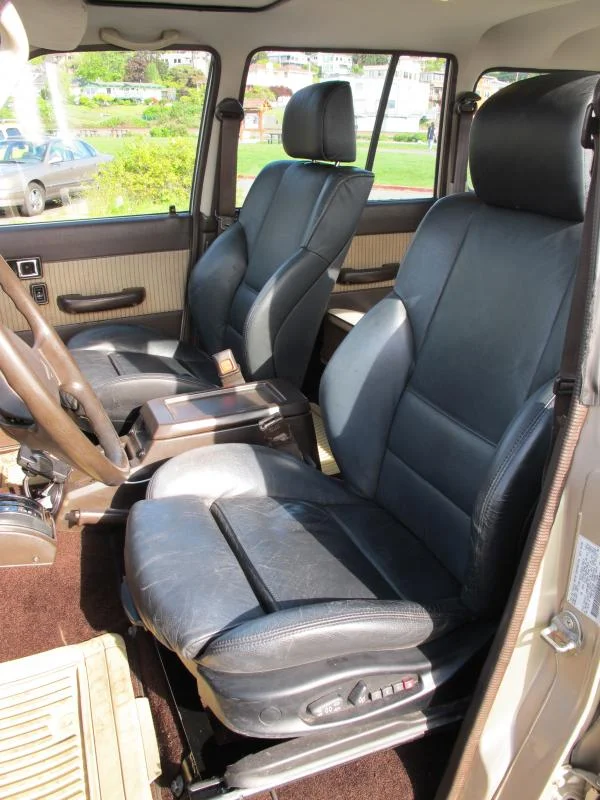

1994 - 2006 4 door 3 series are all verified to work with our brackets.
The later models are a PITA because the power seat switches use a central computer to work right. The workaround is to adjust your seat right after starting the truck, because it times out after 10 minutes and you can't make any adjustments until after you shut off and restart the truck again.
Beware the late models which have airbags, just stay away from the yellow coated wires.
The twisted seats happen now and then, usually because it was rearended, or from a large dude being the daily driver. I have only seen it once though.
I chose the BMW seats because they (in my opinion) use the best quality leather and are super comfortable.

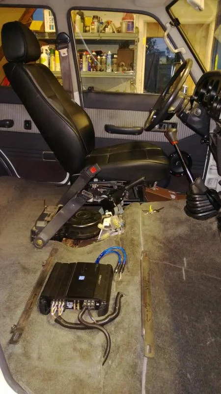

I have 3 series seat installed right now and can test out your bracket compared to the one the PO got fabricated if youd like. PM me if that would be acceptable.

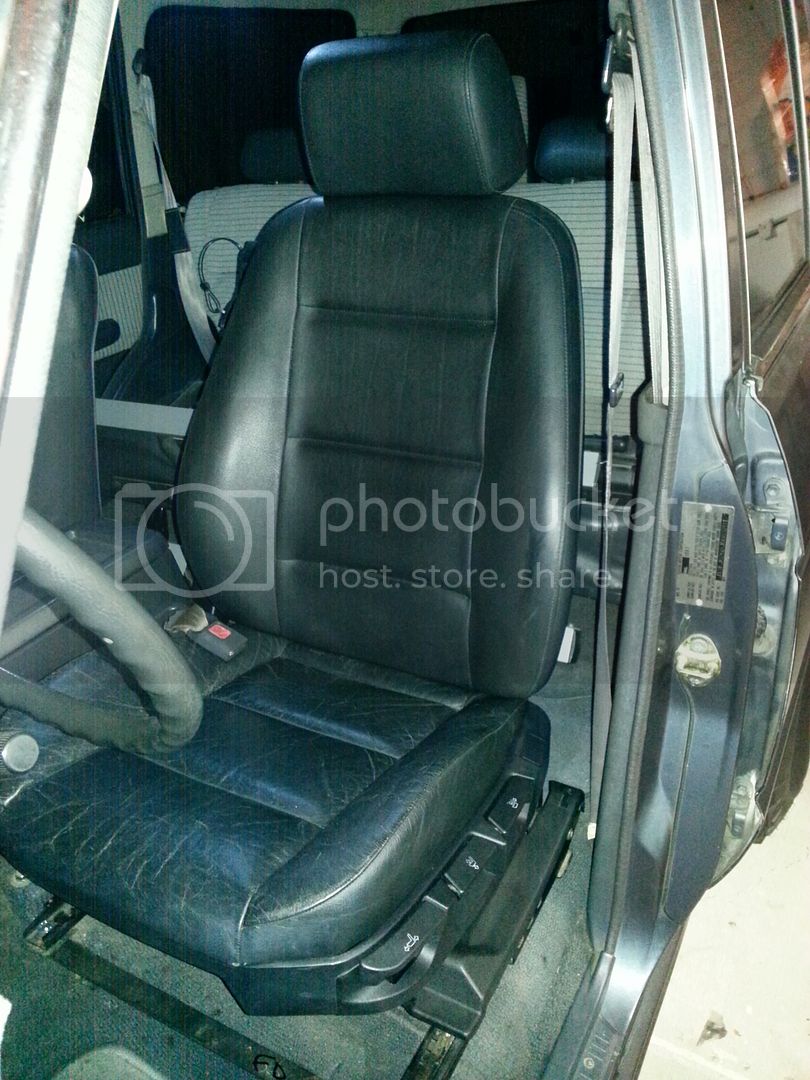

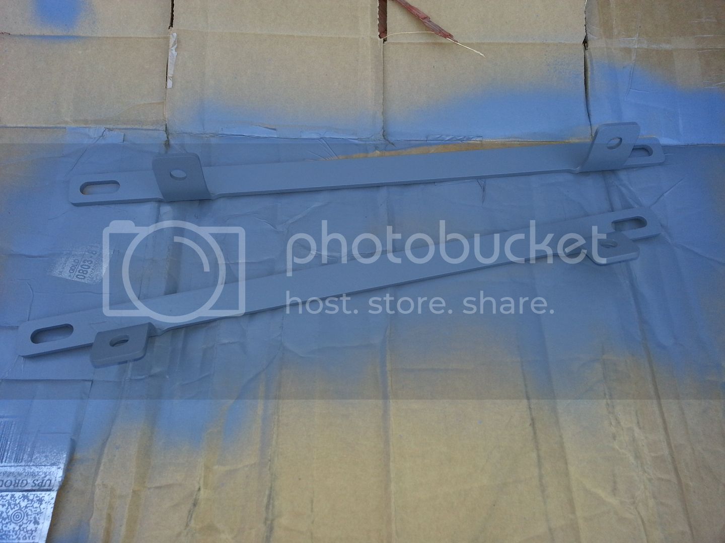

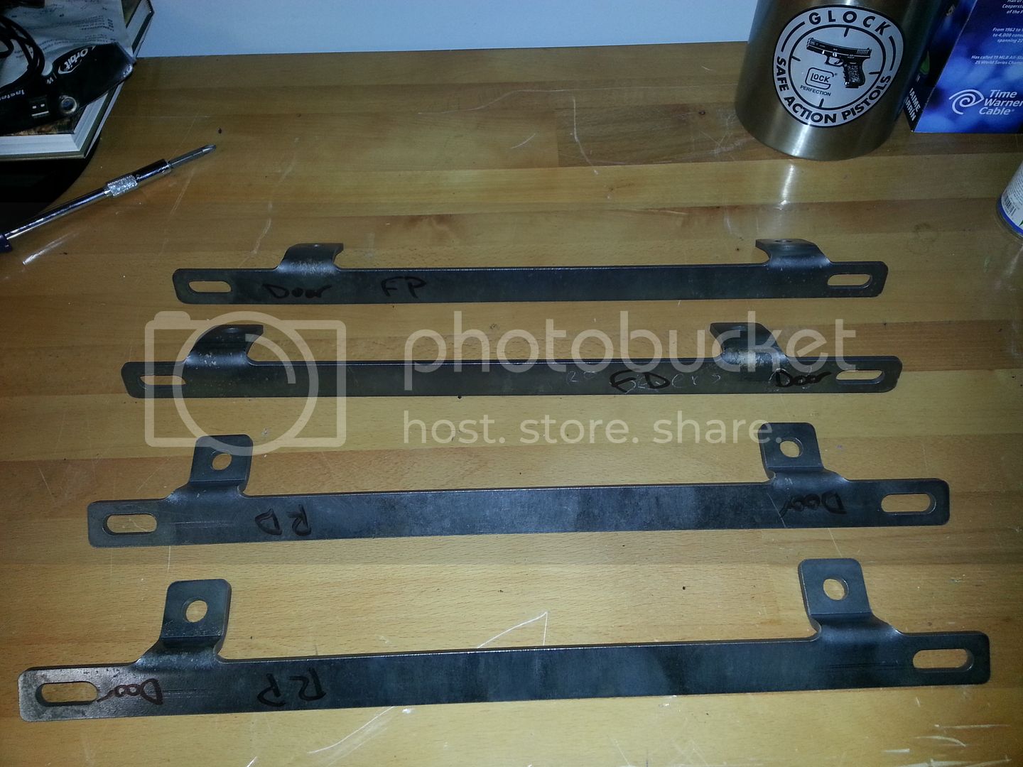

Well i took TorFab up on their offer. I got the backets thursday. These things are nice, and going to be installed on my 1988 FJ62. Made from 3/16 steel, precision bends, and very cleanly cut. Last night I installed the drivers side and mocked the seat on there to check fitment. The brackets are spot on. The only thing that you need to purchase is the bolts to bolt the seats to the brackets (a quick trip to HD took care of that). Found some class 10.9 bolts to keep everything metric.
Before removing my seats it appeared that the brackets were off. Pulled the carpet up and voila... another threaded hole under the carpet. The hole on the right was where the original seat was bolted up to. (need to vacuum it!)
The brackets came marked FD/RD (front driver/rear driver) FP/RP (front passenger/rear passenger) and "Door" telling you that that side goes toward the door. Very self explanatory.
Some Primer (these are the passenger side)
Some Paint. I might end up blasting and powder coating the brackets just because. We'll see.
The seats are off of a 1997 BMW 318 All manual adjustments.
